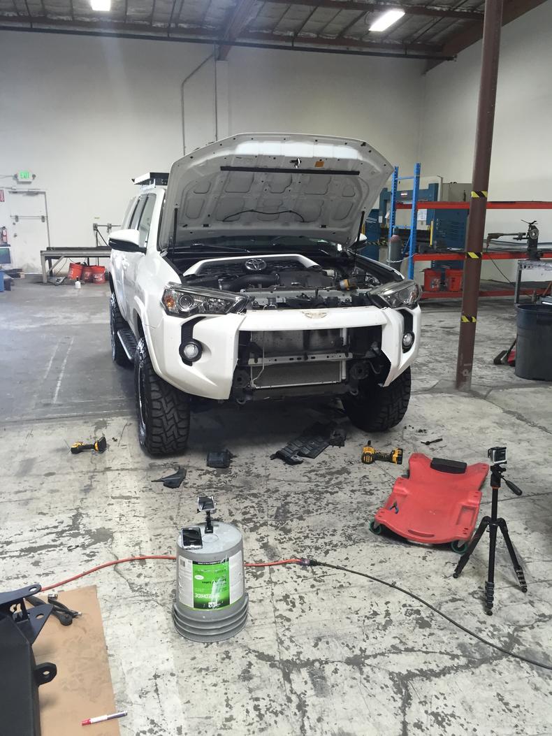

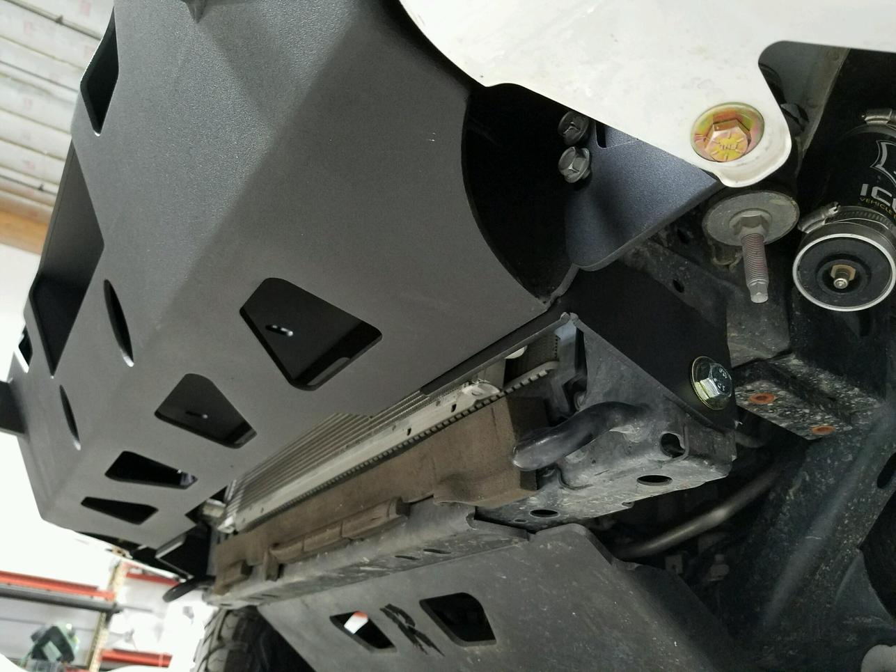

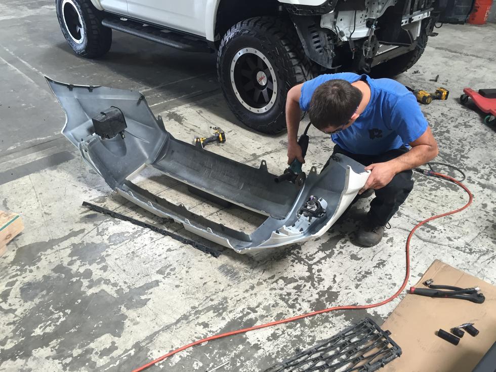

I don't have a ton of pics, but [MENTION=82791]Relentless[/MENTION] or [MENTION=143851]Black_Sheep[/MENTION] should have instructions or a video soon.
Install consisted of removing the plastic front bumper, Removing the crash bar, cutting along the lines in the center, reattaching the front bumper, and bolting in the new bumper. Took Eric about 45 min so should average around an hour for people who are taking it on for the first time.

Thank you. Those pics help a lot. I couldn't really tell from the other pics if the aluminum bar was removed.

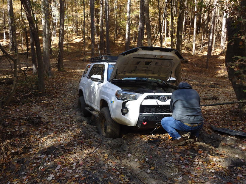

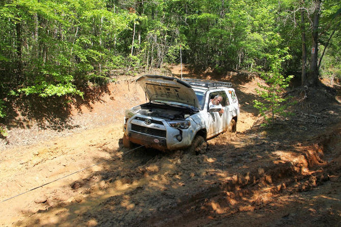

You have to squat just about as low to get into the lower grill. I'm not gigging on you and it's your ride. I'll just pop the hood old school like I always have and reach in from the top. It just seems like you're trying to address a problem that isn't there with a solution that may break or not hold itself closed. It's your ride and you can do with it as you please. I was just asking a question and making an observation. And I'll stop now. I just thought the builder was pretty thoughtful for adding those openings for that specific purpose.
And you do still have to reach down on that muddy trail to get your pristine and clean winch hook and cable out. How do I know? :becky:

So in your first photo imagine reaching up under the bumper, then ask yourself if a hinged lower grill would be appreciated

I think you're confused. You don't have to go under the bumper. Look at the pic head on. There are 2 trapezoidal cutouts on the sides of the winch plate for access. Unless you completely buried your truck, to the point where you would not be able to winch out, you'll have no problems. So that first pic would have no problems with access.

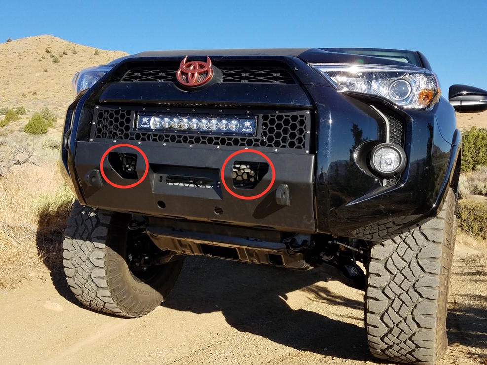

Lol. There is no under. There is through the front and on each side. Maybe 4 - 6" lower than your grill opening. Like I said, I'll stick with opening the hood. You do what you want to :wink2:

Thanks for marking the winch access points, I'm on my phone.
