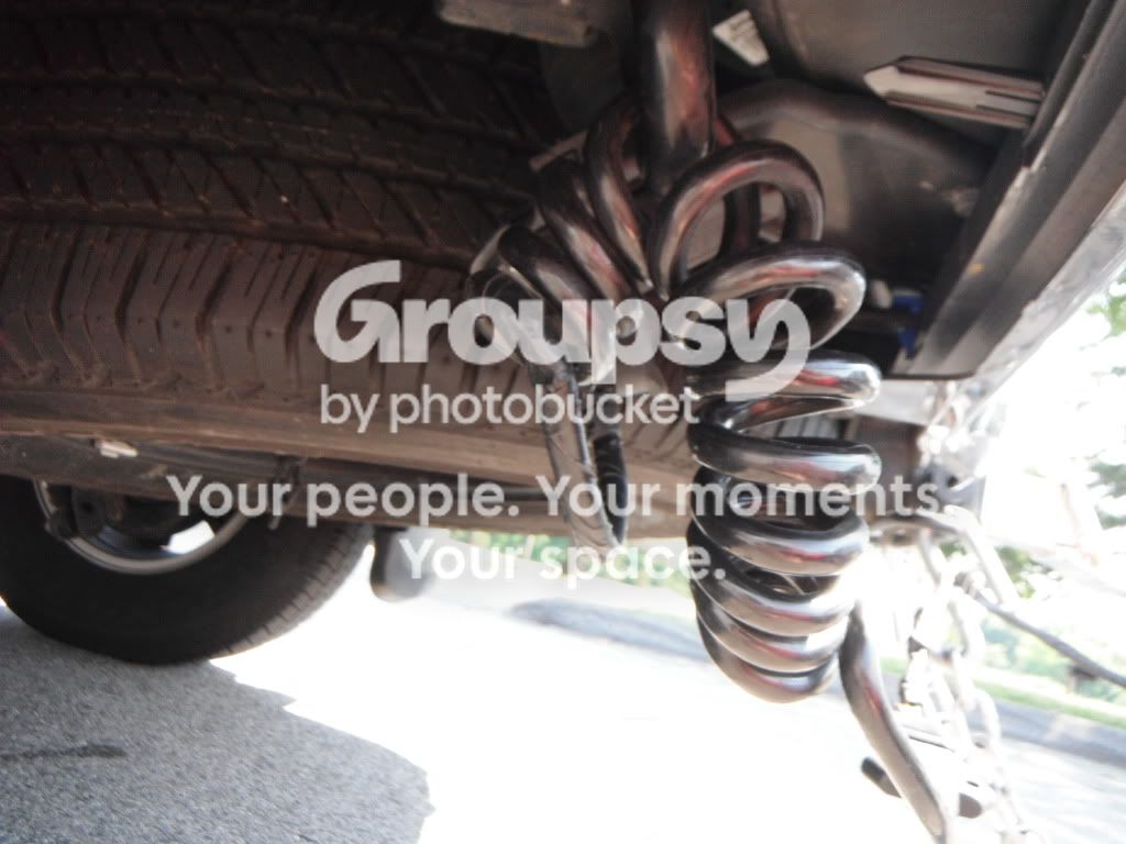

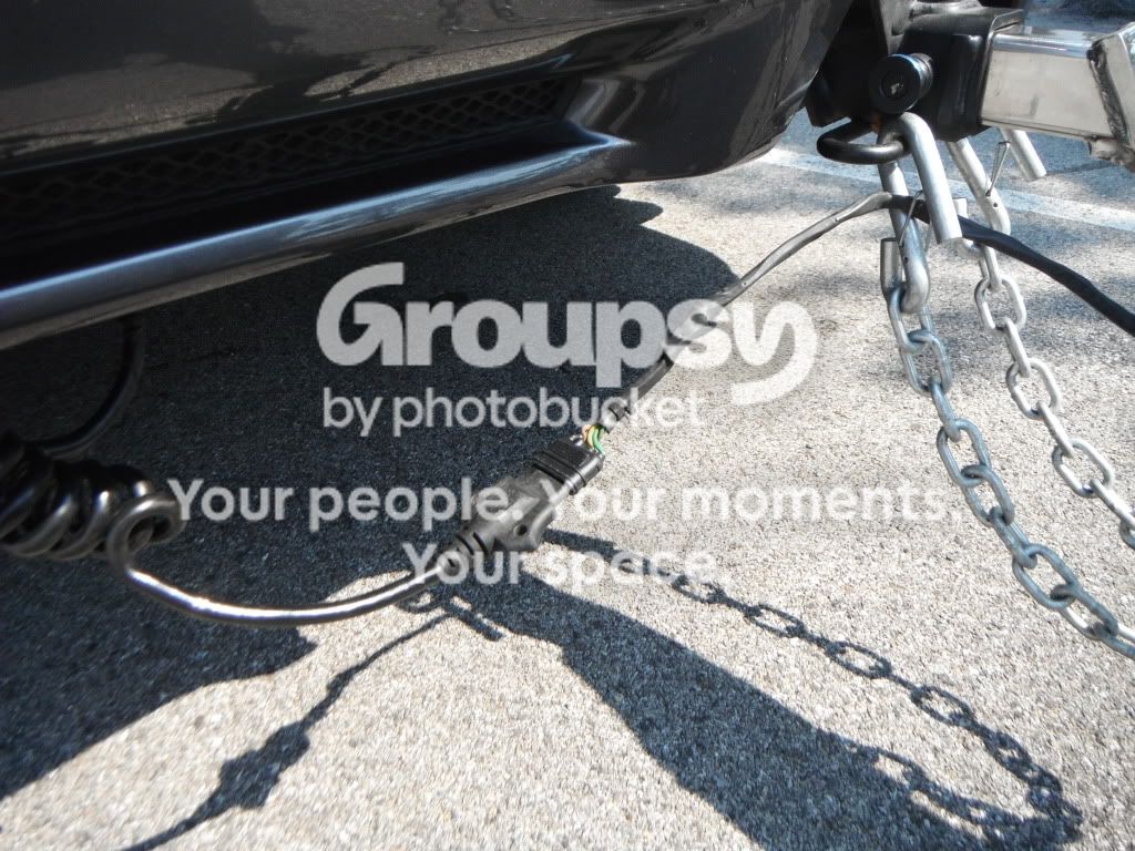

You can get a 7 pin to 4 pin adapter cable at Harbor Freight. That may be long enough to reach easily if you can use a 4 pin connector. You can also get a 4 pin extension cable that's about 5' long.
Yup. That's basically what I do. I have an adaptor that's coiled and stretches. After plugging it into the outlet I run it through the rear recovery hoop. Keeps everything off the ground and works perfectly.

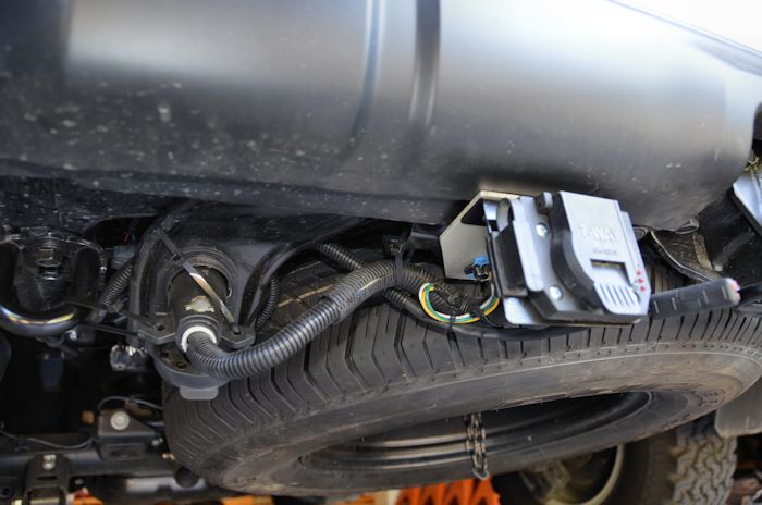

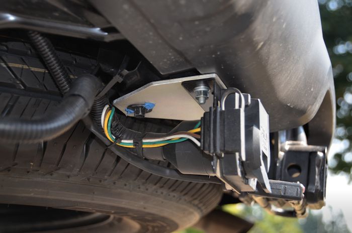

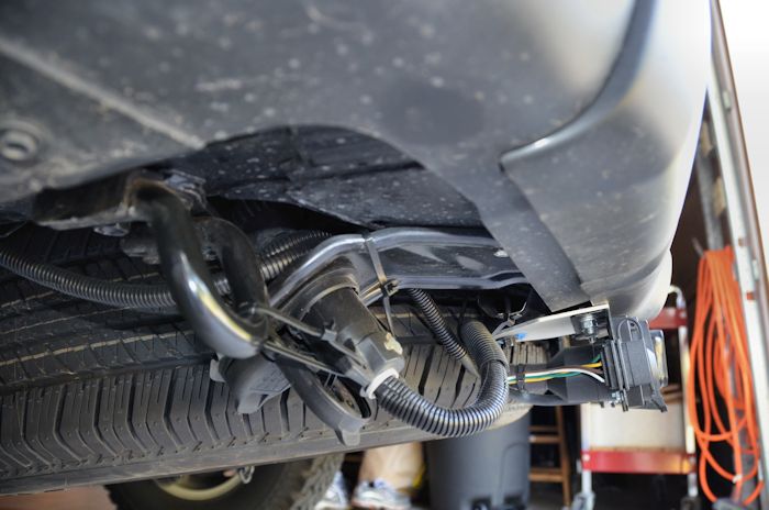

Yeah - some people actually want to turn right when towing! Using the factory connector plug, I could only turn left, otherwise the cable would pull out. Started getting real dizzy. Plus, it's a pain to reach under the rear of the vehicle every time to plug / unplug the cable - you'll understand when you're old and have bad knees.
Anyhow, the only 7-pin extension cable I could find was for 5th-wheelers and was way too long, and I really didn't want a 5 foot slinky hanging under the rear of the vehicle. So, I took the 7-pin connector left over from the former tow vehicle, got a new trailer-end plug, and made an extension pigtail. Now I have the 7-pin, plus the 4-pin, plus a place to mount the 2-conductor connector for the rear-view camera on the back of the trailer, plus a bunch of fancy high-tech flashing red LEDs. Maybe lost a little bit of departure angle, but not too bad. The mount is just a piece of flat stock with 3 holes in it - doesn't get much simpler than that - and a couple of dabs of RTV on the bolt head to keep it from working loose. The heads of the 1/4" bolts snug up against the front edge of the bumper plastic, so it doesn't twist even though it's only mounted using the single bumper cover bolt. There's not too much load on it anyhow. It's semi-permanently mounted to the factory connector using a few wire-ties.
The pieces of slit black nylon tubing work nicely to keep the safety chains from chipping the paint off the hitch and allowing rust to get started. The hose clamps keep the chain hooks positioned on the tubing. Looks kind of dumb, but it works - and it looks better than rust.

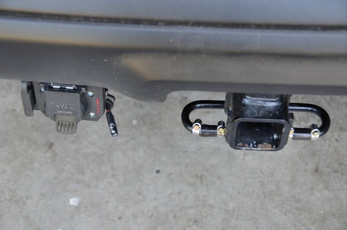

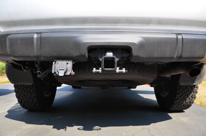

^can you post a pic of the back of your truck? I currently have mine attached to the bottom of my hitch with steel zip ties, but it bottoms out and rips off quite often when we are wheeling.
The first shot is taken at hitch-level, and shows that the connector plug hangs just below the bottom of the receiver. The second shot shows a detail of the brilliantly engineered and exquisitely machined bracket.

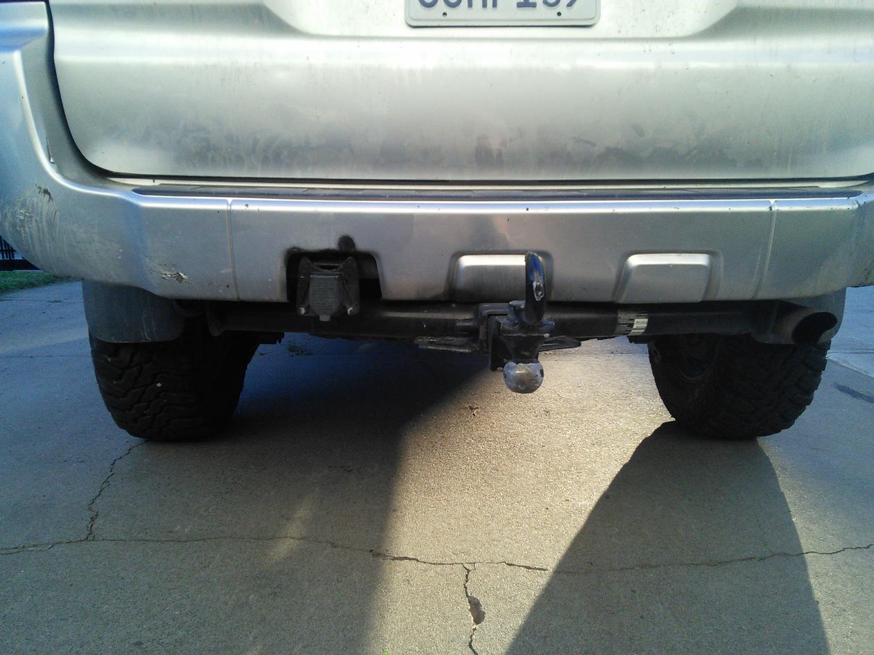

This just another option, doubt some will do as picture will show why.
I tend to pull a heavy duty trailer and do some extreme off roadding so had to keep changing locations. First it was mounted on the tow hitch frame, not rock ready location. Then decided need to relocate, works for know until we modify for off road bumper.

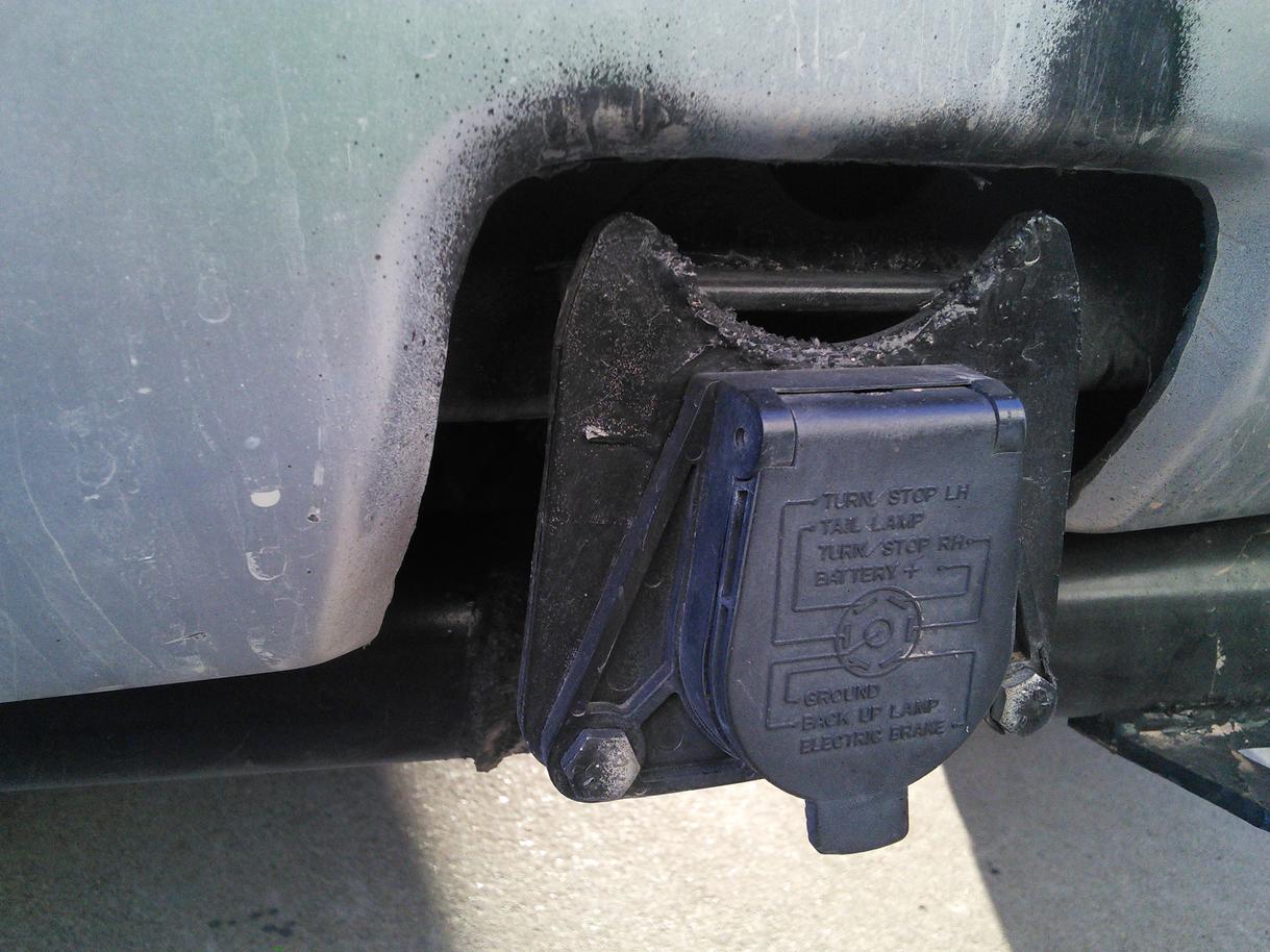

I need one of these. Where did you buy this Antman?
That doggone plug is nicely hidden by Toyota, but too bad you have to practically stand on your head to use and make sure you have completely plugged in.
Sorry! That plug is probably 15 years old and has been on 6 different vehicles! My Father bought it and I have no idea where...
