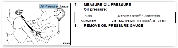

Also, is there a location to add an oil pressure sender on our 3.4l? I have a 1996 and have been thinking about adding some gauges
I relocated the filter to the driver side frame rail. There is a lot of room for a big filter there: I use a M1-301.
If you want an oil pressure gauge, the stock sender is right by the oil filter. You could tee off there or use a remote mount with a sender port.
