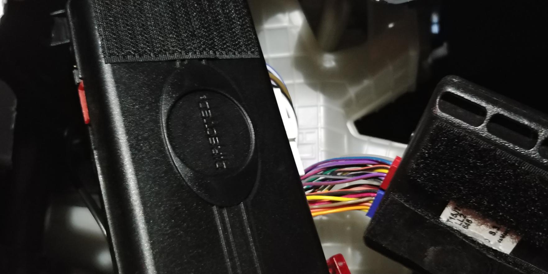

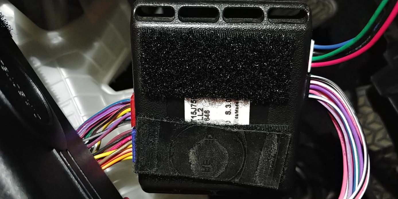

I've had my 4runner for a month and I was getting ready to do independent fog light Mod
I notice this module under the dash did some research and it's for remote start/alarm.
But the trouble I have is knowing how to make it work or what do I need to make it work, when I bought it I was only given one key.
Should I give the dealer a call? Help please...

Press lock 3 times with the OEM remote and the doors shut. Depends on what remote starter it is (larger box). Directed is the brand but need the model number. Is there an antenna on the windshield?
I tried pressing 3 times but it didn't work
Not sure about the model
There is an antenna it has hx plus logo
Would help if you had a model number on the brain to determine what remote you need. Does the antennna say HX Plus or just HX?
The smaller box is a DBALL which integrates immobilizer and keyless functions.
The module is a Directed 4x05
And yes the antenna says HX Plus
