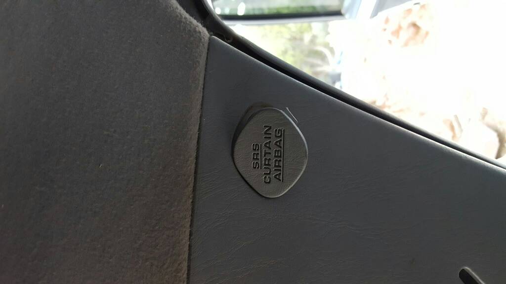

Has anyone removed the rear cargo area plastic interior pieces? I'm particularly interested in figuring it how to to remove the upper piece that has the air bag symbol on it. I was able to remove the lower piece but wanted to be sure of what I was doing before I break important tabs and such. Plus, the air bag deal makes me extra cautious. If there's a link with pics, let me know.

Not 100% sure on removing them but don't worry about the airbag labels. The airbags are curtains and deploy from the crack between the headliner and the side pillars, they're not just clustered behind that one little "airbag" logo.

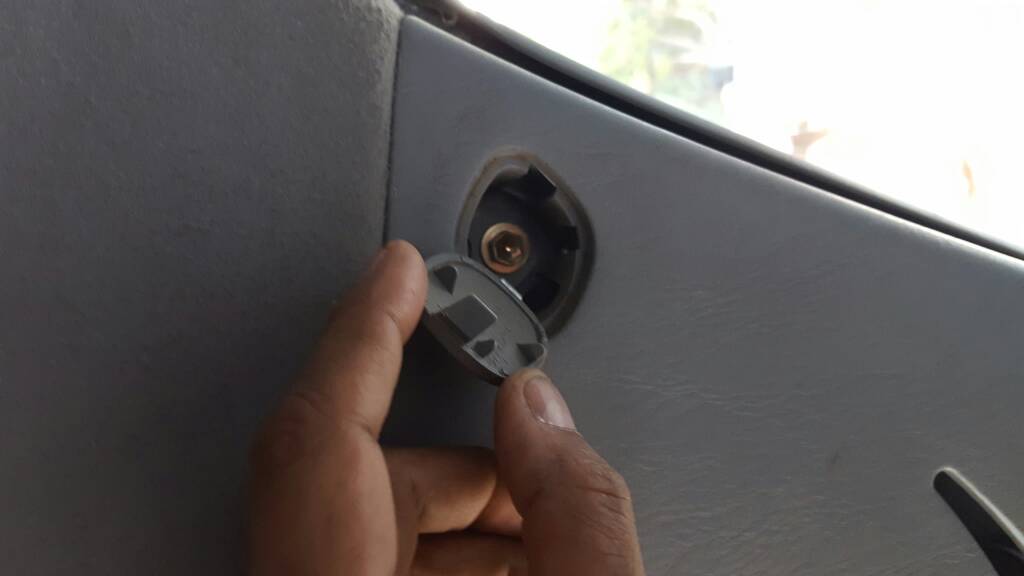

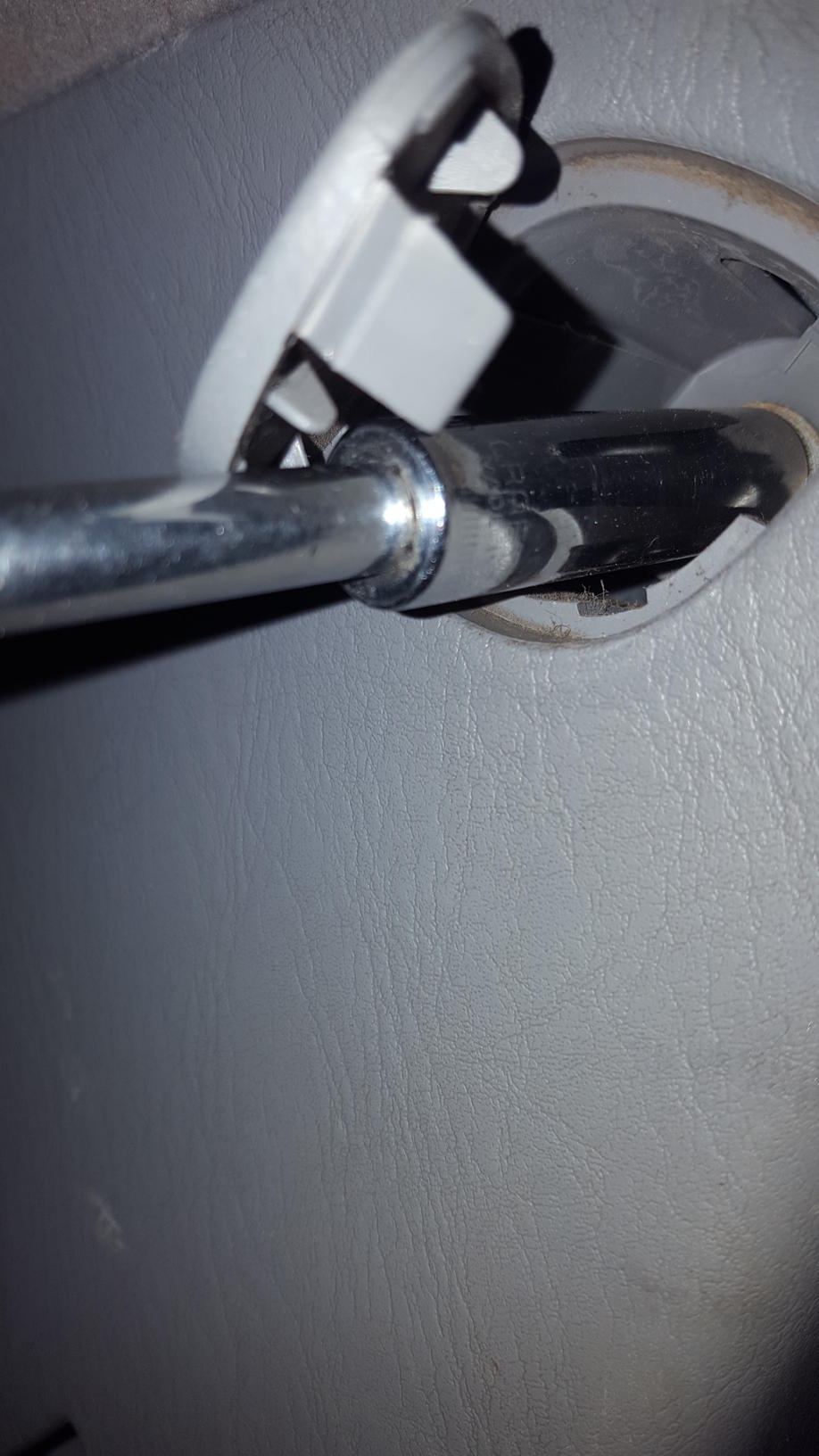

Thanks, I figured it out. That logo has a 10mm bolt behind it and then the top panel can be removed.

Is all you have to do is remove that bolt and pull?
That's basically how it works on the A-Pillar, except there are two bolts (one on each end of the grab handle) so I assume its the same on the back

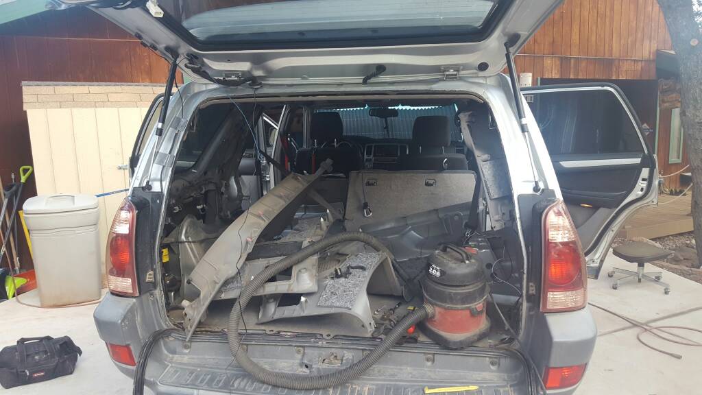

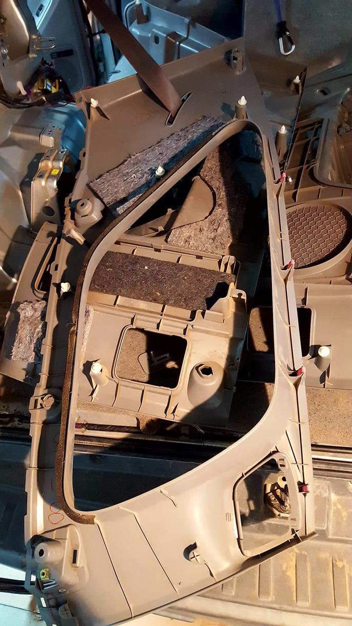

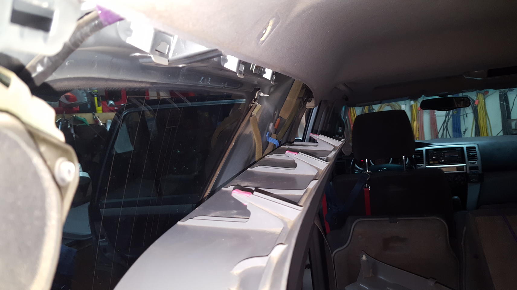

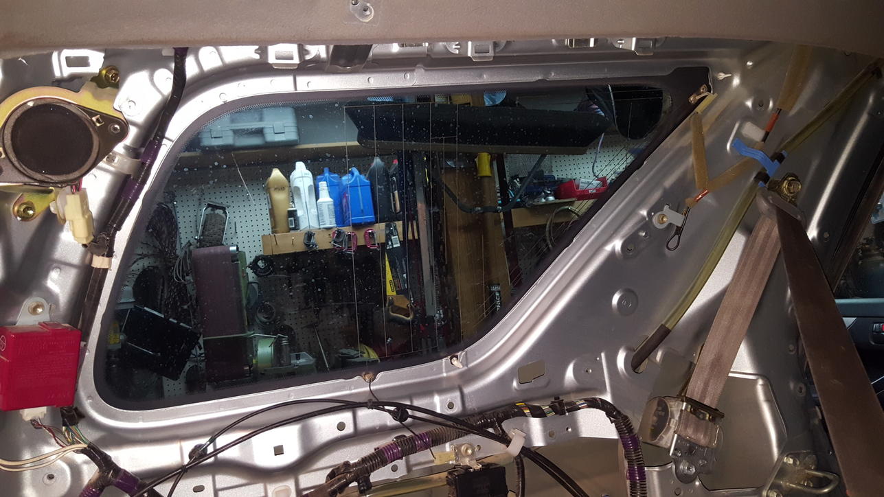

Some more pics so that everyone can see where all the snap pieces and bolts are for the top trim panel. I must admit, I didn't see any SRS air bag deal behind the log or anywhere in the vicinity :ohwell:

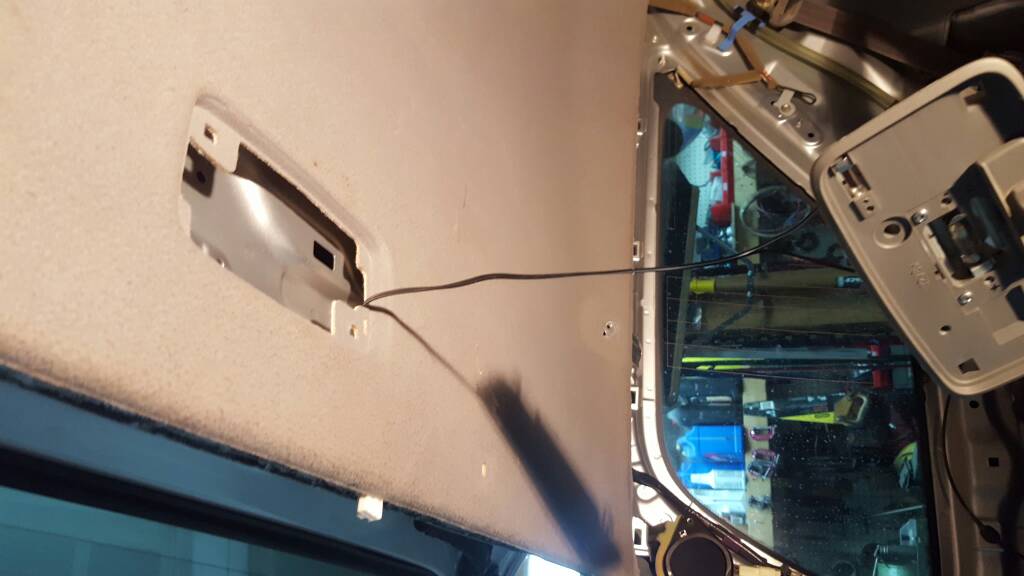

My main reason for doing all this work was to drop the headliner enough so that I can wire in couple of wires to the cargo dome light. I found two dead mice babies and poop up there. So while all the trim pieces were off, lots of cleaning and vacuuming ensued as you can imagine.
The top part of the panel simply slides into the rectangular holes located in the body. The bottom part is where the snaps and bolts are.

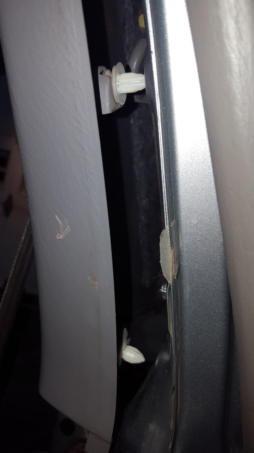

You see how one of the white snaps is missing? Look toward the front of the vehicle and you'll see it. It's still attached to the body so be sure to check for the presence of all the plastic snaps before reassembling the interior panels. They're easy to remove from the body and reattach to the trim piece before the reinstall.
Be sure to reattach the white snaps back onto the trim panel. This is where the driver rear passenger seat belt resides.
The bolt behind the SRS air bag logo piece.

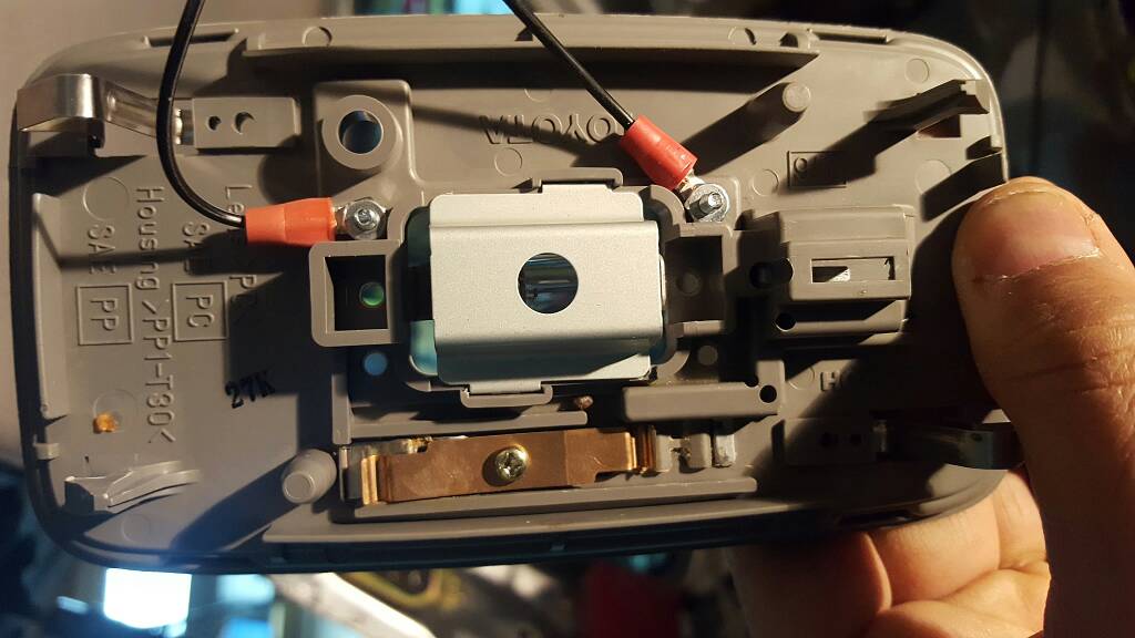

Just out of curiosity, why are you removing the interior?
I'm installing additional led light strip on the tailgate for camping purposes and needed to access the dome light.

Sorry to necromance this thread, but what is that red box? Is that the door control receiver? I noticed it says ABS on it- does it have anything to do with the Anti-lock brake system or does that stand for something else? I can't imagine an ABS module would be paired into the Door controller receiver.
