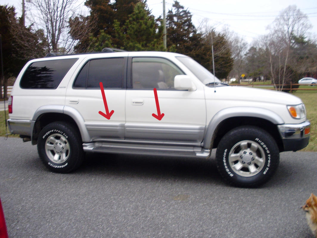

Hello, I'm new to the board. I have a 1997 4runner and after a little fender bender that the vehicle had I think I want to remove the fender flares. My goal is to remove the fender flares and stock running boards and put on aftermarket sliders and flares after I lift.
My question to the forum is the portion of the flare that is attached to the door and the separate mold piece attached to the driver/pass front on there with adhesive or with clips. I don't want to remove them only to find holes in the door. I know the flares will have holes and that's fine since I will replace them but I don't want holes in the doors from removing the door molding pieces.

Read the tutorial and documentation thread. 2nd or 3rd to last page. There is a link to the thread on how to remove and install flares.
After reading your post further ...
1) you don't want to remove the flares permanently because there will be 4-6 holes in each panel, including doors. Not wanting the holes will not help LoL they will be there either way because they already exist.
2) aftermarket kits ... Bushwhacker ? Are hardly better than the Limited flares.
Yes the running panels kind of suck on the doors but they do no harm.
You can install any lift, bumper sliders etc and keep the limited flares setup.
Just read my thread, linked below, for lots of pics as an example.

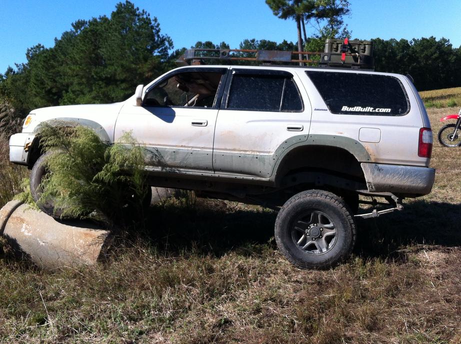

Look in my build thread that [MENTION=82211]TCMach[/MENTION] posted earlier. You an tape them off and paint them on the truck. That's what I did at first, then removed them all together.
