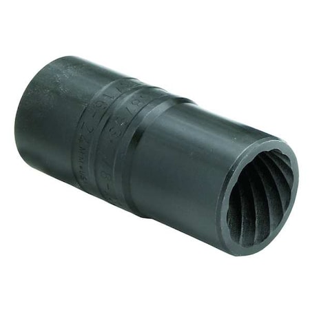

There are tools like this on the market that might work.
https://www.amazon.com/Performance-Tool-M980-Emergency-Removal/dp/B000FTN3KK
https://www.youtube.com/watch?v=mJUUyjJqk5A
Remember to have tools to get the lug out of the socket because you just pounded it on there pretty good.
In an emergency I've used an impact socket that was close, and beat it on with a hammer and was able to get that to work

My truck came with locking lug nuts and the 'key' got lost between when I got it and when I wanted to put 17" wheels on. I borrowed a bolt extractor of the style pictured in the posts above from a professional mechanic friend and pulled all four off in about ten minutes. Locking lug nuts *never* work properly and all they do is annoy legitimate users.

I use a cheep 12pt socket and hammer it on. But like posted any stripped bolt extractor socket will work out in the field.
cheap and easy
just buy a 12 point socket that is 1 size smaller than the nuts, hammer it on and then just use a socket wrench or bar to remove it. i stripped my lock nut key and this is how i removed my lock nuts. cheap and easy, i think i spent $10 max.
