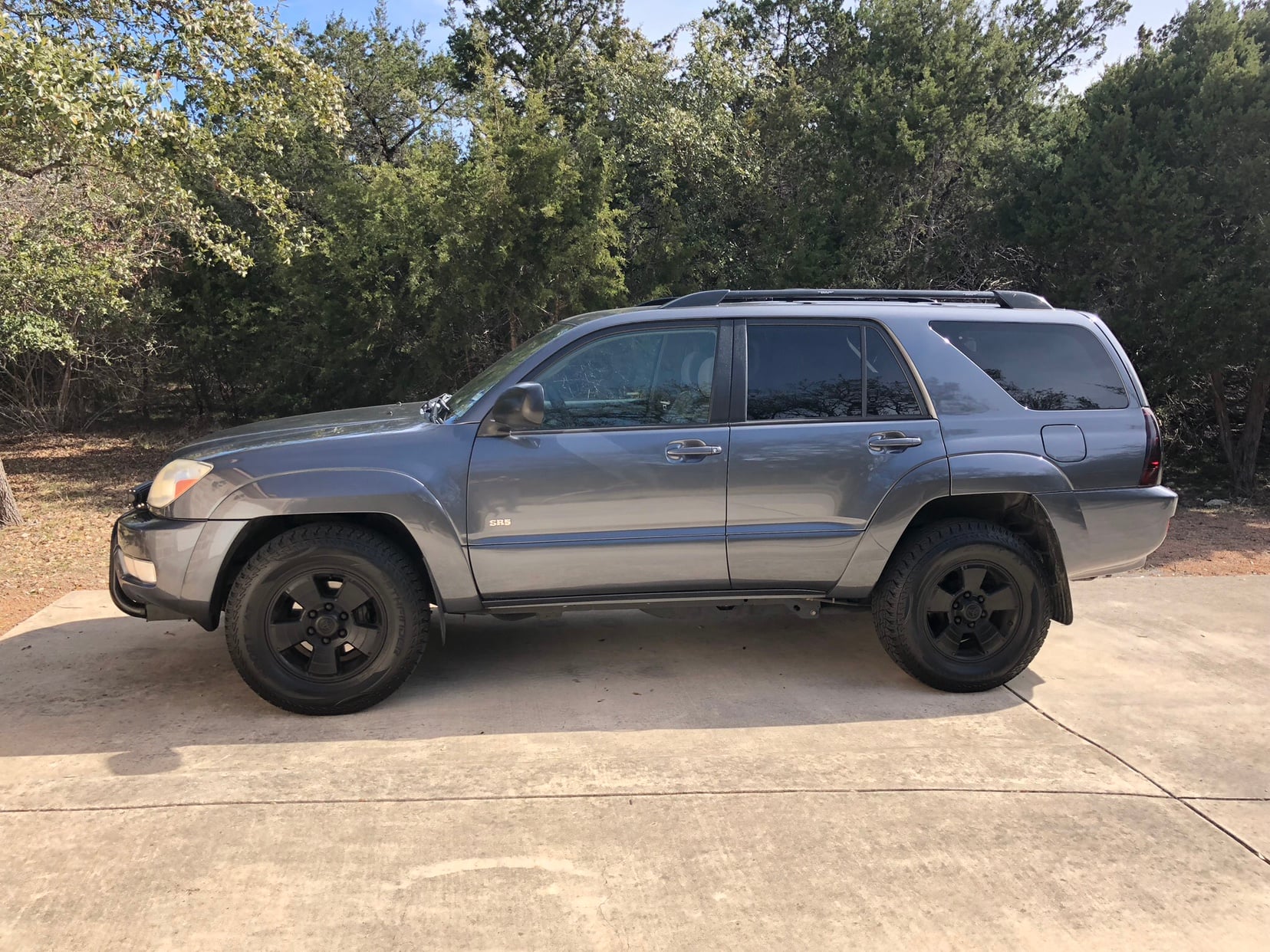

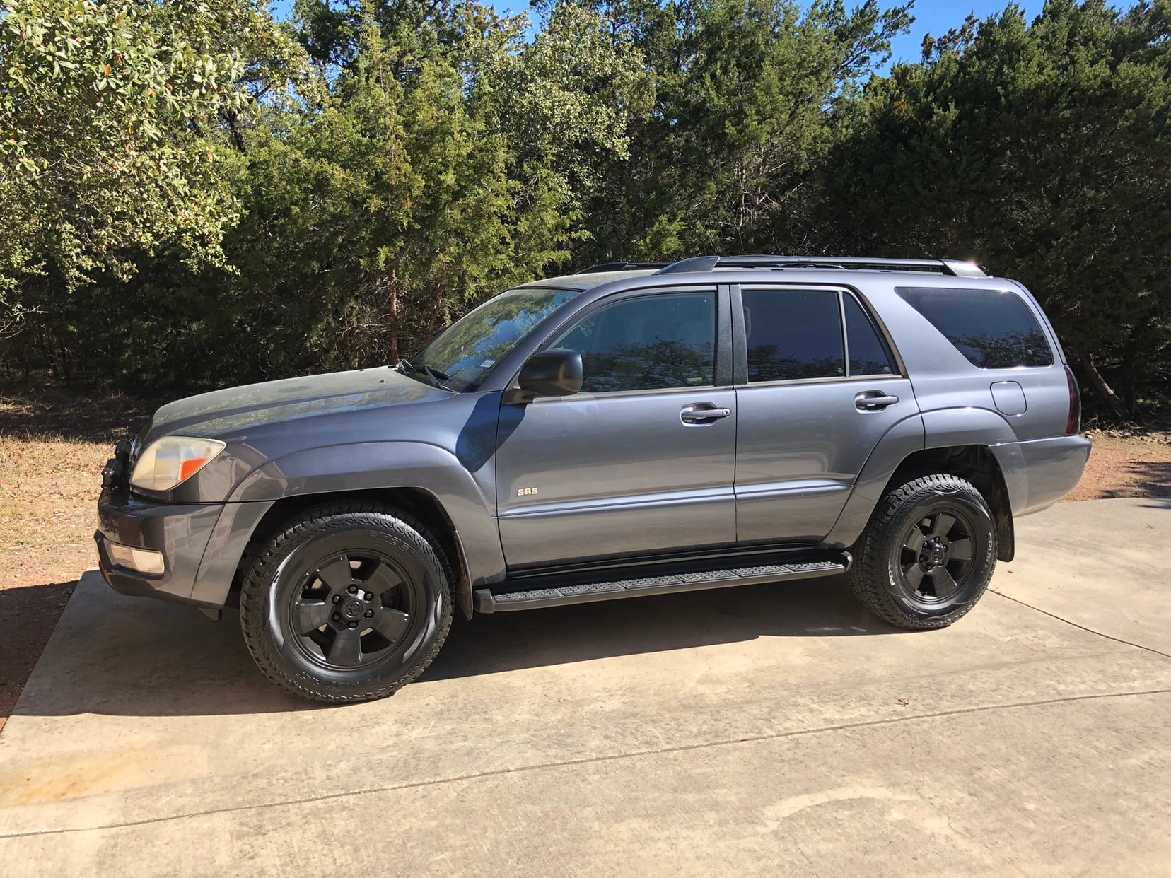

Removing running boards on 04
It does change the look of it for sure but if you’re looking for a big difference go with a leveling kit. Installing mine this weekend.
Pulled mine off in about 10 minutes today. did it blind since the ground was wet. 12mil socket on an electric driver, 6 bolts per side on my 08 SR5.

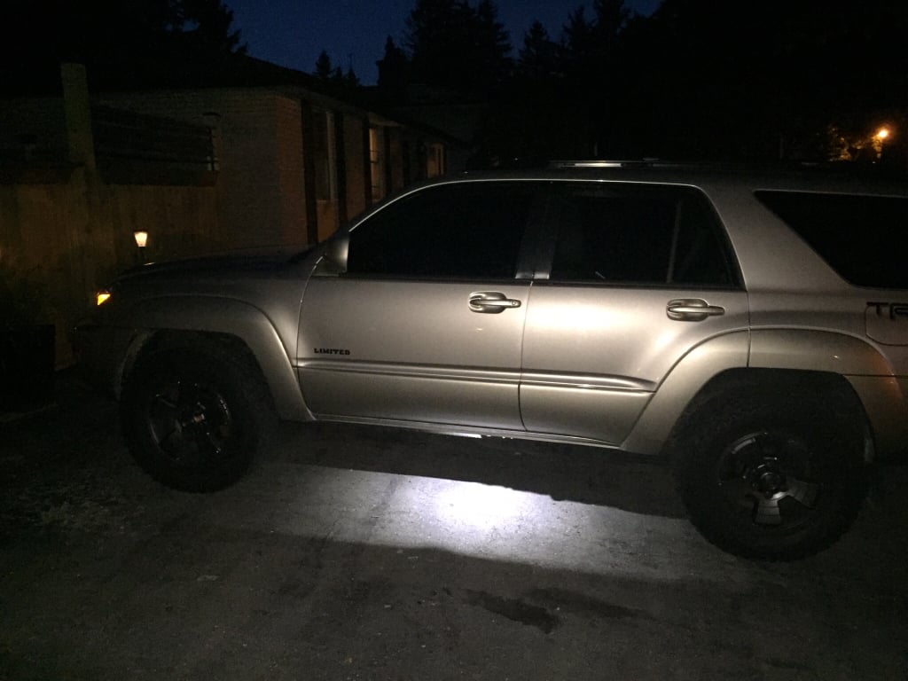

Remove them, cut, and cap the wire. Should have no issues if you seal up the end and tuck it away in the frame hole it comes from.
I decided to use the wire and install Rock Lights on either side.
Lights up the whole ground when you walk up and unlock the truck. Even retains the Dimming ON/OFF feature.

I did this using one of the middle holes that were used for the running boards. I used theses : https://www.amazon.com/gp/product/B00IY3YLCI/ref=ppx_yo_dt_b_asin_title_o03_s00?ie=UTF8&psc=1
They came with some bolts and mounting hardware and nothing else needed to be purchased if you have some electrical tape and zip ties. Play with the mounting till you get them positioned correctly. Took 45 minutes to get them installed. Torque all the bolts on the face of the lights before you install them to keep em watertight; a lot of mine were loose. So far they have been running fine and a nice touch for $14. Remember that the stock wiring will only be there if you had light up running boards. Pm me if you want some pics of how I mounted them
