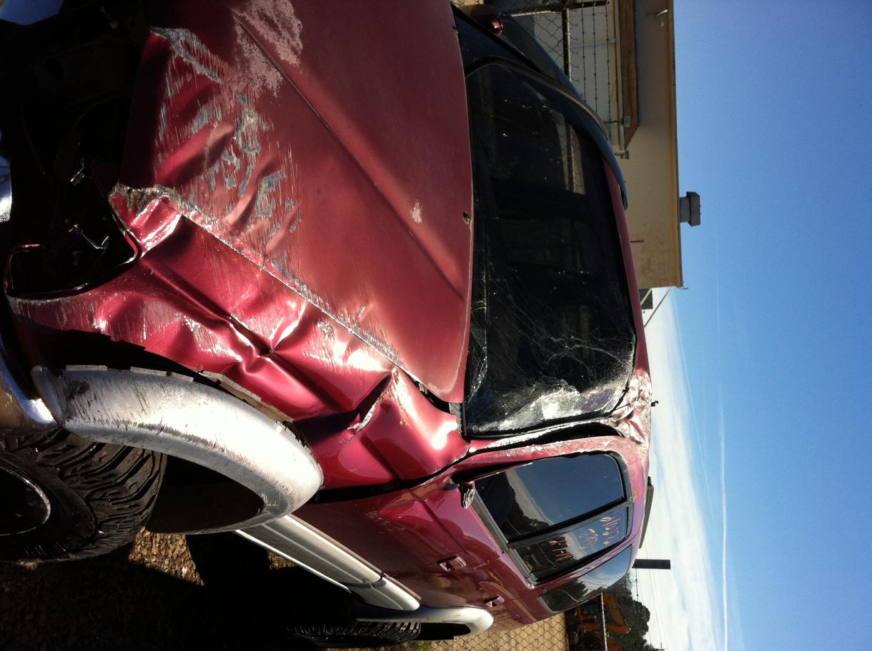

Got tacked when needed, same will happen to 01.
