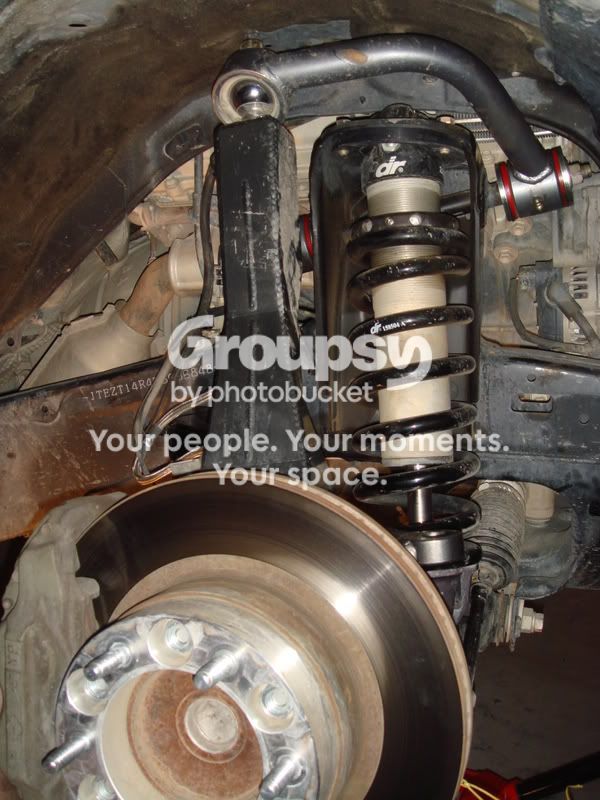

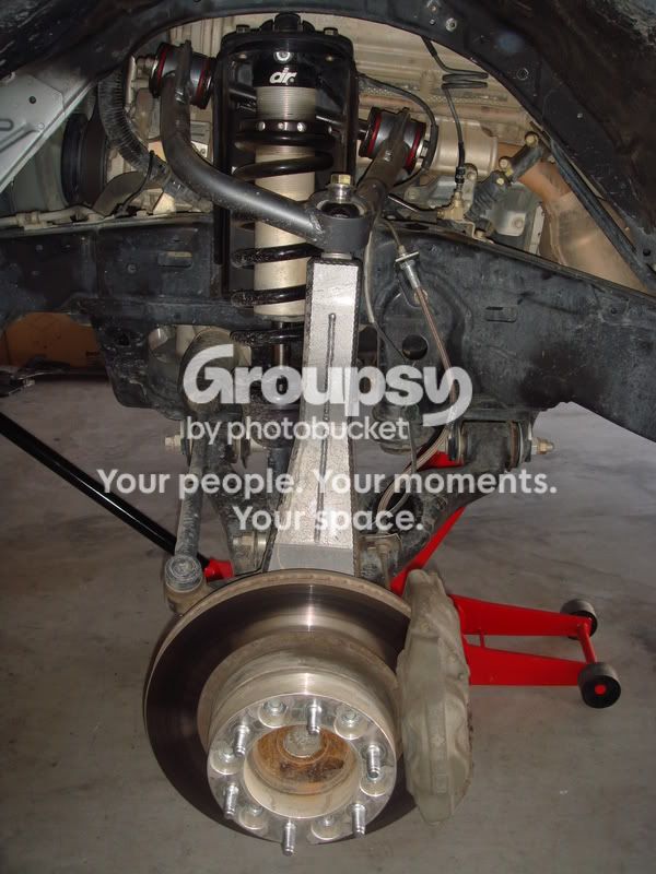

yeah, thanks for that. sway bar has been happily removed for a while now. defiantley superior handling charecteristics offraod and dont even notice on road anymore. but i only suggest removal of front sway bar. And only if your maxing out range of travel.
Up travel
DSC00720.jpg~original
Down travel
DSC00711-1.jpg~original
not possibly with sway bar attached

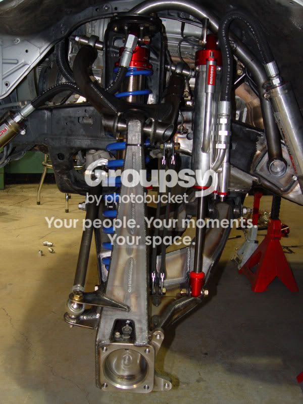

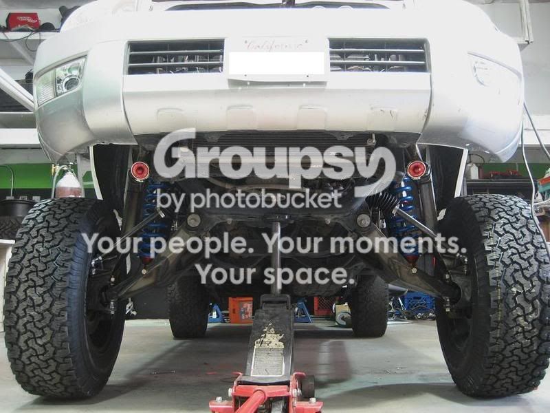

Hmm, well to be honest I dont know! I im just dying for a new mod and thought this might be the direction to go... Itd be interesting to know the diameter of the fjx rear sway...
Hey Bala de Plata,
What kind of lift/tire/rim combo are you running? Looks good from the little pix that are posted. If you could get more pix from all angles and list what you have done, that would be awesome. I want to mod out my 4R and want to see everyone's setup so I can make an informed decision.
Keep up the great work!!
