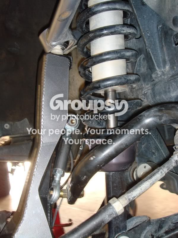

Spoke with Allied the makers of the lift spindle. There production set of spindles will have an attachment point for the sway bar AND it will convert from the stock ball joint connection to a heim joint connection. Things just keep getting better!!

Wow, where do I begin... First off, the guy who designed and made the new front lift spindles (Allied Motor-sports), went to Cal Poly Tech to study engineering. Also, the guys at Donahoe have a engineer on staff. I have met people and owners at both companies. And not to bag on Toyota tech's, as there are many good ones. Having a toyota certification is not that big of a deal. I am not sure why you have this opinion, except that you open your yap without any real knowledge or experience. And seeing that your barely 20, you got some s**t to learn my friend. So instead of throwing your useless opinions around, open your eyes and ears and just maybe you will learn something that is valuable and maybe save your own life one day!!
And just for the record, my sway bar is back on and thanks to a little engineering it has better geometry and will last longer with a lot more abuse than the original "toyota" design.
heimjoint1.jpg~original
