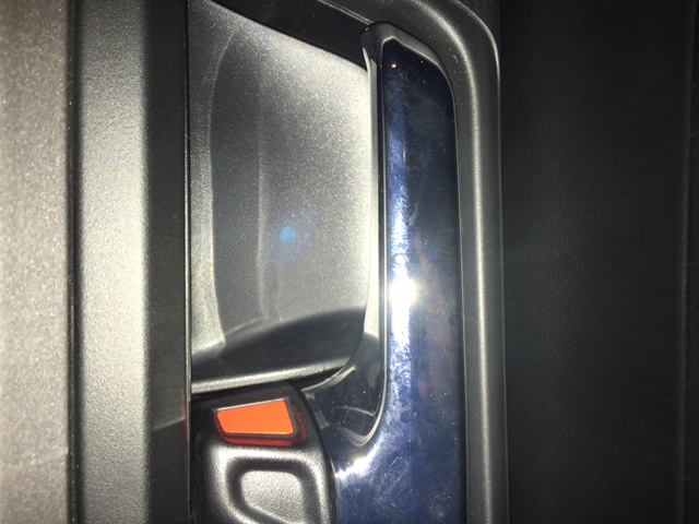

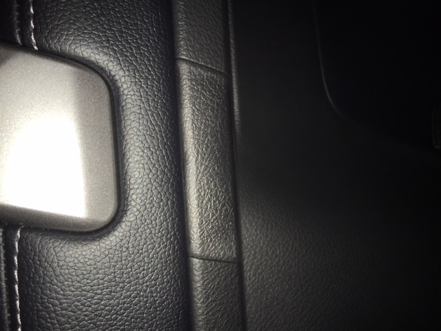

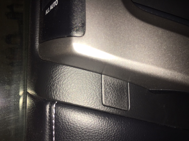

These are the three covers that need removed, one behind the door handle, and the other two are out in the middle of the door. There are screws under there to remove. Sorry, not sure why they are sideways.
As for the tools, something like this:
https://www.amazon.com/Tresalto-Aut...8658491&sr=1-8&keywords=trim+removal+tool+set
That has everything necessary to pop those covers off (and not destroy them in the process like a screwdriver would) and then pry the door panel off. There are a series of clips around the perimeter that need loosened (using the prybar style) and then kind of lift up and back toward you to remove the panel.
