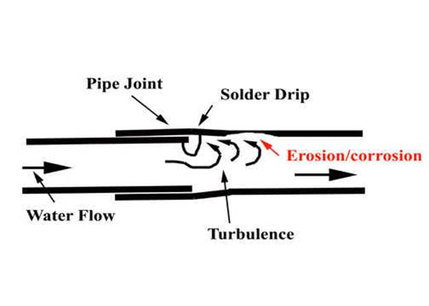

One question: Do you have a recirculation pump for your water heater? (Instant hot water all over the house). We see more leaks on houses that have a copper pipes and a recirc pump. It's caused by turbulence at or near a fitting. If you have a pump that runs 24/7...that's a hell of a lot more than the 20 minutes or so it would normally run in a day, when faucets are running.
The drawing shows it caused by a sloppy solder joint. It can also be caused by not reaming the copper after it's cut. The cutter leaves a "lip" inside the pipe. That should be removed.

I'm a plumber. You can get the pipe repaired. It happens all the time. I did it just a few days ago.
Another plumber here. Great answer like your diagram.
