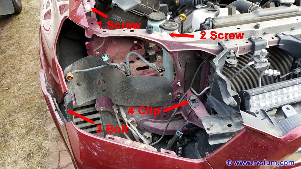

10. There are two screws one bolt and one hook holding the lamp. It is easier to show all of them after the lamp was removed. Screw (1) is hidden under the weather seal and plastic trim on the fender. To get access to it you can lift the trim but I decided to just remove it (see the next step). Screw (2) is easy accessible. Bolt (3) is on the side and was covered by the bumper cover. This is one of the reason you need to peal the bumper cover off, to get access to that bolt. And finally the “hook” (4), it was quite mystery. How to undo it, is in next step.

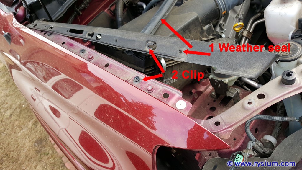

11. Remove the weather seal and trim from the top of the fender to get access to the first screw. First pull up all four clips (1) holding the weather seal to plastic trim. Just squeeze the clip under the seal with long nose pliers and pull each clip up. The back of the weather seal is hooked to plastic trim. Next slide the trim towards the back to unhook all three clips (2).
12. Unscrew both screws and bolt holding the lamp, but do not try to loosen the lamp yet. It can be removed only by swinging it using the clip under the screw (1) as a hinge. The thing that is holding the light is the hook”.

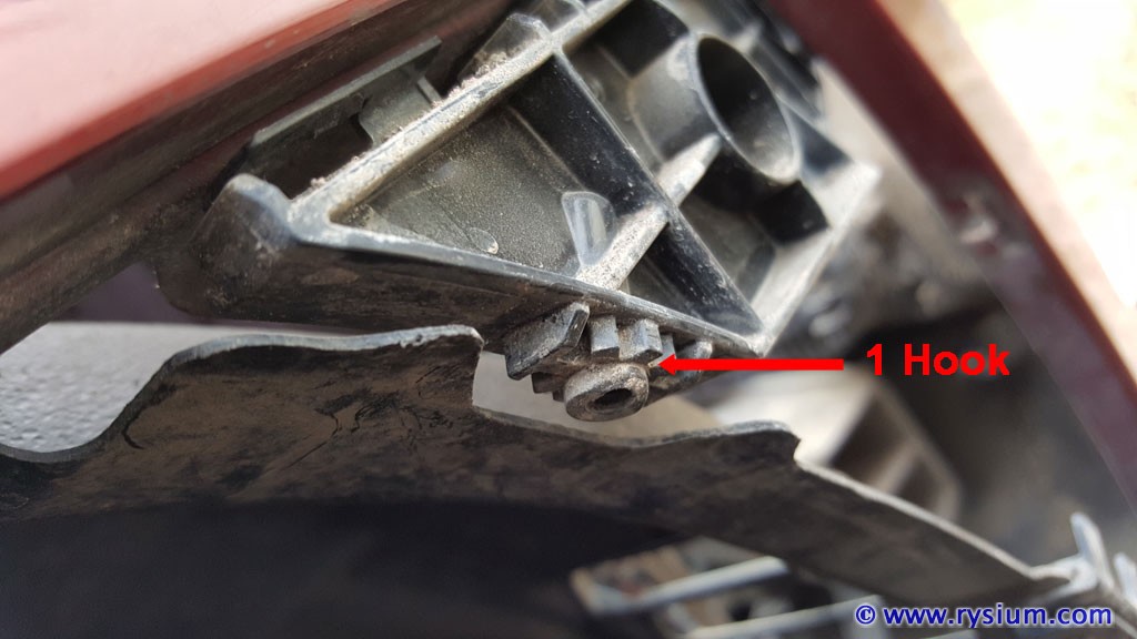

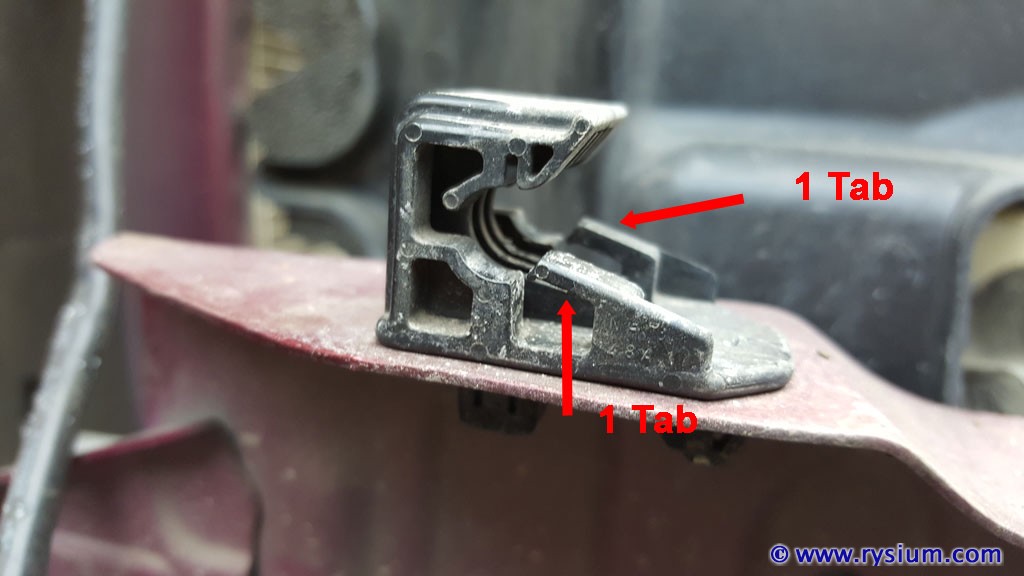

13. Once you see the “hook” it is easy to understand how it clips and how to undo it. Here is the close up picture of the “hook” from the side after the lamp is removed. Notice two tabs (1) that are the responsible for holding the lamp.

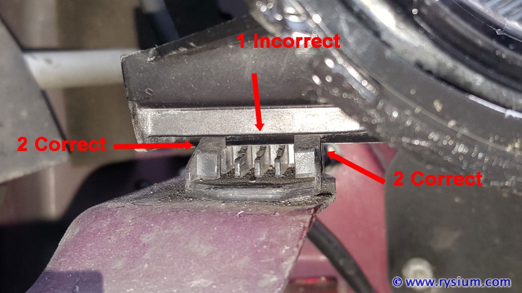

14. There are two ways to undo the hook. The incorrect way (with loud cracking sound) is to push up the part of the lamp between the tabs (1). By doing that some part of the lamp on each side of the screwdriver is lifted up helping unhooking it from tabs while you are pulling the lamp. The correct way (2) is to push down both tabs at the same time with some king of flat screwdriver (the wide one). Then pull the lamp towards the front by swinging it using the clip on the fender as a hinge.

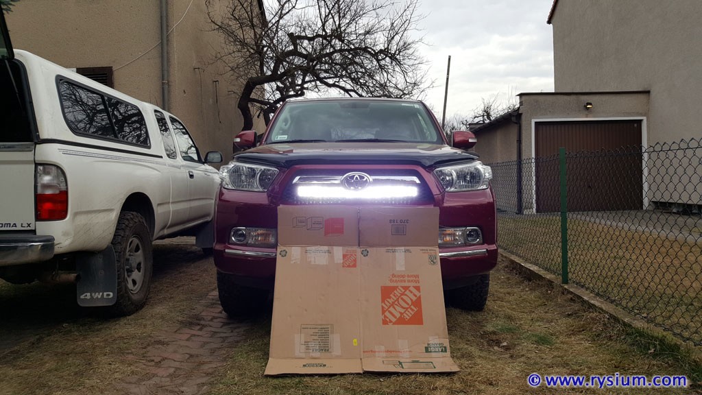

The final result is quite pleasing. 4Runner lost its ugly “scared frog” face and all white headlight looks good.
At night white front markers work actually better than I thought they would. They are even maybe too bright (or not???), but for sure they meet all regulation requirements. And they are pretty too

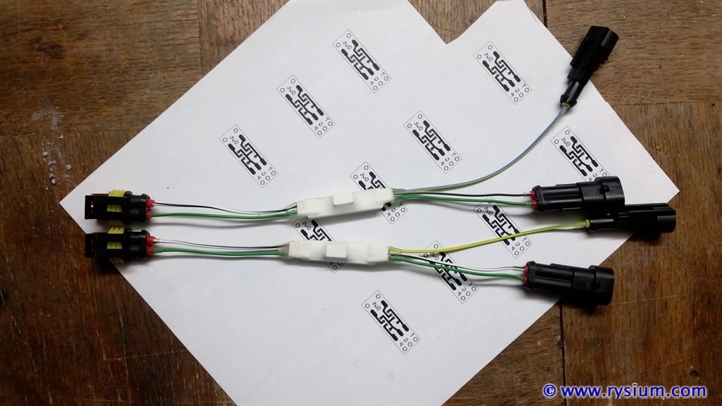

So making this story short (for now) I have made another set of "relay controller" for polarity switchback lights for my 4Runner.
