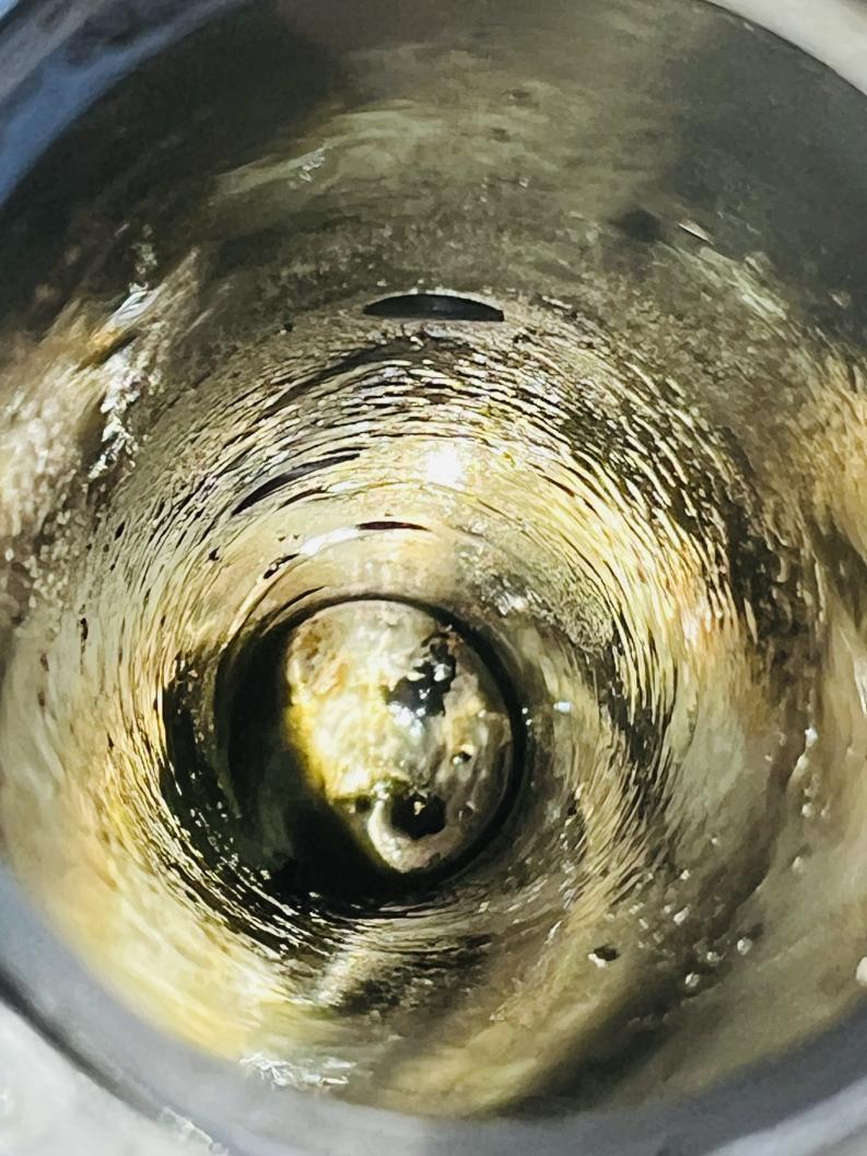

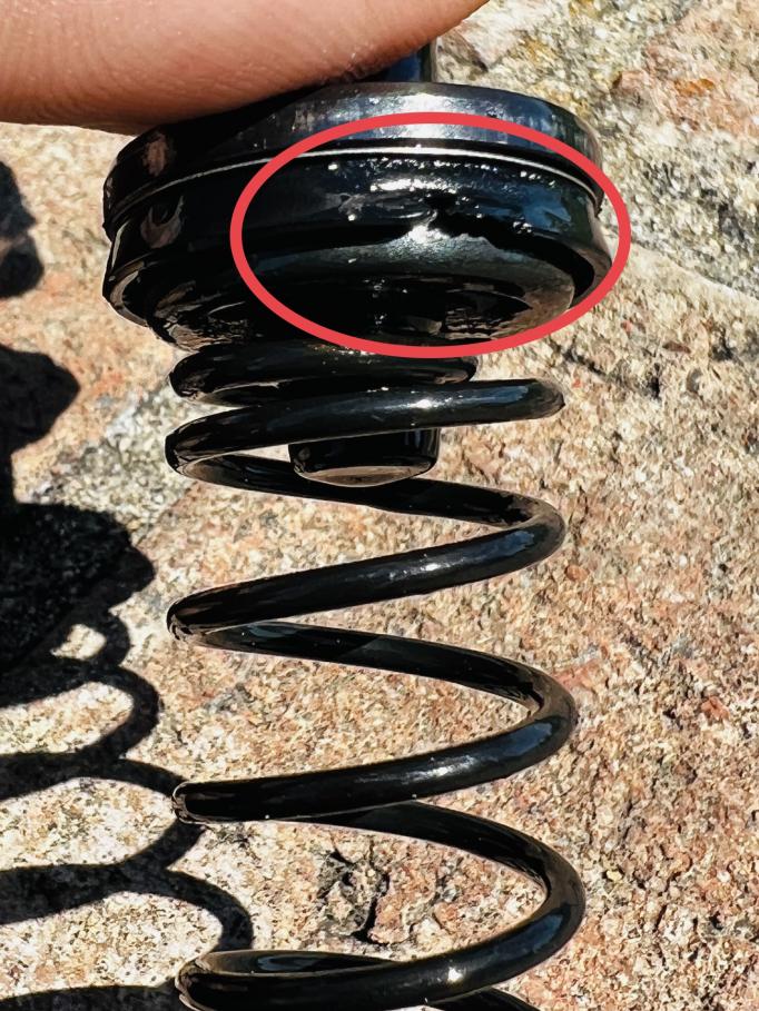

Hi,
I have attached a few photos to paint a better picture of the issue. The brakes have not been working too well, which led me to undertake this exercise. As far as I can tell the rubber seal (?) on the second/ rear piston has a tear, and that's the culprit.
The 4R has close to 250 K miles on it.
Which course of action would you recommend?

3.) Something else? Maybe just replace the piston seal/ seals? From reading past threads, this didn't seem to be an option.
Please let me know if you have any points of clarifications, or if you want to see other photos. This is not my daily, but I will be undertaking a road trip in two weeks.
A new unit will be the way to go.
Check out this: BECK/ARNLEY 0729170 on Rockauto $145.89.
It is AISIN and OEM supplier
