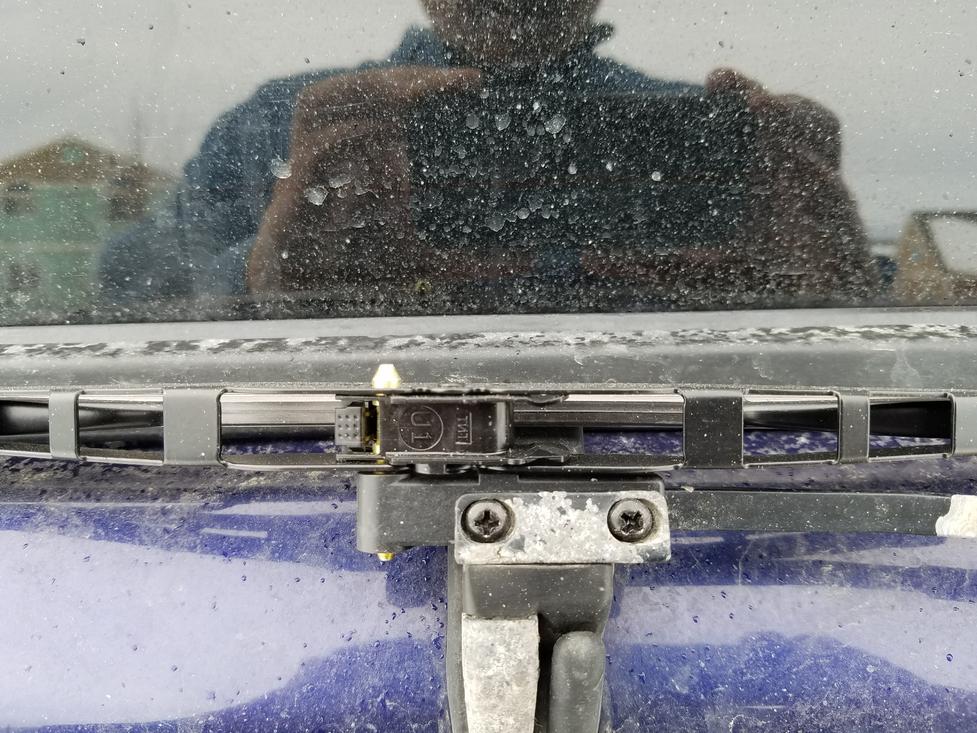

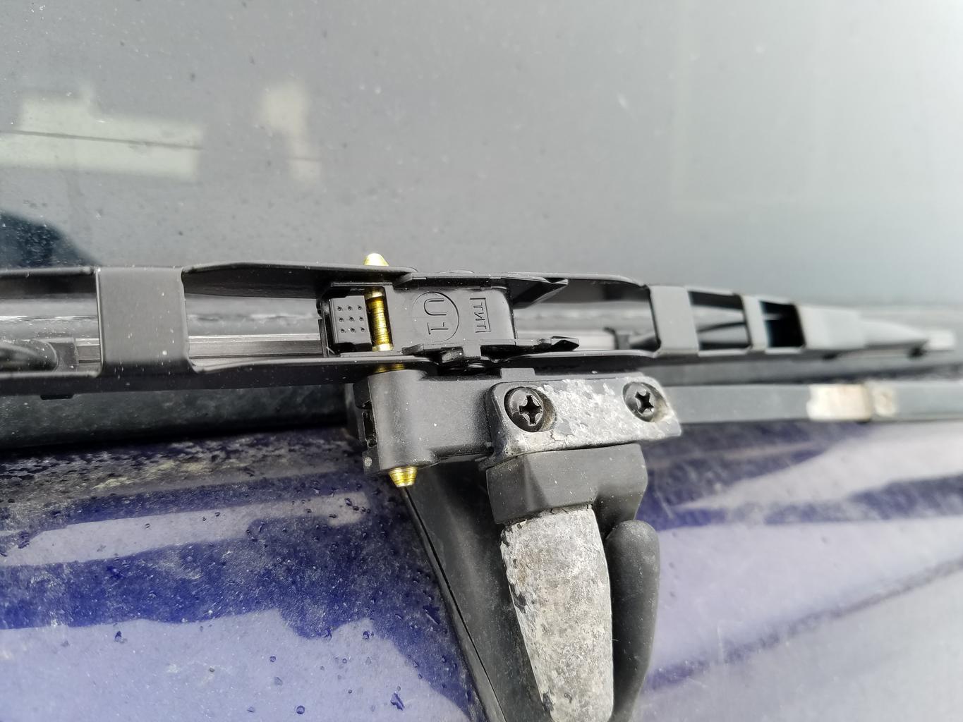

Just wanted to post pictures and note that I had to use sand paper to shave one side down. Wasn't necessary, but did so the wiper can sit square to the window. Great solution for cheap fix. With this, attachment a 12" (which is hard to find) will work on center. If the pivot hole on the wiper is off set, you can use a 13" which is much more common.
