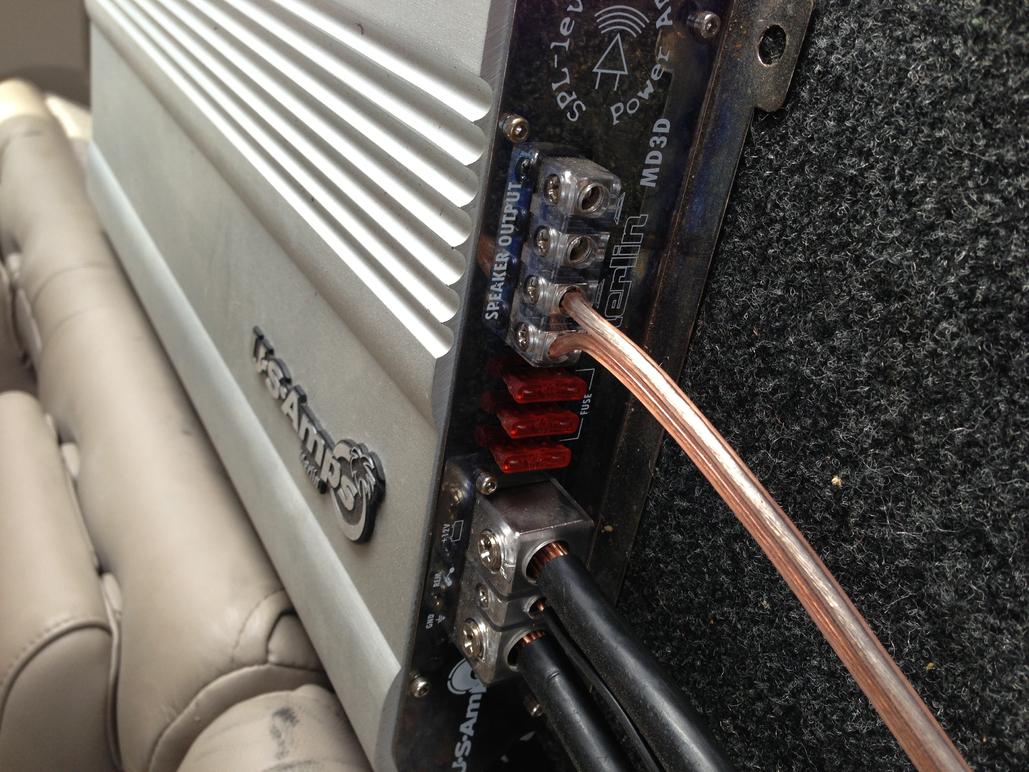

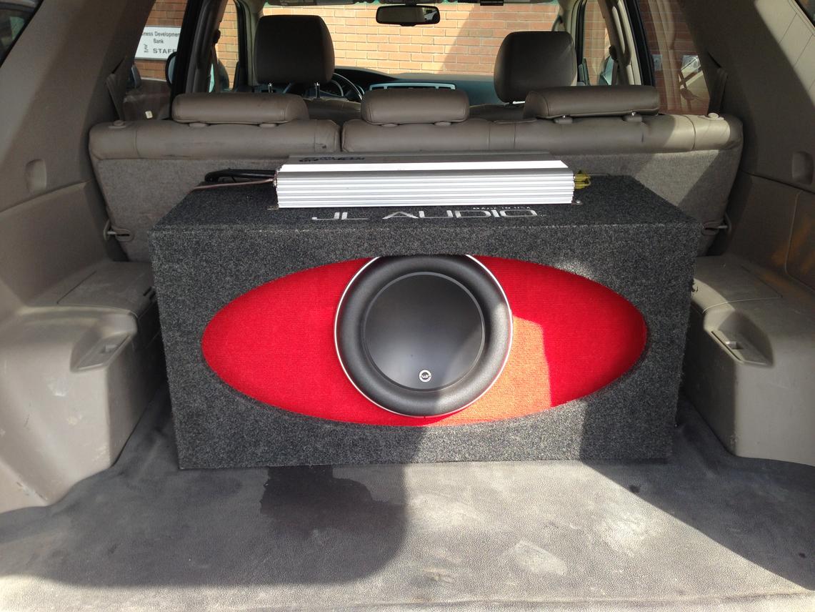

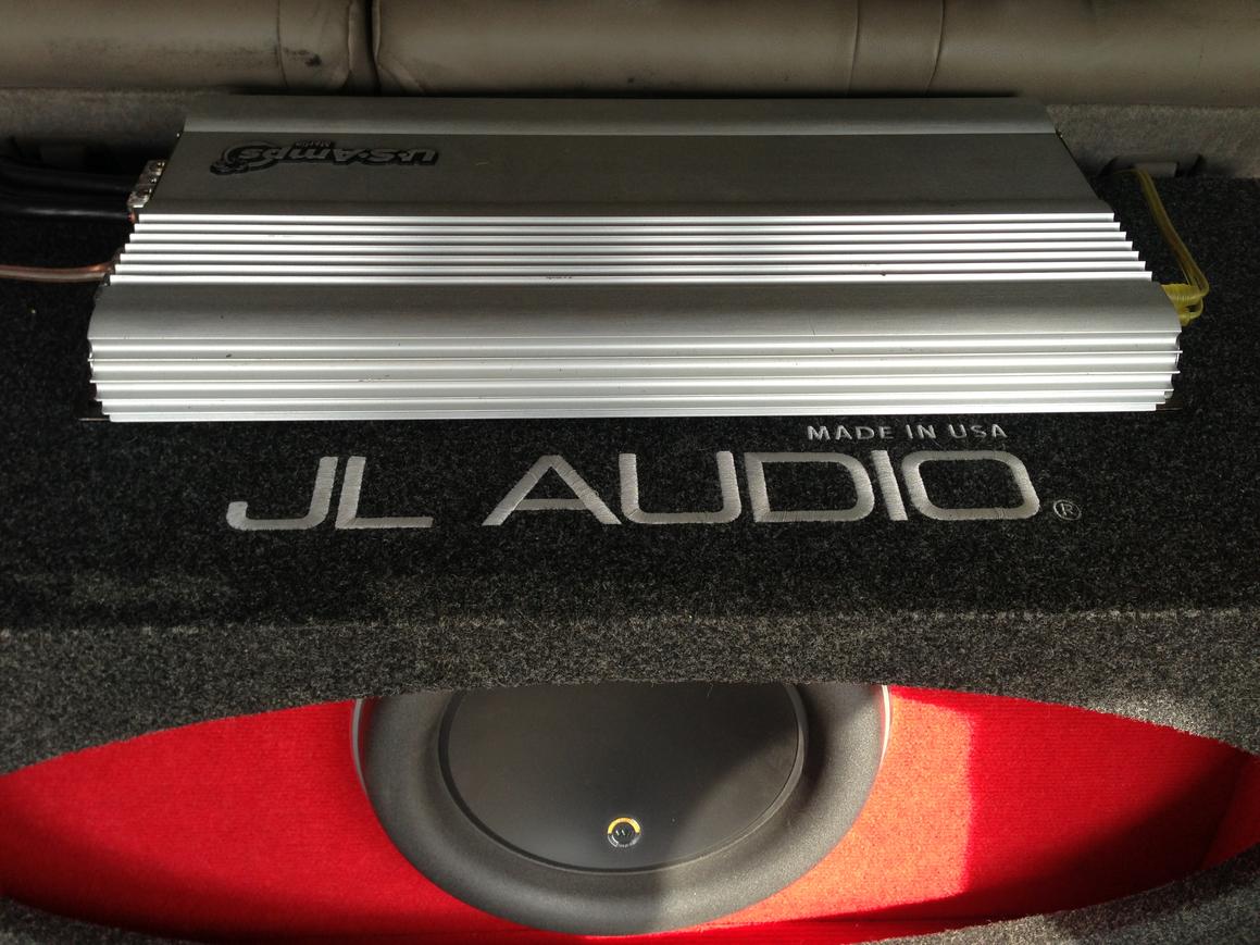

Replaced JBL Sub/Added Amp: Install Pics/Info
what kind of enclosure you got it in?
JL Audio 12W7AE @ 3 ohms
JL Audio H.O. Wedge
US Amps Merlin Series MD3D ~1000w @ 3 ohms
Big 3 upgrade with 1/0 welding cable
Stock alternator & battery. At max volume vehicle is at 13.9v.
im confused.. you said you have a 12w7.. isn't the stock sub an 8". You also said its getting 1000watts.. put also said you have a 250watt monoblock.
did you tap into the wires before or after the stock amp.. if after , that's where your distortion problem is(I believe). Seat bolts are never a good ground. are you getting distortion or electrical interference. 200 hz is way to high for a subwoofer, unless your using it as a mid bass sub. which I assume your not. 80-100 hz is the prime area for a low pass xover.
edit; oops .. just noticed I confused you and someone elses posts..
My system is grounded with a seat bolt (paint removed) and I don't have any distortion or interference. 13.9v at max volume.
JL Audio H.O. Wedge
