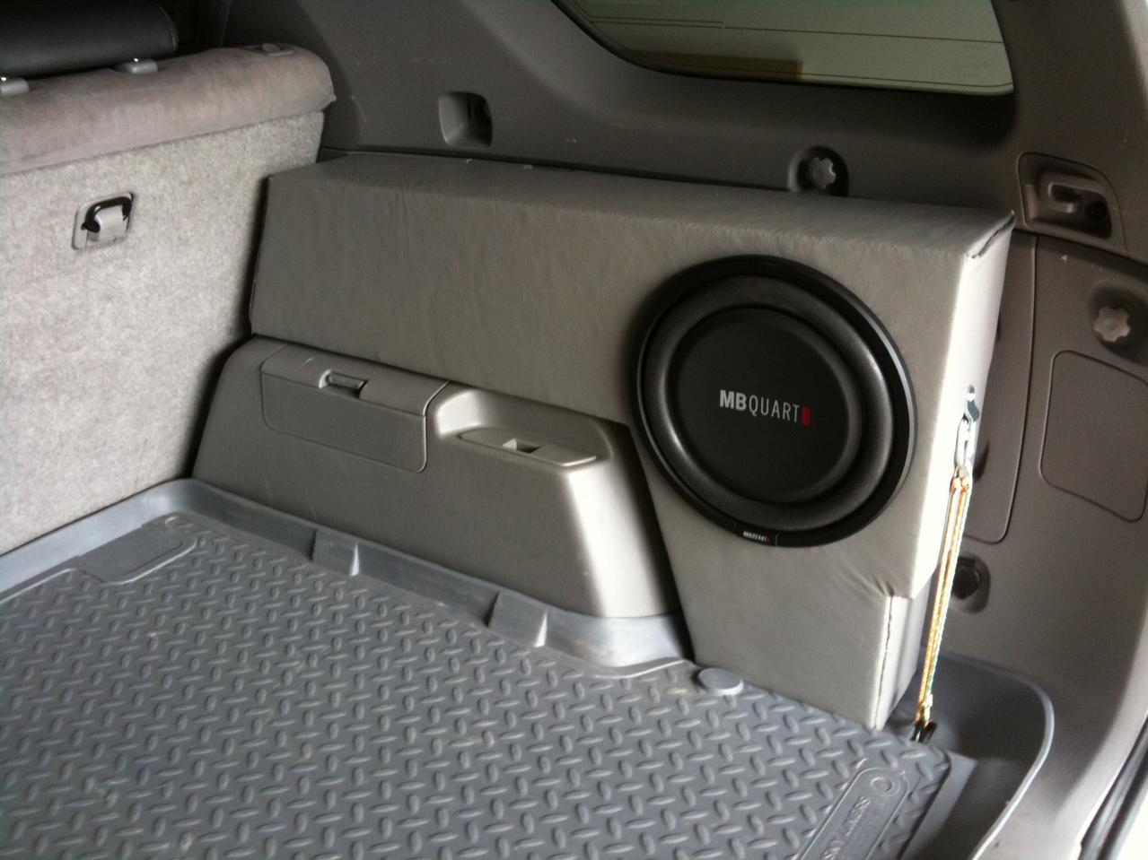

If you don't have the JBL system, a Stealthbox is nice or better yet build a knockoff stealthbox like mine...you lose a little bit of cargo space, not much and is probably cheaper than the junkyards!
That does look good but Id like to try and make it look as factory as possible, and the bigger reason is if my wife cant see it, she cant complain about it LOL...
