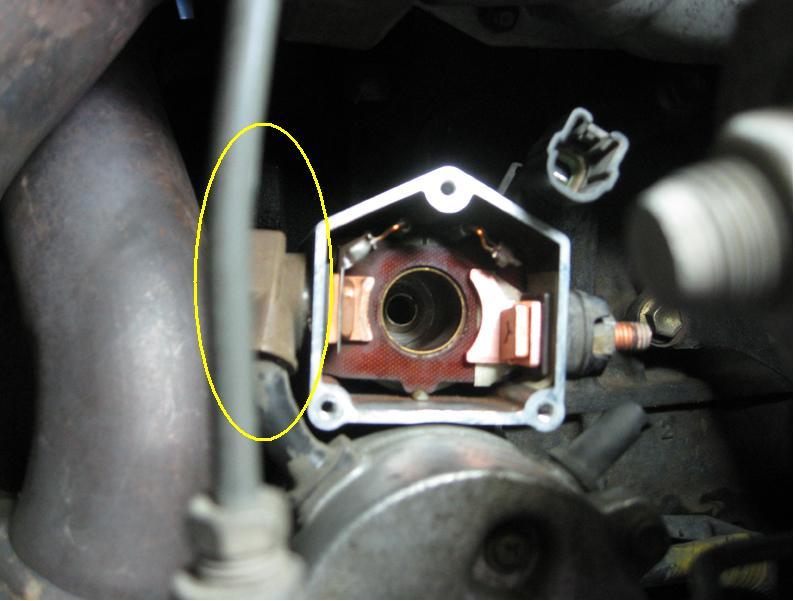

I remember hooking up a wire on the outside of the starter when running the bolts back through....did you miss that when putting it back together?
I'm not talking about the one under your truck. I'm talking about one on the starter
I hope memory serves me correct but I believe its the one in the picture that I'm referring to.

Good thought - but I did not touch that attachment - the covering is still on it and it is not touching metal anywhere - I did spray break cleaner on a rag and clean out the inside of the solenoid before reassembling - I assumed this was OK.....
