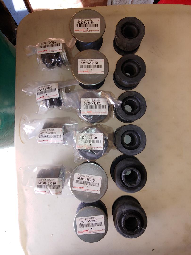

[MENTION=44561]aika1[/MENTION] Thanks for the part #s info and link! Doing a 4Crawler B-lift on my 4th gen soon and wanted to put some good rubber in there with it. Not cheap but a reasonable alternative to a full oem change out. I guess poly bushings aren't being made yet either? Energy? Hello? Energy Suspension? [MENTION=66389]BlackWorksInc[/MENTION] did you ever make your own? I guess no one ever picked up your idea of an FJ/Tacoma/4Runner cross reference?
I bought Toyota body mount bushings from partsouq.com a while back. No poly bushings as far as I know for our rigs. :(
Ordered early Wednesday morning, arrived this morning before 11am. Damn Quick considering there was an International Clearance involved according to Fed Ex. Saved a couple hundred bucks too!!
