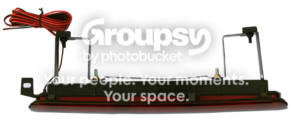

My rear spoiler is an aftermarket. I just found out that the led light went bad and apparently just like the OEM spoiler, the entire light unit needs to be replaced.
The part number on mine is JS-03603. I believe OEM part is JS-03603-E. Mine looks identical to the one pictured below.

can be seperated with some paitence , but the leds in there are in a circuit board. i have replaced the whole assesmbly. it just a easier solution, but since im a modder, i could of change the leds colors and do designs.
FWIW, my (stock) LED brakelight was recently intermittent. With a bit of persuasion, got it apart and found out it was just a cracked solder joint on one of the power wires coming into the unit. Resoldered it, and done. If the whole unit is suddenly dark (it's a little unclear on the original post if it's just one or two of the LEDS, or the whole unit), it might be worth taking apart & seeing if it something similar. If you're looking at replacing it anyway, what's the worst that can happen? You might break it? :-)
