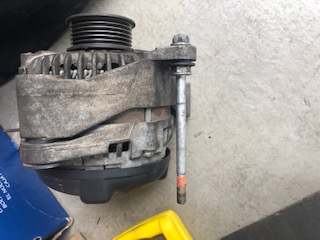

Not sure if anyone will see this, but I just got done taking out my alternator although it was a bit more of a pain than anticipated. Somehow the 12mm nut was basically welded onto the end of the stud so when I went about loosening that nut I actually took out the entire stud (see pics below) does anyone know where to find the part number for the stud and the nut?
Thanks!
Thanks!
Your Toyota dealer.
Your Toyota dealer.
I've tried that now twice. Once over the phone and they ordered the wrong part and then once in person which they still could not seem to identify the part properly. They kept thinking it was the same stud that's on the water pump which I don't believe it is.
