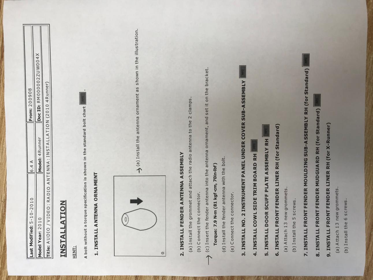

Right Way
Looks like the right way of doing it is pulling the fender liner and removing the antenna base inside the fender is needed. I attached install instruction which say (a) install antenna ornament first. (c) Insert the fender antenna into the antenna ornament.

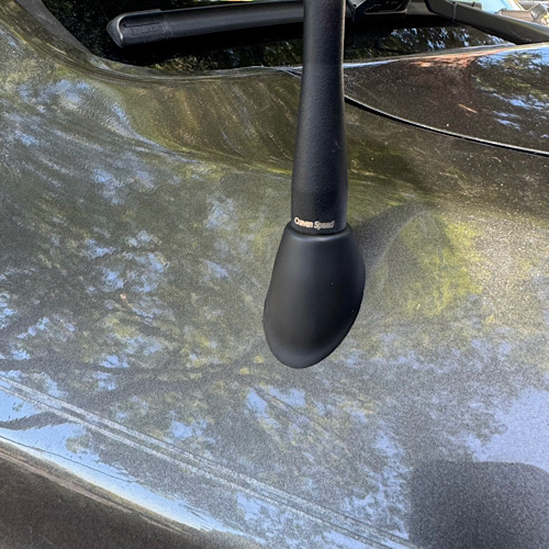

Hey guys. This thread helped me out while replacing my antenna and antenna ornament yesterday, so I figured I should post another helpful tip. I recommend not removing the fender liner. I thought I was prepared with spare clips, but at least in my 2012, I would have had to remove/break clips behind at least one painted panel. Too much risk for me for an antenna repair. For me, it wasn't the top or bottom of the ornament that needed to be trimmed, but just the sides (the part that goes inside the panel of course). Applied dish soap around hole, heated a bowl of water for a minute and forty seconds and dropped ornament in to soften it up. Then it popped right in, nice and snug.
While I was fixing the antenna ornament, I decided to replace the whip antenna. The whip is a tired look to begin with and the fact that half of the black paint had worn off didn't help. Instead of painting it, I replaced it with a Stubby Jr antenna, which I really like. My first non OEM part! It only took 8 years and 90,000 miles. As you can see in the first picture, the antenna ornament rubber got so stiff and brittle after 8 years that the front of it ripped off and flew away on the highway. Here is a before and after. The OEM part number that I used for the hood ornament was 86392-35040.

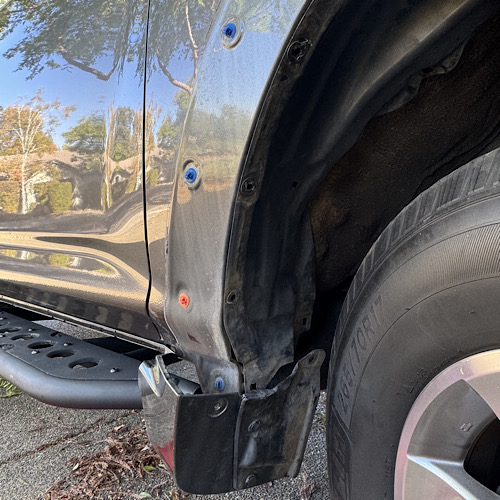

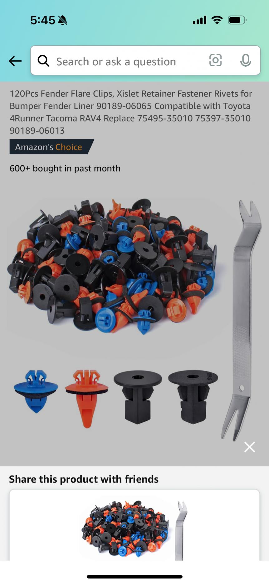

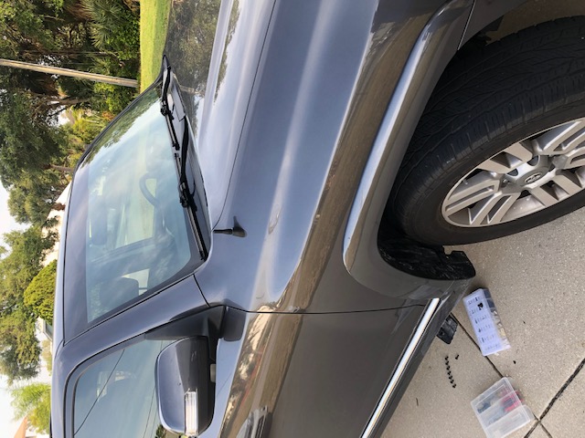

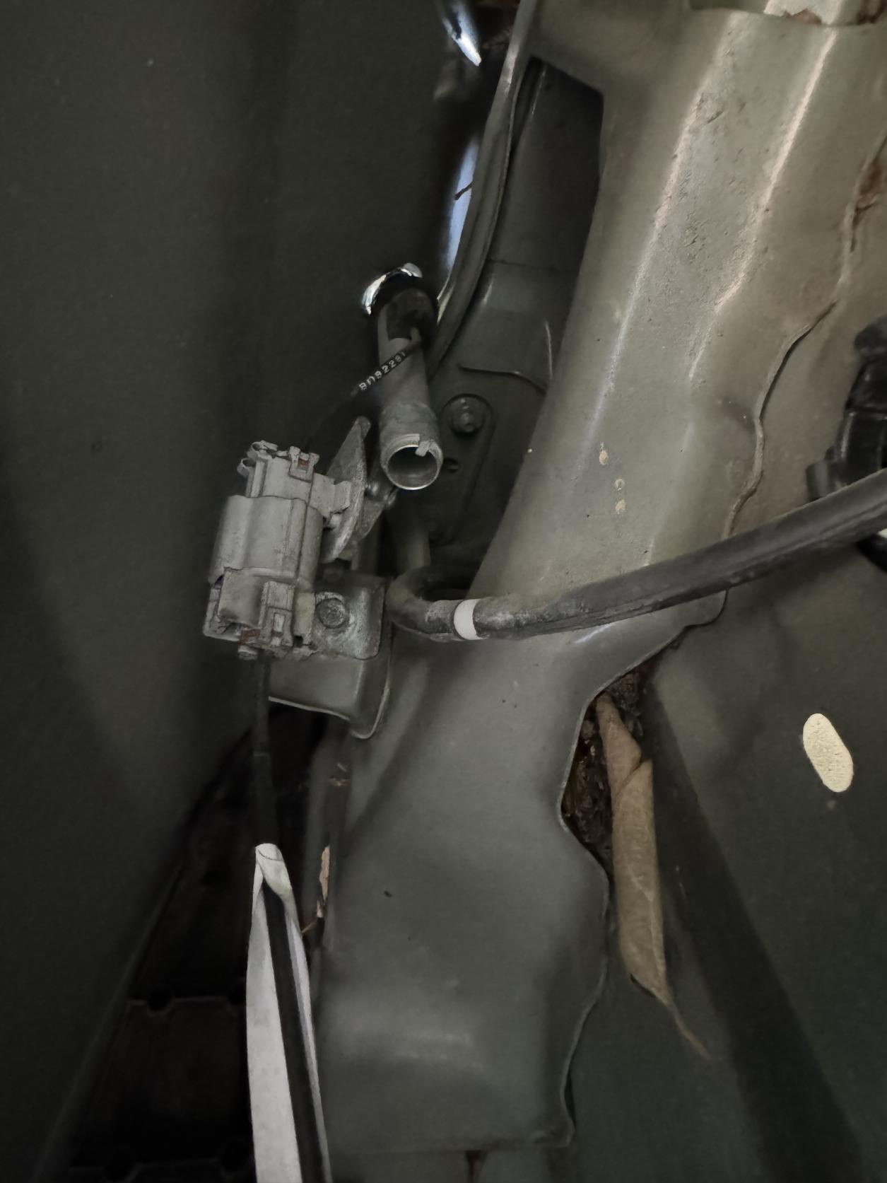

Thanks to all who contributed to this thread. I tried the trim technique but had issues with that so I went whole hog and disassembled the fender to get to the antenna. To do this I had to:
1. Remove the 10mm screws holding the fender liner and trim in
2. Drill out the pita black fasteners
3. Remove the exterior trim on the fender to drill out the fasteners behind it.
4. Pull fender liner back
5. Loosen the antenna and slide the ornament in. Went in as easy as you can imagine
6. Replaced a lot of the fasteners I drilled or broke. Orange, blue, black.
7. Reassemble it all
Was way too much work, but in hindsight I wish I just did it the way the instructions above said to begin with. Hope this saves someone else some time.
