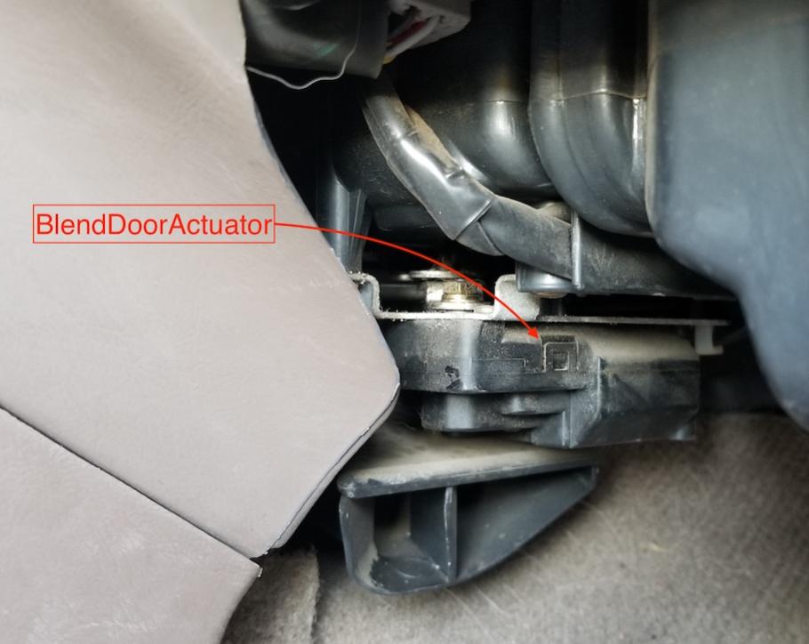

Reviving this thread, as I might be replacing that cable on my 2001 T4R.

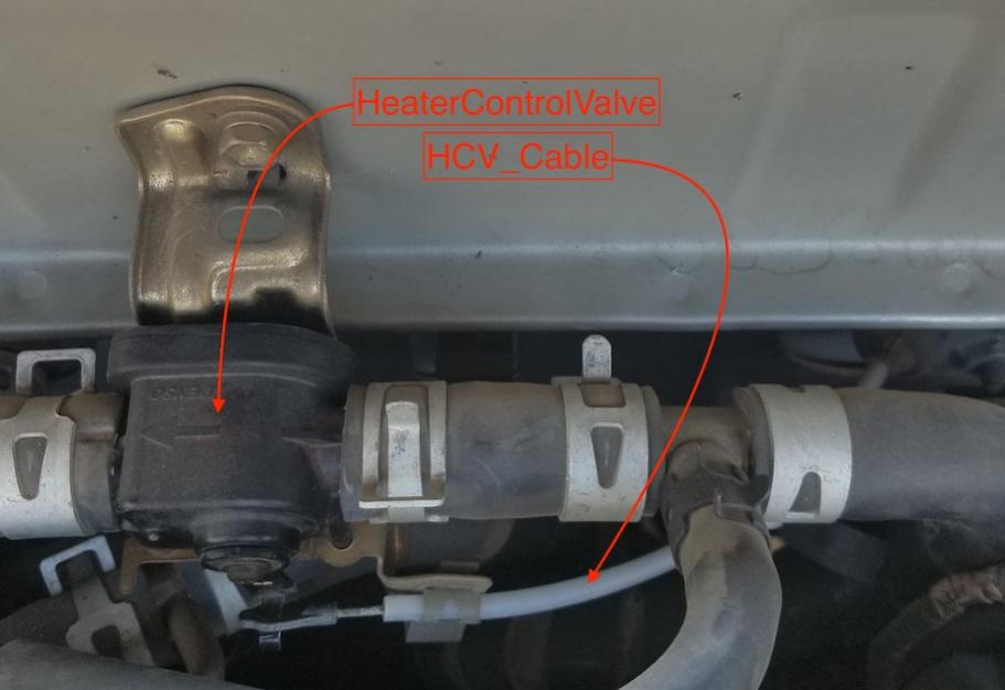

This is the cable that goes from the HVAC Blend Door Actuator (under the radio/hvac cluster) to the Heater Control Valve (on the firewall in the engine bay).
In debugging poor AC cooling, it seems the blend door and control valve are not repositioning. I'm replacing the actuator. But, this cable is also really stiff to pull/push. So, any advice on removing/reinstalling is appreciated. Thanks!

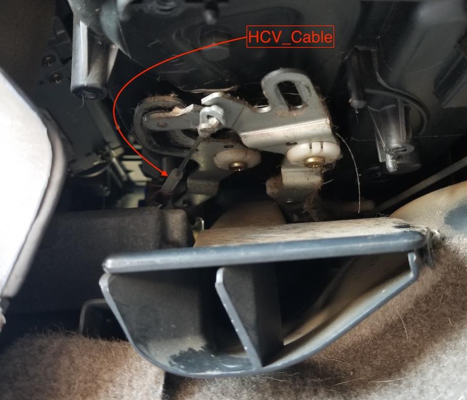

Yes, I did replace the HCV cable. It's not that hard, except for one and a half annoying access things.
Half-point: You need to remove the HCV actuator in the left of the passenger footwell. It's held on with 3 phillips sheet metal screws. 2 are easy to access, the rear-left one needs a shorty screw driver, and even then you need to push it into the carpet to get a good shot.

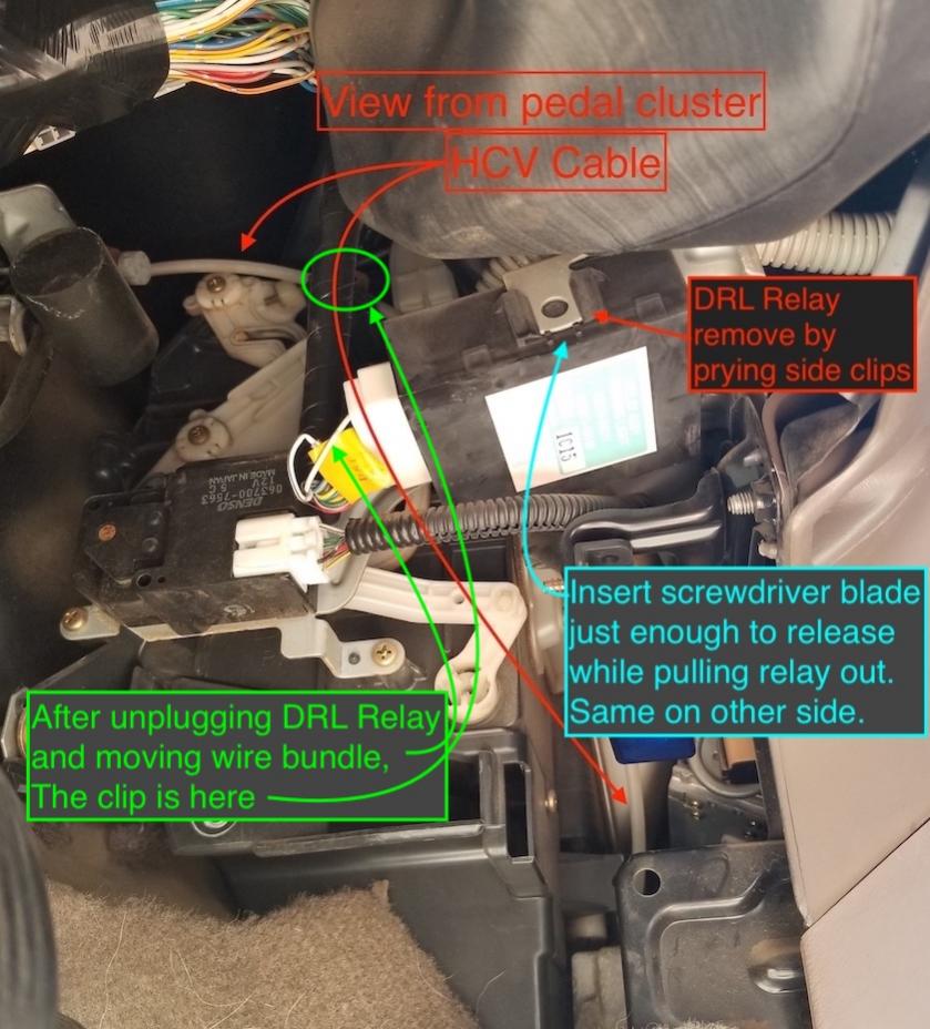

Full-point: The HCV cable is held in place by 3 spring clips (each end, and middle). The one near the HCV actuator is annoyingly difficult to access. Small hands, and/or long curved needle-nose pliers, help.

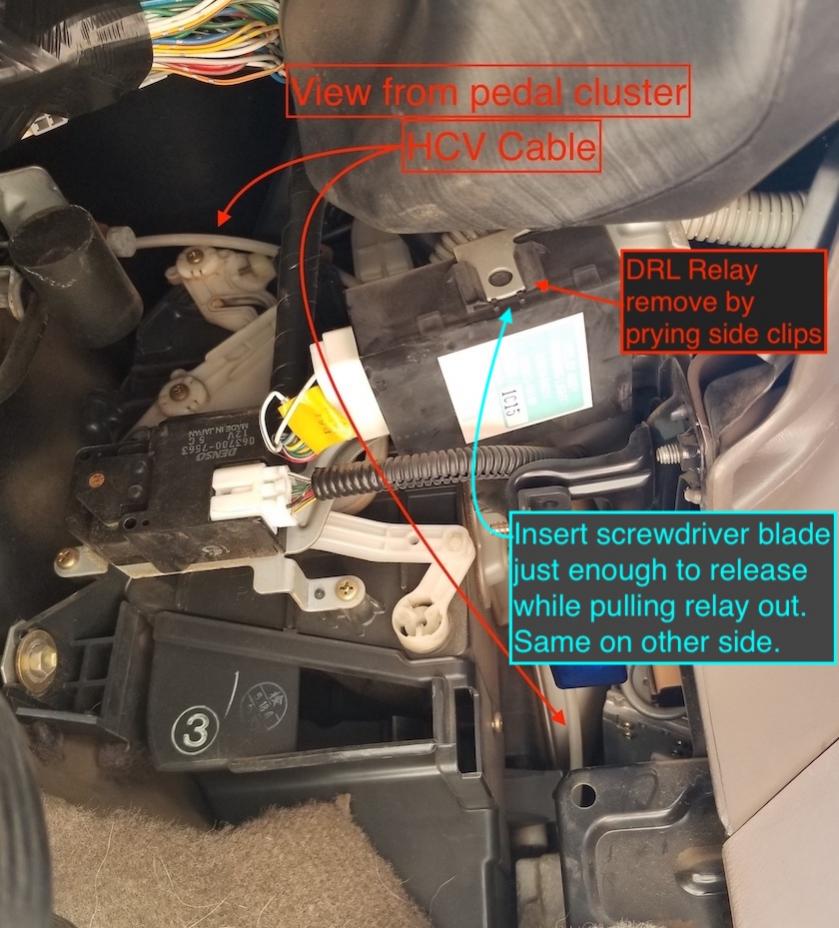

Note: It helps to tie/tape a string to the cable at the HCV Valve end and pull it into the driver footwell. You'll need the string to pull the new cable back through the firewall grommet into the engine bay.

When R&R, you may also need to remove the headlights/DRL relay under the driver side dash for access. (I can't fully remember). If so, you don't need to unscrew anything there. It's held into its bracket on the sides. Jamb a small flat screwdriver between the bracket and the relay just enough to release and slide partly out, then do the same on the other side, then incrementally wiggle it out.

When you say "3 spring clips"...where are those? I see one near the HCV and I assume there is one on the other end near the actuator. But, the rest of the cable seems to be between the firewall and the dash. (Mine goes through the firewall almost immediately (5") after the sprint clip at the HCV end.

My son and I replaced the actuator cable on his 1999 4Runner this morning. Followed Wayne's instructions. We did not need to remove anything other than the actuator motor in the passenger footwell. Some notes. Having two people did make the job easier, but it isn't necessary. Definitely tie a string to the cable before you pull it out. The clip next to the HCV opens from the bottom. Push down on a tab nearest to the firewall at the bottom of the clip, and then push toward the front of the vehicle, swinging the clip upward. The other two clips are just spring jaws that you push the cable into, or work it out to remove it. I did not need to remove anything in the driver's footwell near the pedal cluster. The clip was readily accessible. Make sure the outer sheath of the cable is positioned properly so that both ends will line up with the clips. Also, after you clip the cable in place, but before you attach it to the actuator and the HCV, test it to make sure it slides easily inside the sheath. If not, you may have crimped something. Oh, and have a good flashlight and a young person who still has good vision handy. That made a huge difference. In our case, we still have some work to do as it appears the actuator motor itself my need to be replaced (part on the way) and the AC may need to be recharged. But, the cable replacement went smoothly.
