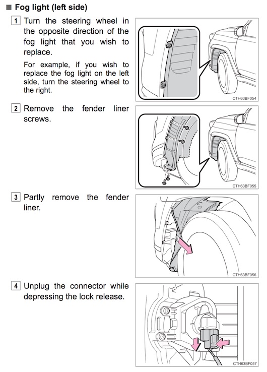

I am trying to replace the fog light bulbs on my 2016 and I cannot for the life of me get access to them.
The owner's manual says to remove 4 screws holding the fender liner in place, and I did so, but the liner will not budge. It looks like I will have to remove a lot, lot more fasteners to get the liner out, but that doesn't seem right. In the manual they just show it peeling back like it's a sheet of rubber.
Anyone done this? Any tips??
Plastic is a little hard, but if you just give it a forceful yank, it will come... Helps to remove the third bolt on the fender too.
Don't forget there's two at the very bottom. Helps to do it on a warm day.
No need to remove the fender liner. What I did was just go from under and reach in with my hands and no problem replacing the bulbs.

I also reached up from below on the inside to replace my bulbs with LEDs. It's an awkward angle to turn the back of the bulb but it can be done.
Thanks to all who responded. I did manage to get the bulbs out!
I actually found it was helpful to turn the wheels *towards* the side I was working on, contrary to the owner's manual. That gave me much more room to pull the liner back.
Thanks, removing an additional bolt (actually the 4th one up) did help. Unfortunately not a lot of warm days in New Hampshire this time of year, but I did get it.

Yes I got both sides. Once I figured out how the liner snaps out it wasn't too hard, and both sides were exactly the same. Also like I said above, turning the wheel *towards* the side you're working on gives you a lot more room to work with the liner. (I don't see anything in my owner's manual about one side being a dealer job.)

I know this is an older thread, but I just replaced the bulbs on my '17 Limited. The Limited has a little different body work on the outside, but underneath should be the same. Undo all five bolts on the fender liner and shine your flashlight up there to see the bottom of the bulb. The bolts are different sizes, so keep them in order.
The passenger side has a small shroud around the bulb, but it does not hinder access to the bulb at all from beneath. Easy to lay on a creeper and work up instead of sideways. You must remove the wire plug first, then twist the bulb.
Took me 10 minutes per side, and I'm no mechanic.
