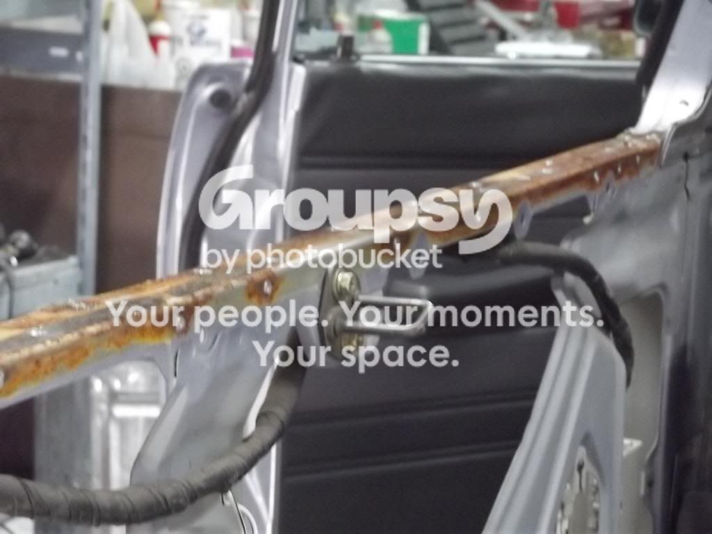

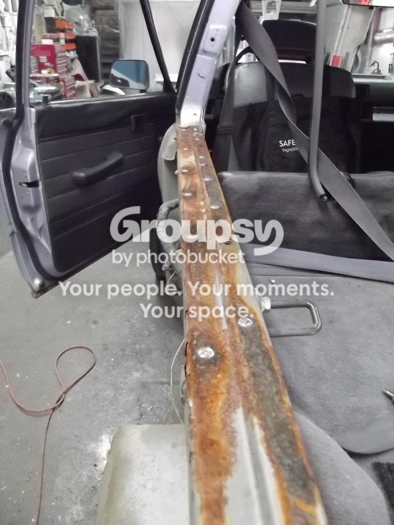

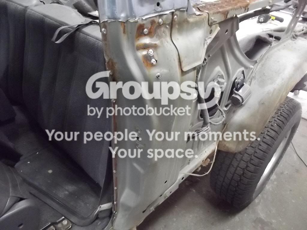

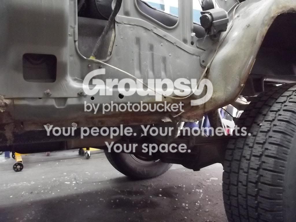

We have many , many customers come in every year , whom have spent thousands of dollars in the past trying to stop the rust . welding in patches , and bondoing up the panels . What most people don't understand , is the rust that they don't see ..
like these pics
DSCF1278_zps044f16d2.jpg~original
DSCF1276_zps146af967.jpg~original
DSCF1275_zps257cfb6e.jpg~original
DSCF1274_zpsbd9c155c.jpg~original
the nice thing with replacing the whole panel with ours , is you can address these issues .
