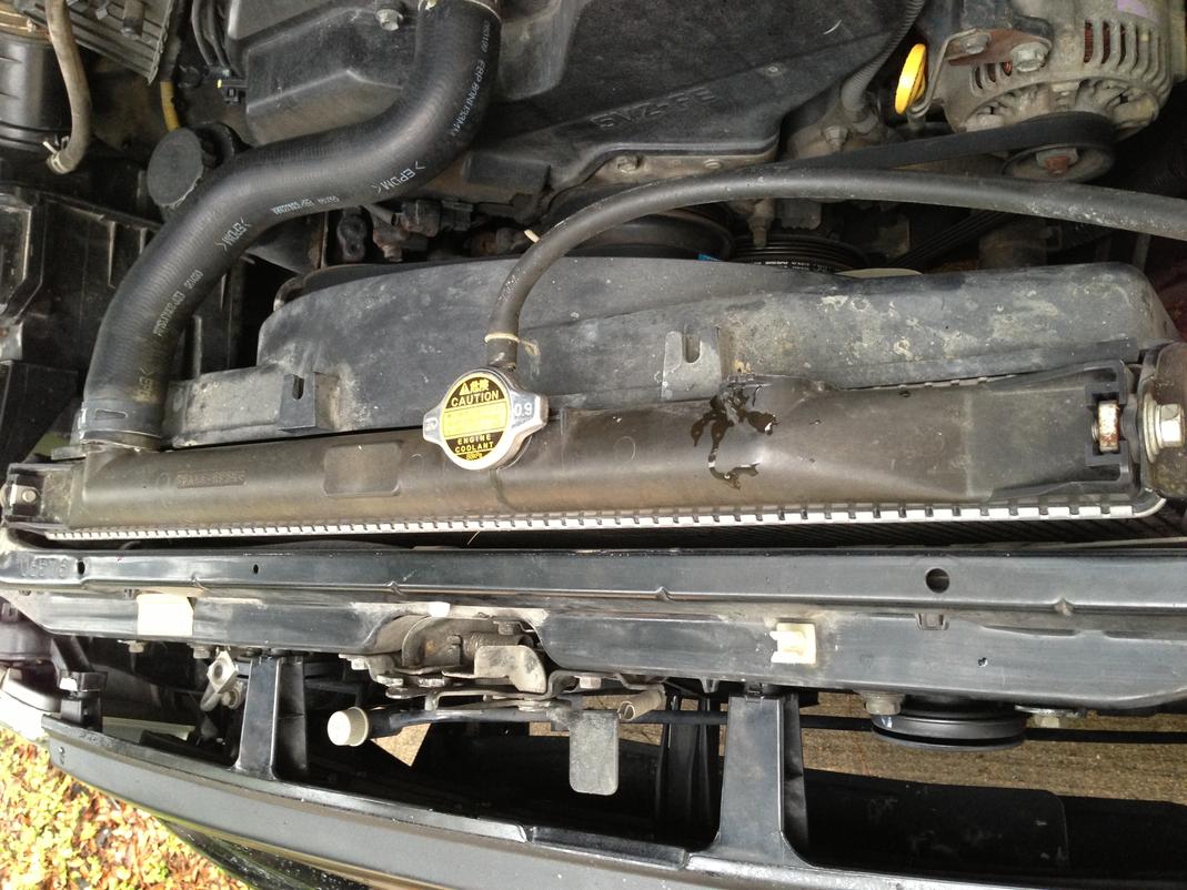

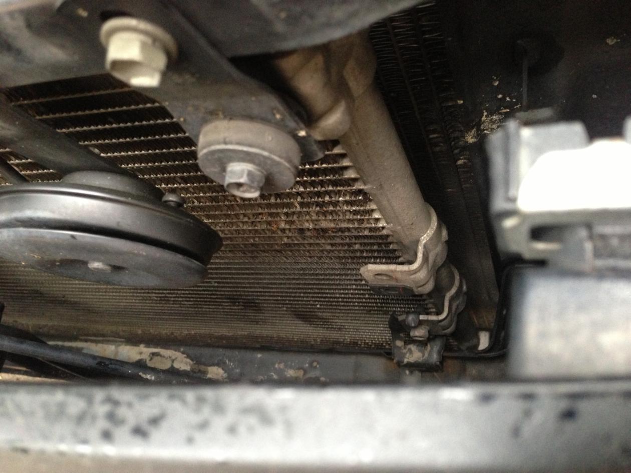

Radiator and then this is I front of it.

Thanks. after the first couple responses I figured it was but im new to these vehicles as well as working on my own stuff, besides suspension, and basic mods.

Once you have the old rad out before you put the new one in is the time to zip tie the cooler to the condenser.
