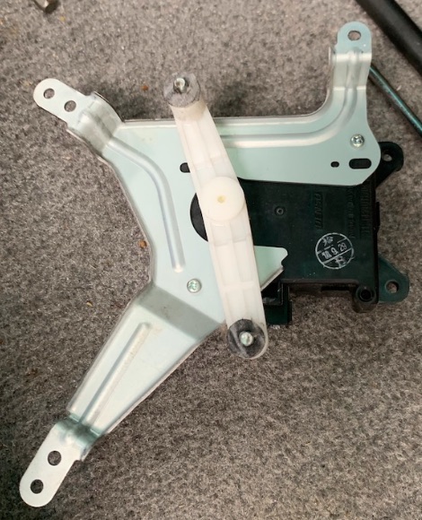

I also found that Autozone sells the actuator, part number MT18605, for ~$40. However, it does not include the plastic piece that goes on front. It is easy to remove by simply lifting a tab in the center.

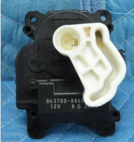

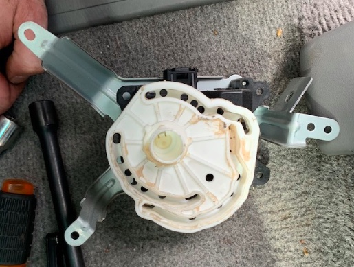

I replaced the other two servos this weekend that are on the other side of the blower motor box. I used a Harbor Freight right angle screwdriver with some extensions and they came out with lots of patience. The Autozone servo motor works great for one of them, but the other is a stealer only part with the gear glued on, part number 87106-35180.
Update, here are pictures of the two parts. The one with the tab in the center has the removable gear and the Autozone actuator replacement works great. The metal bracket is removed with three screws. The other one has the plastic gear glued on and can't be removed without breaking it (which I did :Cry:) I think this is a dealer only part, but maybe someone else has a different solution.
