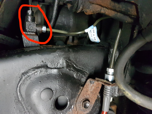

Sorry to bump an old thread but i'm in the search for this brake line adaptor because I might have to replace it when I do my brake lines next. I found my hard lines heavily corroded so I plan to replace a couple soon but i'm not sure if i'll be able be able to save this adaptor.
Also see that Toyota doesn't sell the pre-bent OEM hard lines anymore which sucks. Props to Drew76 for the pic! :)

Does that "adapter" do anything beside re-direct the brake line by 90° ?
What do you mean they don't sale prevent lines anymore?
I just bought a few hard lines prebent. I now have the ability to make my own using copper nickle and stainless steel nuts.
I also checked and those adapters and lines are still available pre bent from Toyota. :-)
I guess I wasn't looking at the right thing in the catalog. Nice to know its still available! Going to take another look right now and see if I can locate some lines.
It doesn't look very useful tbh. Maybe I will bypass it if I choose to go with copper lines and bend them.
The adapter on the passenger side makes changing the starter a lot easier as you can move the line out of your way yet leave it connected.
The driver side may make it easier to remove the upper control arm bushing bolt and removal as well for the control arm the same reason. I think they both are for purposes like those as well as having a union right out of the wheel well behind rubber aprons. Thus not having to replace a long line if they get damaged..:(
I replaced my upper control arms this weekend and never had to touch that adapter or move the brake line on either side to do so.
IIRC, I didn't have to do anything with that brake line on the 2WD pass side to replace the starter, but looking at it on my 4WD that union and line is definitely in the way...

Oh good to know. Maybe it was used a simply a holder of the 2 lines on the driver side then.
I never had to replace those union adapters and i have 2 fairly rusty 3 gens as well. :-)
Up to the owner of the rig if they stay or go..:-)
