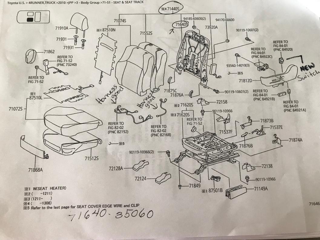

So, if you 2010-2011 owners remember 5-6 years ago, a TSB was issued for lumbar support "crunching", and we were able to get it replaced with the TSB attached. Recently, I had my lumbar support just cave in on me while driving (I'm at 95k in a 2010 SR5). Dealer replaced the switch, said the motor functions, but the seat back frame (which I believe contains the spring assembly) needs to be replaced (Part #71640-35060, if you'll notice, it's the same as in the old TSB).
Near $1k for parts and labor at my stealership. Part diagram attached as well, you can see the frame as 71640S.
I'm trying to stay on top of things so that the little things don't start adding up as my T4R reaches adolescence, but this seems a bit spicy for my neophyte skills.
I couldn't find much on search other than the old TSB posts, does anyone have any experience replacing the frame?
