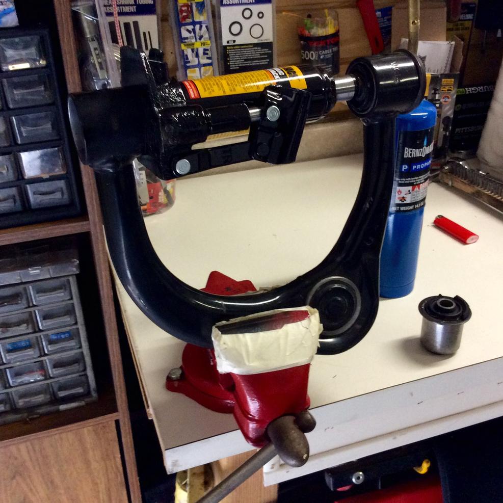

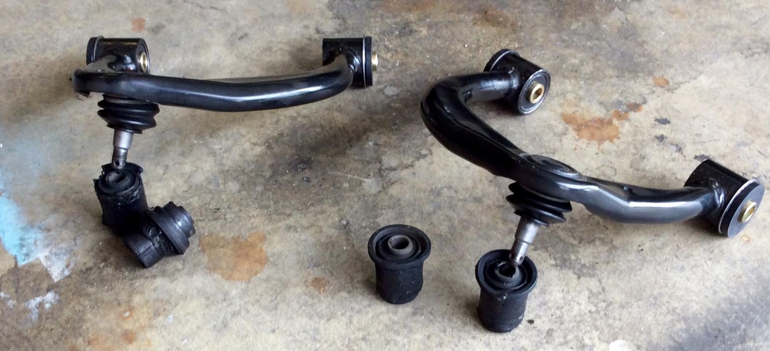

Just rebuild your oem uca's, I just did mine with new bushings and ball joints and it only took a couple hours very straight forward and simple good as new and you have oem ride and feel for your commute again.
So, these are NOT permanently pressed in as the dealer would have you believe?
[MENTION=95189]340W[/MENTION]
Nope. NOT as they make it out no. Would they ever fall apart..never. Do they just come apart...no.
The only way they come apart is with a torch by heating up the metal around the bushing and pushing it out once the heat shrinks it from its bond in the metal sleeve. Super simple each bushing takea about 10 mins to heat,push out,clean up the inside metal sleeve and then slide new bushing with the provided lube using a c-clamp and bam your done.Now slap the whole UCA in which is another 10mins.
Instructions on this come with the new bushing set from energy suspension and I believe there's a couple vids on youtube as well
