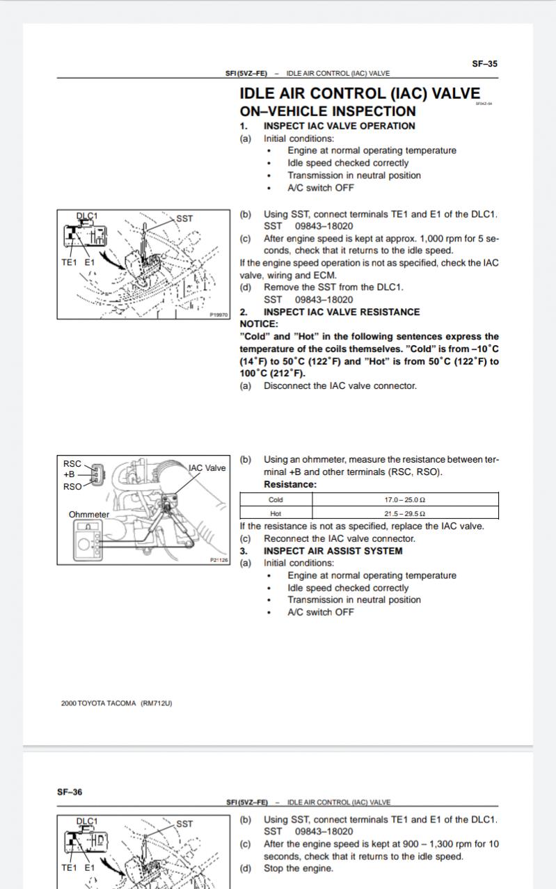

On my 2000 fsm I got:
Cold - 17-25 ohms
Hot - 21.5-29.5 ohms
Cold = 14-122f iac coil temp
Hot = 122-212f iac coil temp

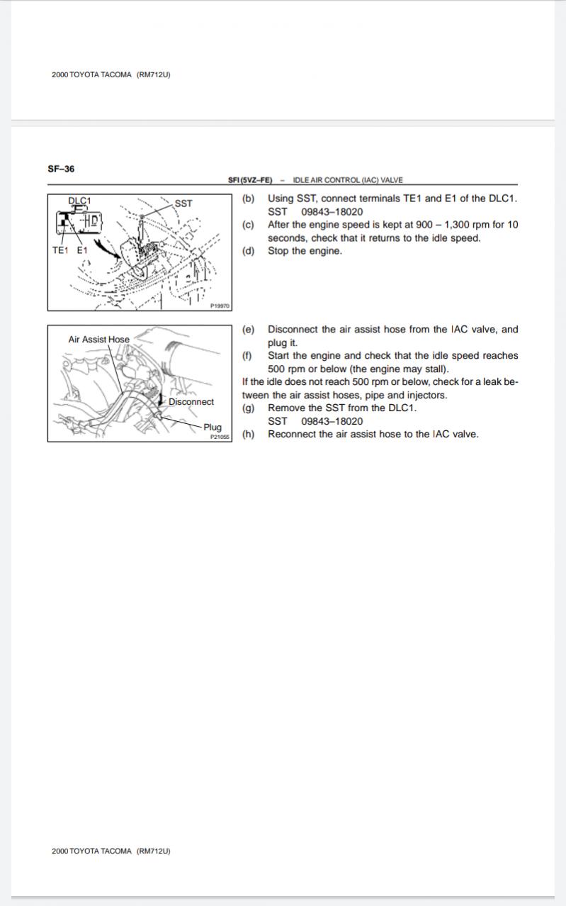

I couldn't find the iac resistance values on my 3rd Gen fsm but I had a document for a 5vz-fe 2000 tacoma. hope it helps
