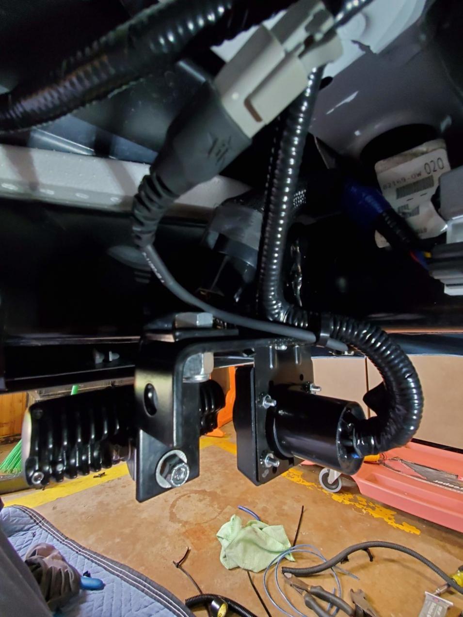

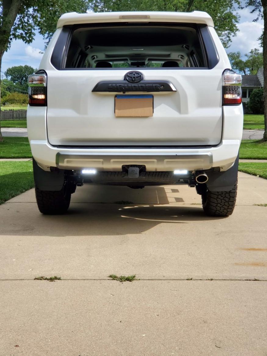

Went with these. Mounted underneath tucked away. Tap the hitch for power and reverse trigger. Black and yellow, grabbed a ground in the hatch and ran relays to switches on the dash. Auto on with reverse/off/ on at will, helps with tailgaters

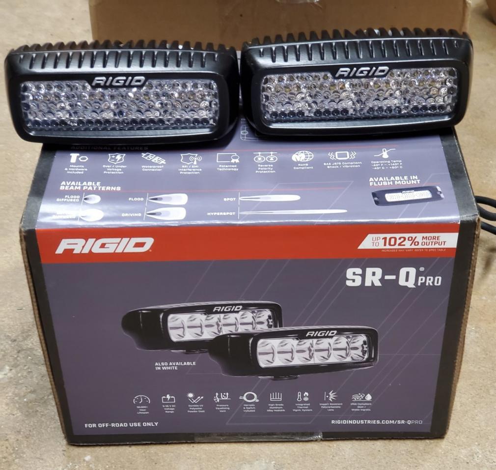

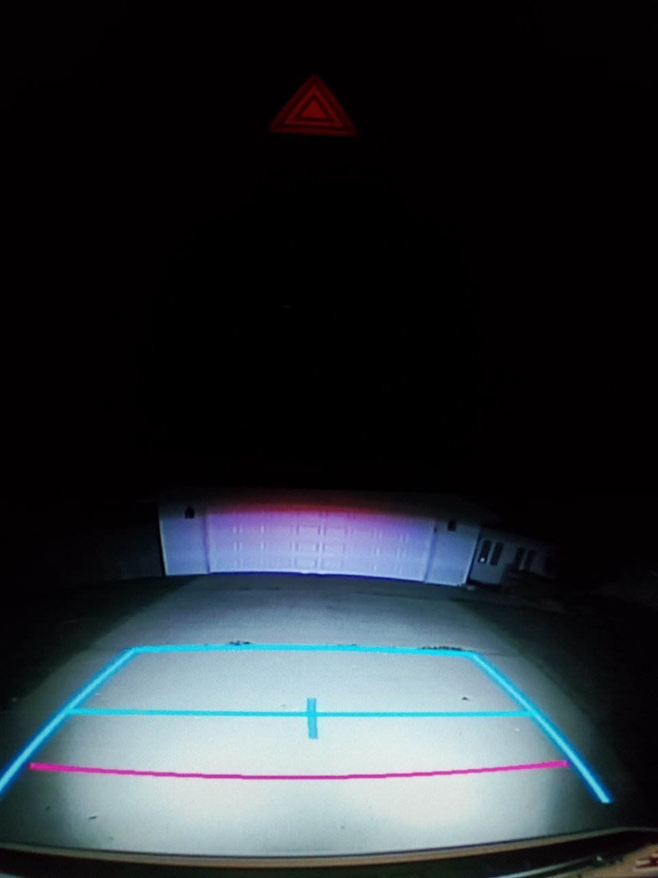

Does anybody have the Vleds for $70 a pair? If so comments and maybe
pictures from outside and the dash cam.
It looks like you re-mounted your trailer plug. Am I right? I've thought about moving mine. Tucked back up is nice and out of the way, but it sure sucks when you want to plug into it.
If you did do it, what did you do to move it regarding wiring and mount?
Yeah I removed the stock plug and bracket. couldn't find anywhere to aline both(centered) right and left side without getting rid of it. I bought this on amazon and screwed it to the "L" bracket holding up the light. Still tucked away but easier to plug into. They also sell flush mount if your brave enough to cut into the bumper. I've seen a runner in this forum that did it
