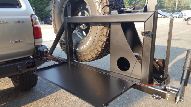

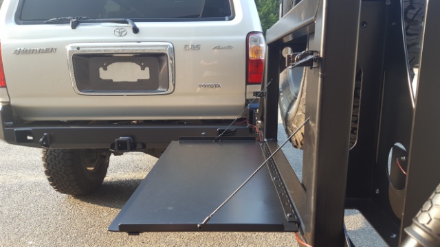

Everything fit Great! Adam and 4X Innovations were great to deal with. A couple of the table latches got bent in shipping, but they still work. Have a strong friend and a V8 The day you fit it, and it should be smooth sailing.
I got a deal on the powder coating, but if I was to do it again, I would go the POR-15 /paint route. There are a few small imperfections in the powder coating, nothing big, but everything can get scraped away. And if that is the case you might as well just use the POR 15 and paint. But scrapes come with the territory, so it doesn't bother me that much.
Also, the powder coater was running a week late, said it was going to be ready this Monday at 0900. I called to confirm it was done as I was heading out the door at 1100. It's about an hour drive. It wasn't done. I thinker they rushed it because they didn't remove the latches and a couple items we talked about and just painted over them, so we'll see how well it holds up.

Wow. It looks so good. I think I'm gonna pull the trigger.
How much sag did you notice in the rear? Did you have a lift prior? And if so, what kind?

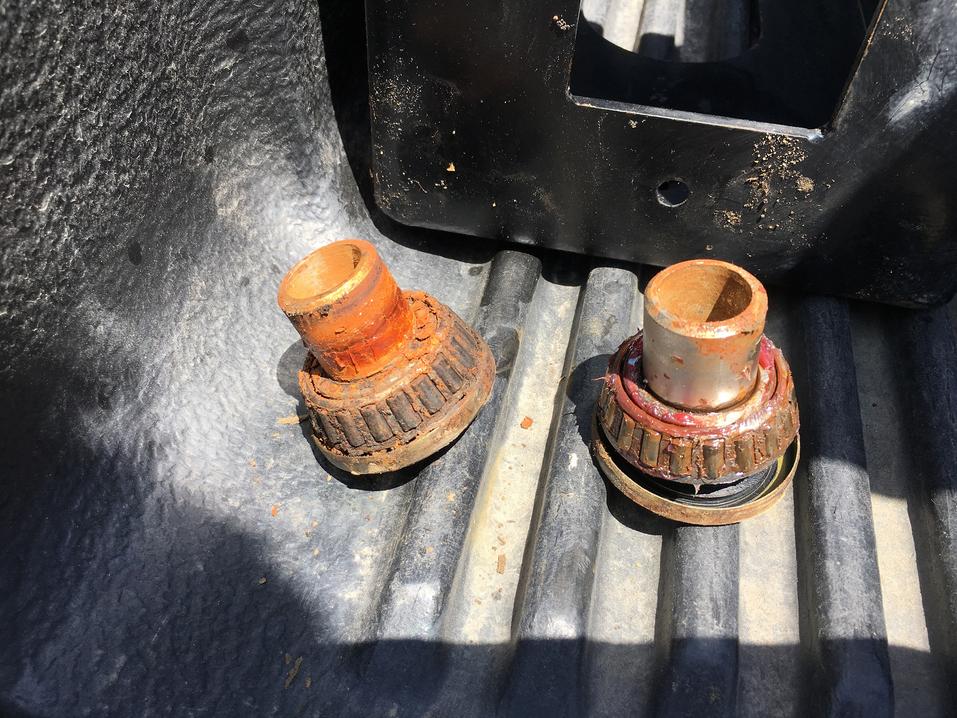

Had my bumper going on 3 years. Overall I'm still very happy with it. Only downside I wish it was a little lighter. I'm going to recommend checking the bearings and seals every year. I should have checked it last year to re-grease the bearings and change the seals if needed.

I appreciate all the questions/answers in this post. This bumper is definitely on my build list. Just a quick question I'm assuming those are the bearings for the swing out?
