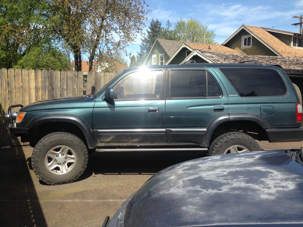

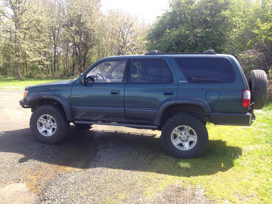

Also got hub measurements:
24" rear
23.25" front
That's with front and rear plate bumpers, winch, sliders, and ~200 lbs of tools/subwoofer.
