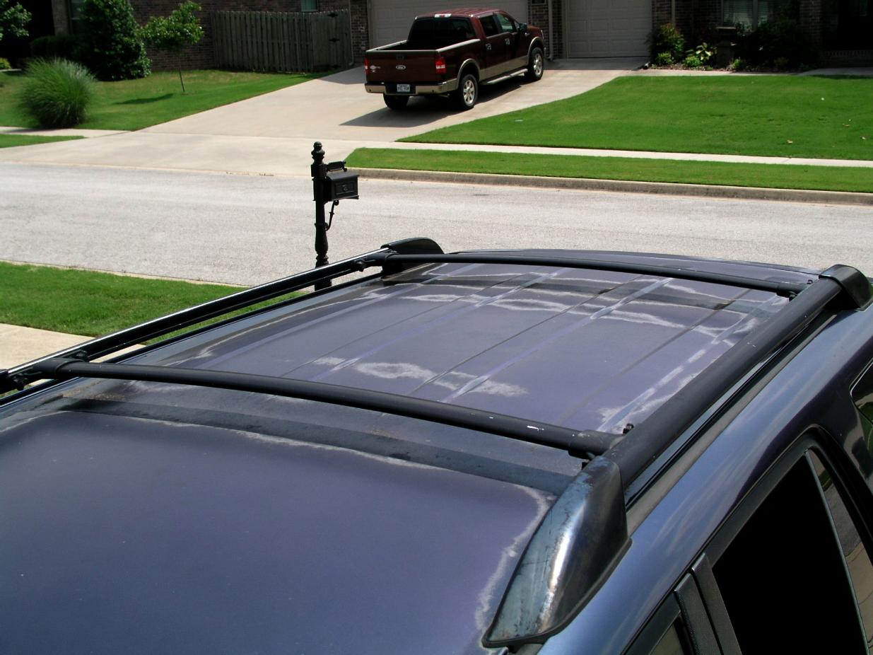

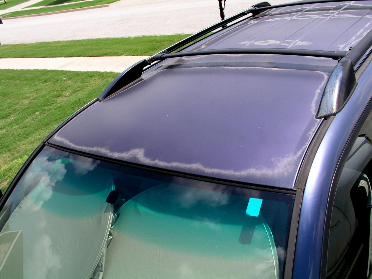

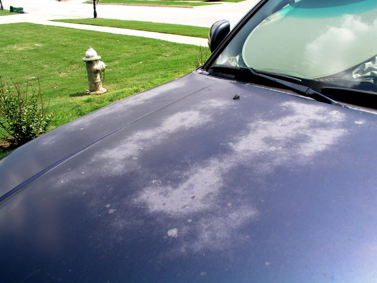

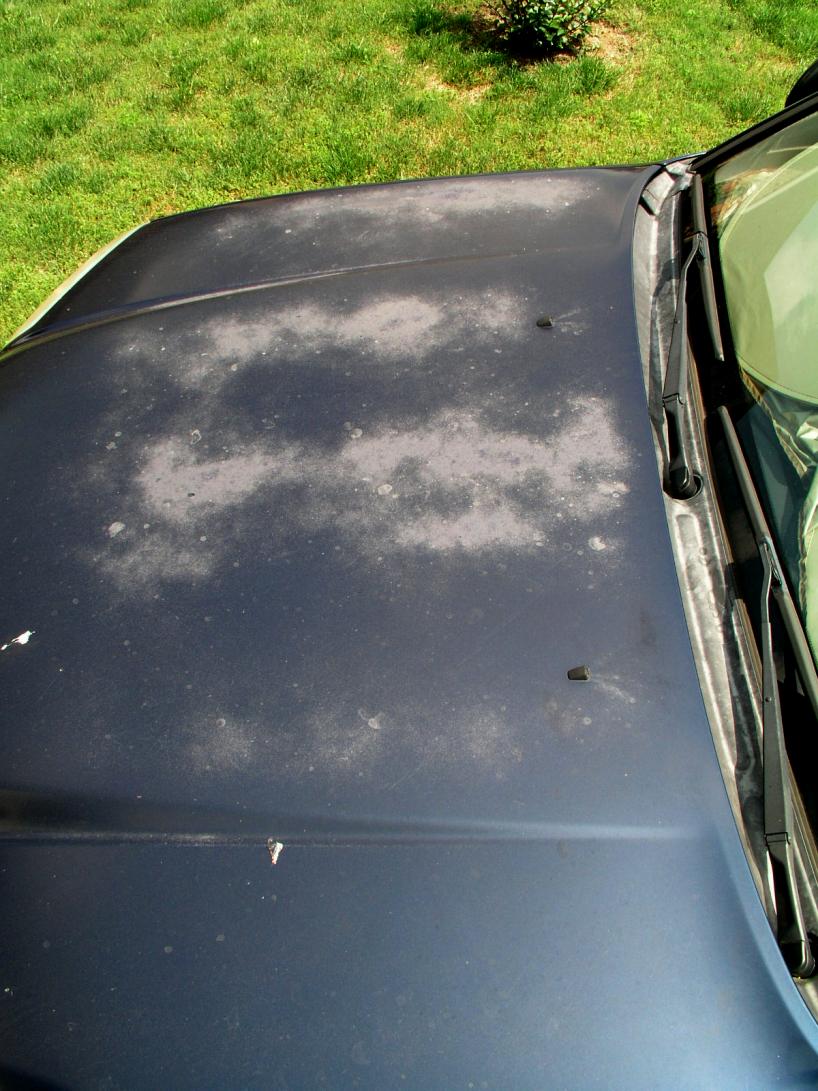

Thanks for your interest and expertise. My 4R has been exposed to the elements for 16 yrs. I totally realize that this is not a DIY project. It requires professional detail skills and experience.
Here's some pix to better illustrate what I'm dealing with. Basically I'm just asking if something less than a complete repaint would be worth the expense.
Oh boy. That's bad. I'm afraid what you have there is way past wet sanding, buffing, and polishing. Sadly, it's time for paint.
