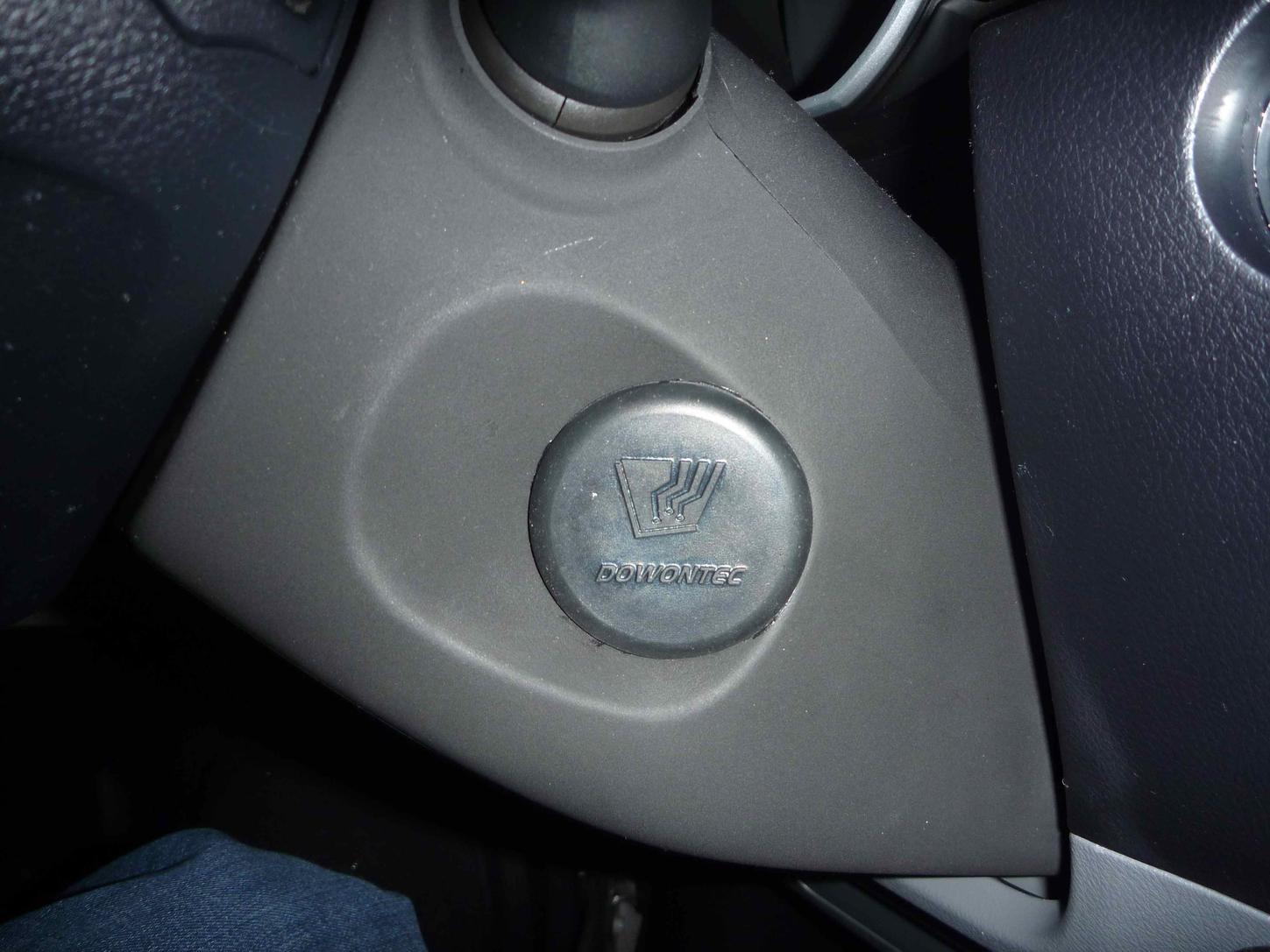

So, they have to cut the head off a key and permanently install a key in the ignition?
Yes or else there is no way to keep the steering column unlocked. I used my valet key since its a heck of a lot cheaper than a normal key fob.
Here is a pic after I installed the plastic cover over the cut key. You could also order a Limited steering column cover since it has no hole for key.
