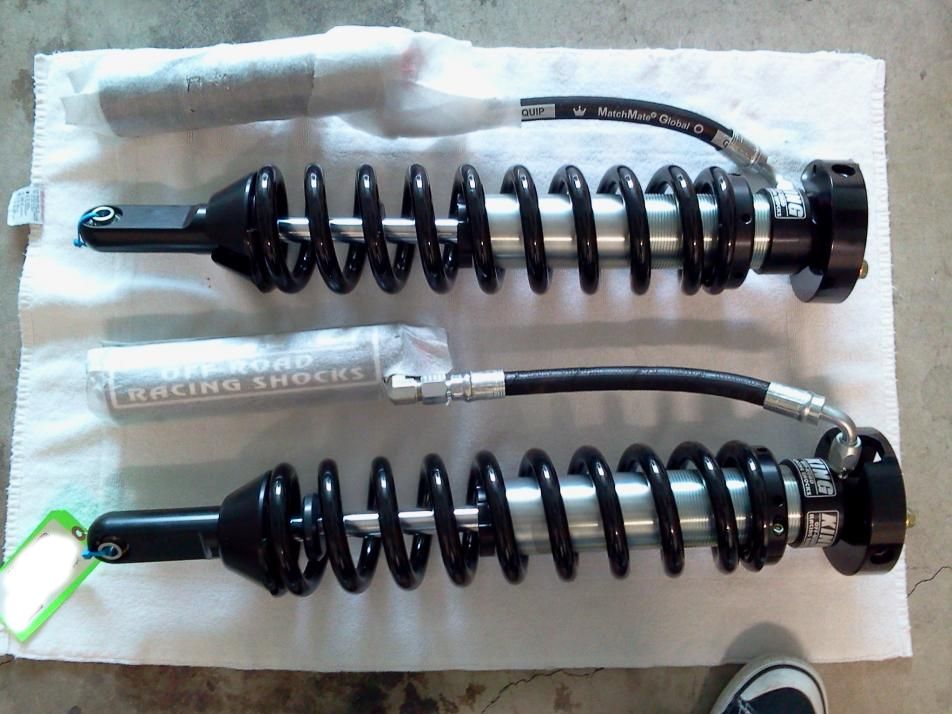

I ride with KING w/adj. all around and have finished the balance of my build with all ICON to stage 6 build. My 2010FJ is built to be a daily driver but wanted it capable of taking it offroad on most any condition. BOTH ICON and KING are sweet, but imo the KINGS have made EVERY bump hole ridden back dirt road...simply...butter. I have hit DEEP holes on the fly...simply puts a giggle on my face everytime.
I went stealth mode and had mine built custom all black by KING...hated to load up baby blue colored KING with my rig....had to pay extra...but as it's set up and built now I wouldnt change a thing!
I wish you lived closer so you could wheel it yourself with me...cuts the freeway on/offramps like its my Audi A6....without a squeak from the tires....anyways...pm me if you have any questions.
I do have a unused new set of CUSTOM KING coilovers in all black but they are for long travel. They got pulled from posting because the title was incorrect but should have them reposted today. KING 003.jpg
