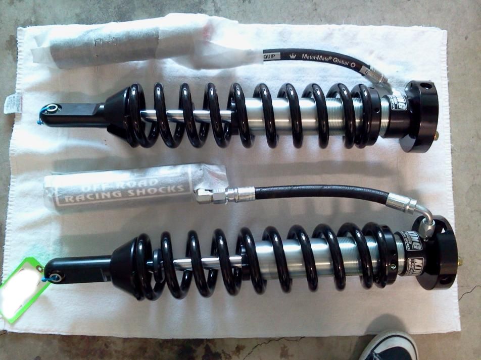

ATM I only have half the story to share but...
I had Kings on my Taco, they were "stiff as hell". They worked ok keeping me off my bumpers but on typical rough road or washboard and even on the street when going over bumps, potholes etc, every tiny vibration was sent throughout the entire frame. Driving on a 30 mile gravel road was exceptionally tiring, felt like the entire truck was going to vibrate apart.
So for that reason on my 4runner I've ordered (backordered damit!) Icons instead due to their complete opposite valving. Hopefully for my on road and 98% of my offroad the ride will be much improved.

Tacoma's typically run a heavier coil (650-700) for some reason. FJ's and 4R's run 550's. With that being said, i'm sure the heavier coil harshness can be eased out with proper valving. My plan is to go to a 650# when i get my Shrockworks bumper...hopefully it doesnt become to stiff.
I noticed on my kings when I was screwing with the ride height they quickly stiffen up. King basically says don't do more than 2.5 inches of lift if I remember right because of this. My kings are downright plush.

Well I got my Icons installed today. And so far, my fears about a repeat of the terrible stiffness and jarring ride I got from my kings is completely gone.
My kings were giving me 2 in of lift, not cranked to max, were bone jarringly stiff over the tiniest things. Pothole, gutter lips on driveways, everything.
So far the road ride on the icons (currently set for 3 in of lift) is plesently firm but not jarring at all. Purposely ran over some 2 in deep potholes on our street and they went over them smooth and easy.
Going to give them a real workout in borrego next weekend. So far I'm extremely happy!

Such an unusual description of the kings, I have icons in my tacoma and kings on my 14 T4R. Kings on my t4r buttery smooth almost too soft, icons on my taco...very firm more of the jarring you got with kings. Maybe you had a valving issue not sure but most would say kings are just butter.
Maybe they changed things over the years or something. Mine were installed in 04 on my then new Taco. At the time I was dissapointed but just figured that that was the way those things were. (My first COs)
They worked well when going over larger stuff, but they just amplified every little jarring washboard, crack, pothole or small ground fluctuation.
I can see how things could have improved quite a bit in the last decade though.
