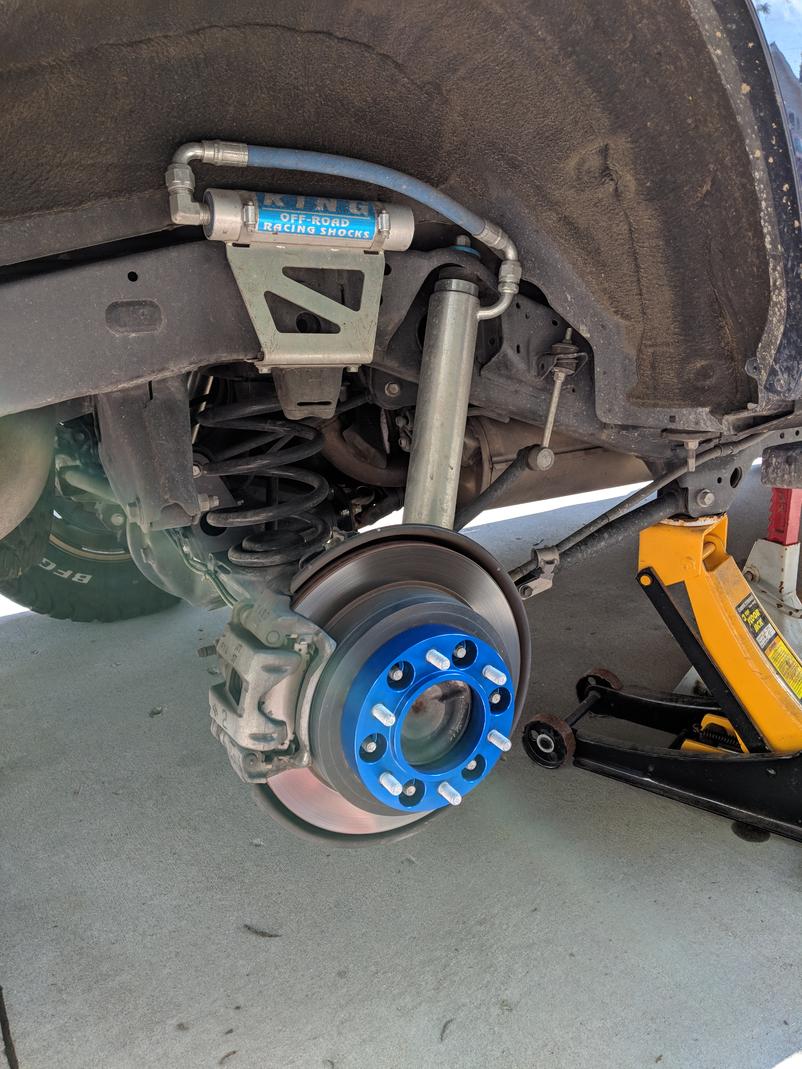

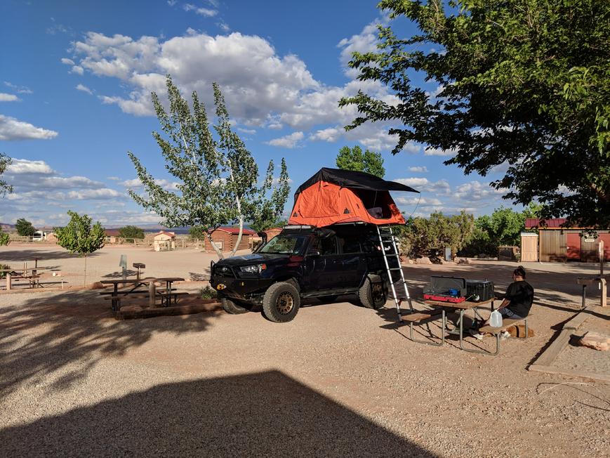

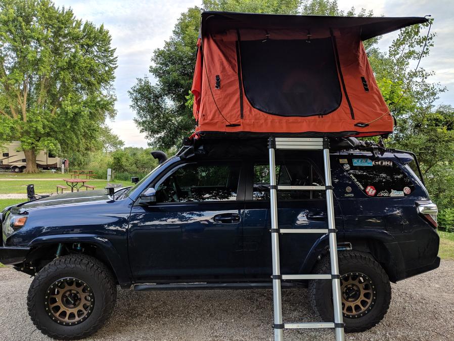

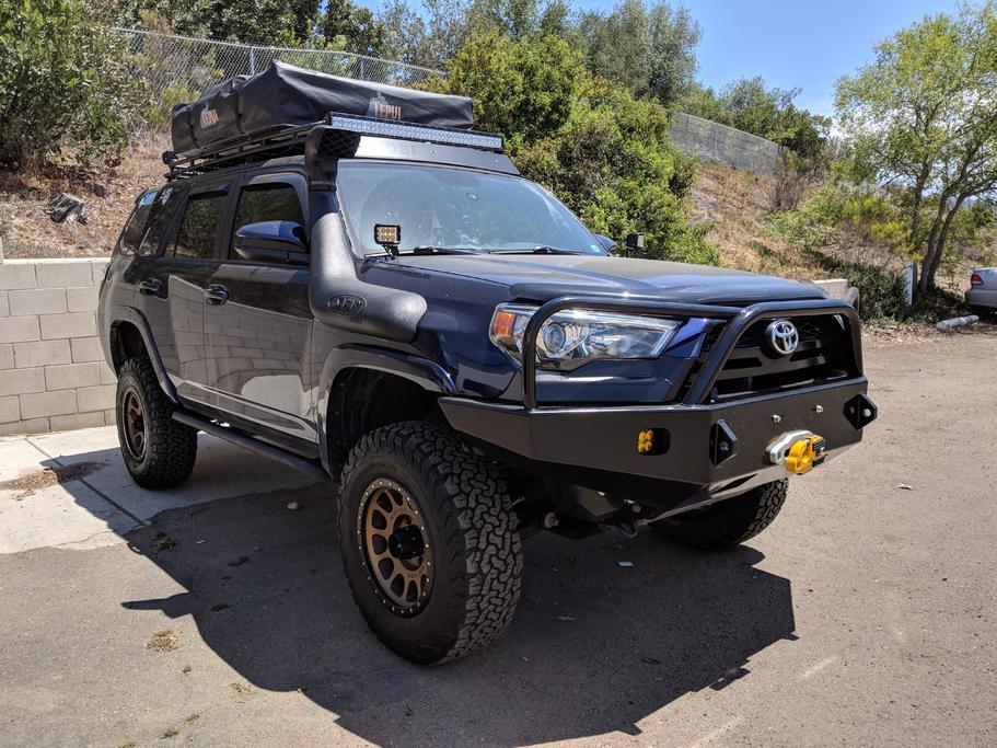

A few update pics. The Spidertrax spacers have improved the handling slightly and of course her stance. Method race wheels are also new to the rig. Rear bumper is the last thing I'll need for her...for now!
