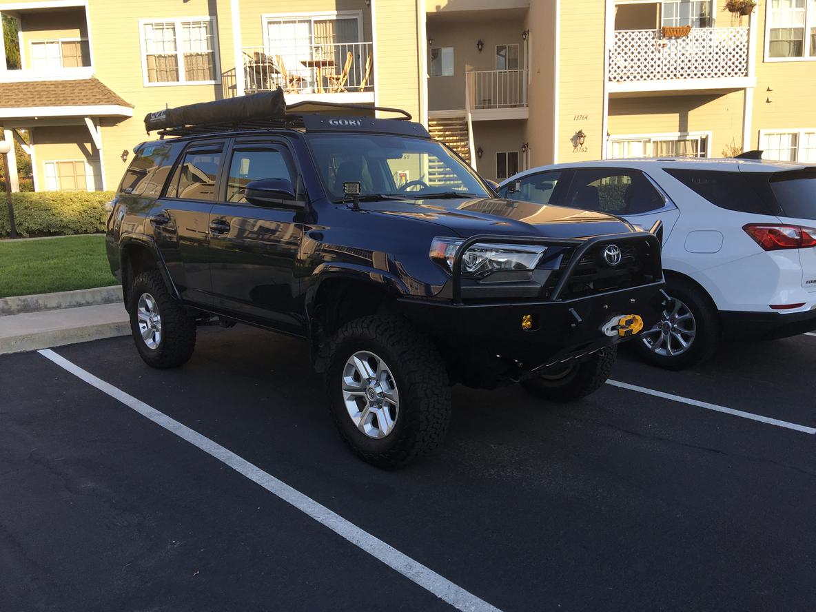

I've been running the 2.5" coil overs with remote reservoirs and the upgraded 700 lbs coils in the front and the 2.5" with remote reservoirs in the rear with the heavy duty OME springs. The nose dive isn't noticedable unless you have to slam on your breaks (I drive the 15 and 5 in San Diego daily...it happens a lot).
I also have the shrockworks front bumper with full bull bar and a Smittybilt X20 Gen 2 10k synthetic line winch with a Factor 55 Ultra hook (yellow). The weight of the bumper and winch make the from end lower by maybe. 1/4". It's awesome. I have been off roading with my set up for the last three months in Anza Borrego and Corral Canyon here in San Diego. Lots of fast runs, washboard terrain, rocks trails, open road. You'll be very please with a Kingns set up.

That is quite a bit in the front for having the coil adjusted all the way out. I'd be hoping for 2", 2.5" is a little too much, I'll end up with reverse rake when loaded....hmmm
