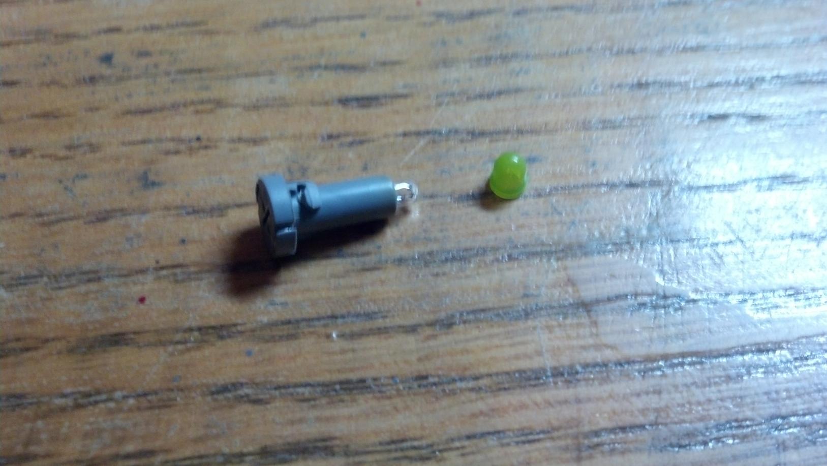

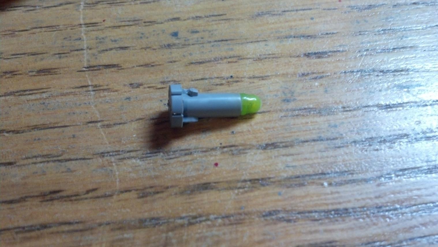

Does anyone know what is the point of this green rubber cap. This is the bulb that goes into the HVAC dials.
