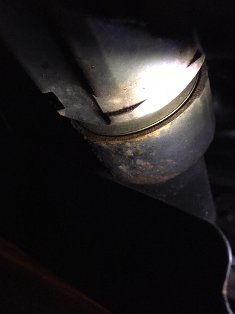

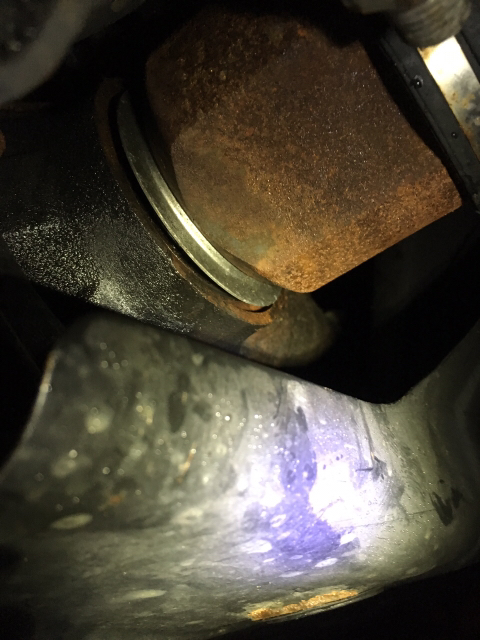

Finally took a pic, driver side has/had leak compared to dry passenger side. $16 for the seal at my local dealer. Just trying to figure out if I have time to do the work or let my mechanic do it.
Driver side
Passenger side
Talked to a local mechanic, they said the bearing probably also needs to be replaced. Cost $220
Am I missing something? Does that sound accurate?

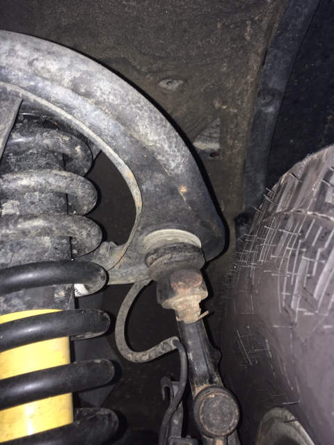

i had the same problem but for me it was making left turns. It turns out that it was my upper control arm, it seemed fine but there was a small rip, i didnt pay no mind to it but luckily i changed my upper control arms with SPC ones. When i took it out, the ball joint on the pass side was toast. it was rusted inside and it was dangling.
Ok, let's go back to post#2, do you see any spot that your tire is rubbing during your turn?

There's a bearing inside the front diff after the Oil Seal.
It doesn't look like it's not an issue with my UCA, and I didn't see any rubbing marks from the tire.
I'm familiar myself with the beep and hard turns, usually you have a scrape with it. I'm not seeing a scuffmark on the UCA like I have. I would inspect inner wheel well all around for scuff marks. I also get them when doing turns, if I hit RR tracks, some times painted lines on the roads, will cause the same effects.
Don't believe wheel bearings or Diff needle bearings will cause this, haven't heard of it. Nor Diff bearings creating the leak you have.
Needle bearings usually create by what I have read from others, a vibration while driving, similar to wheel bearings when turning.
Your tires don't look too large, and not sure of your lift. For shits and giggles, check your passenger frame for a scuff mark, rear side of wheel where it turns into the frame making a right turn.
