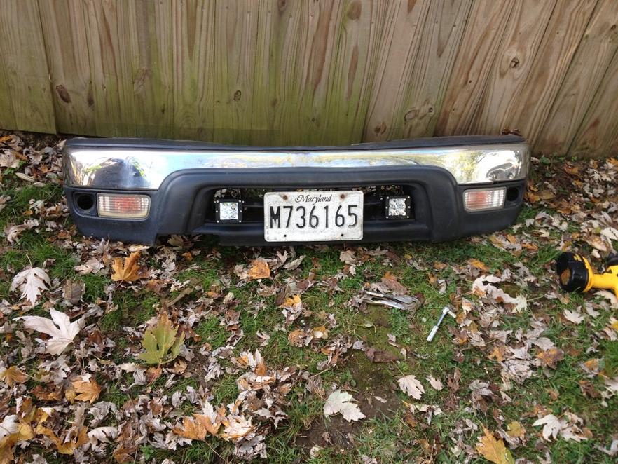

I mounted my dually's in my bumper. I took a sawsaw cut out some of the lower valance. Then drilled two holes into the metal on the bumper( on the inner side of the lip) to make a solid bolt on install.

Hows the out put on it at night? would you have any night shots of it?

Mine aren't Rigids, but are the same 2x2 design. My 98 had the "port side" fog lights added and I just trimmed the factory bracket and cut the ends off and bolted them up. Fit perfectly. Lemmie see if I can find you some pictures.
Introducing my 98 4Runner DD. - Page 2
Bottom of page 2 is finished install. About half way down page 3 are a couple of installation pictures.
