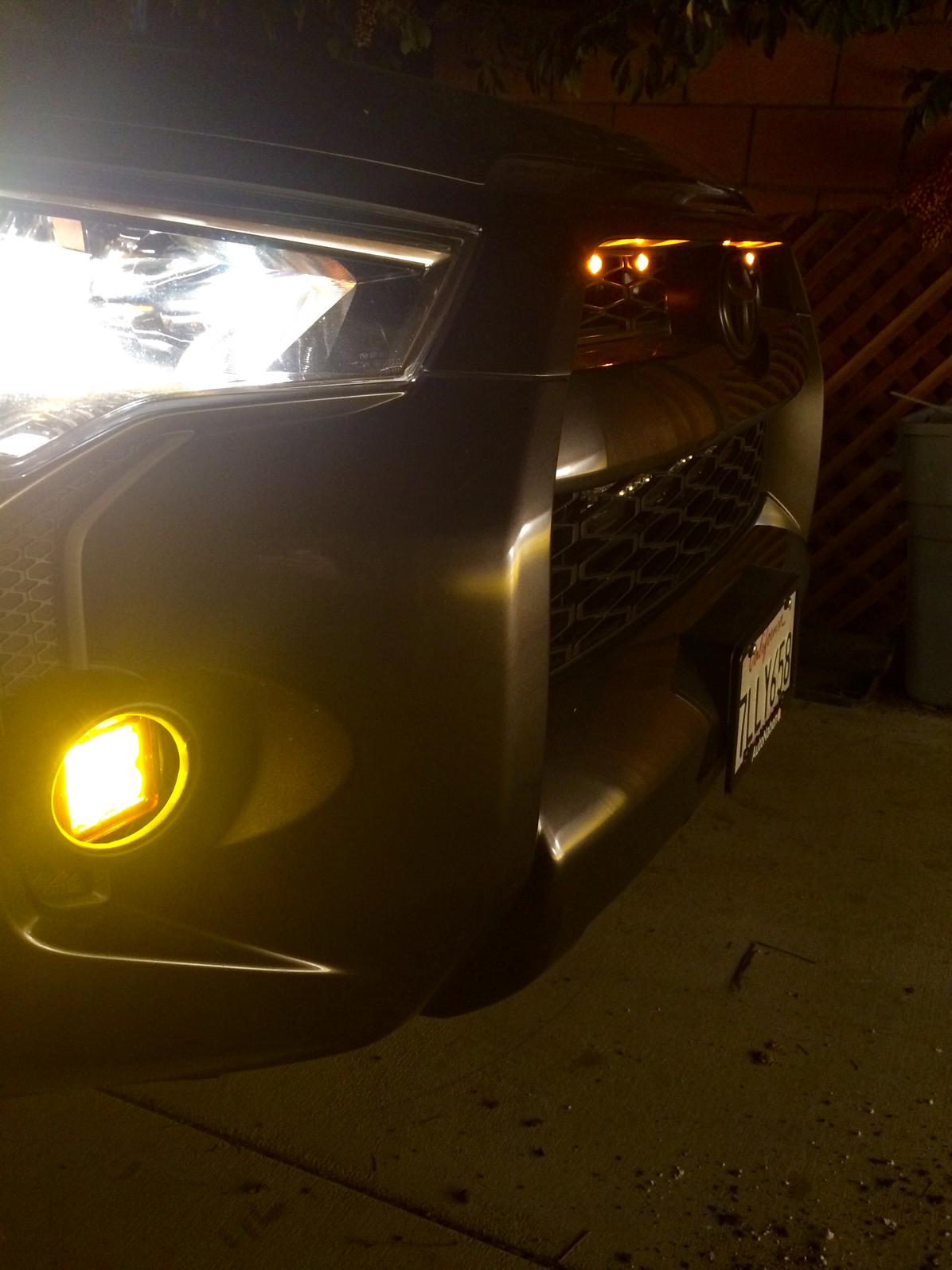

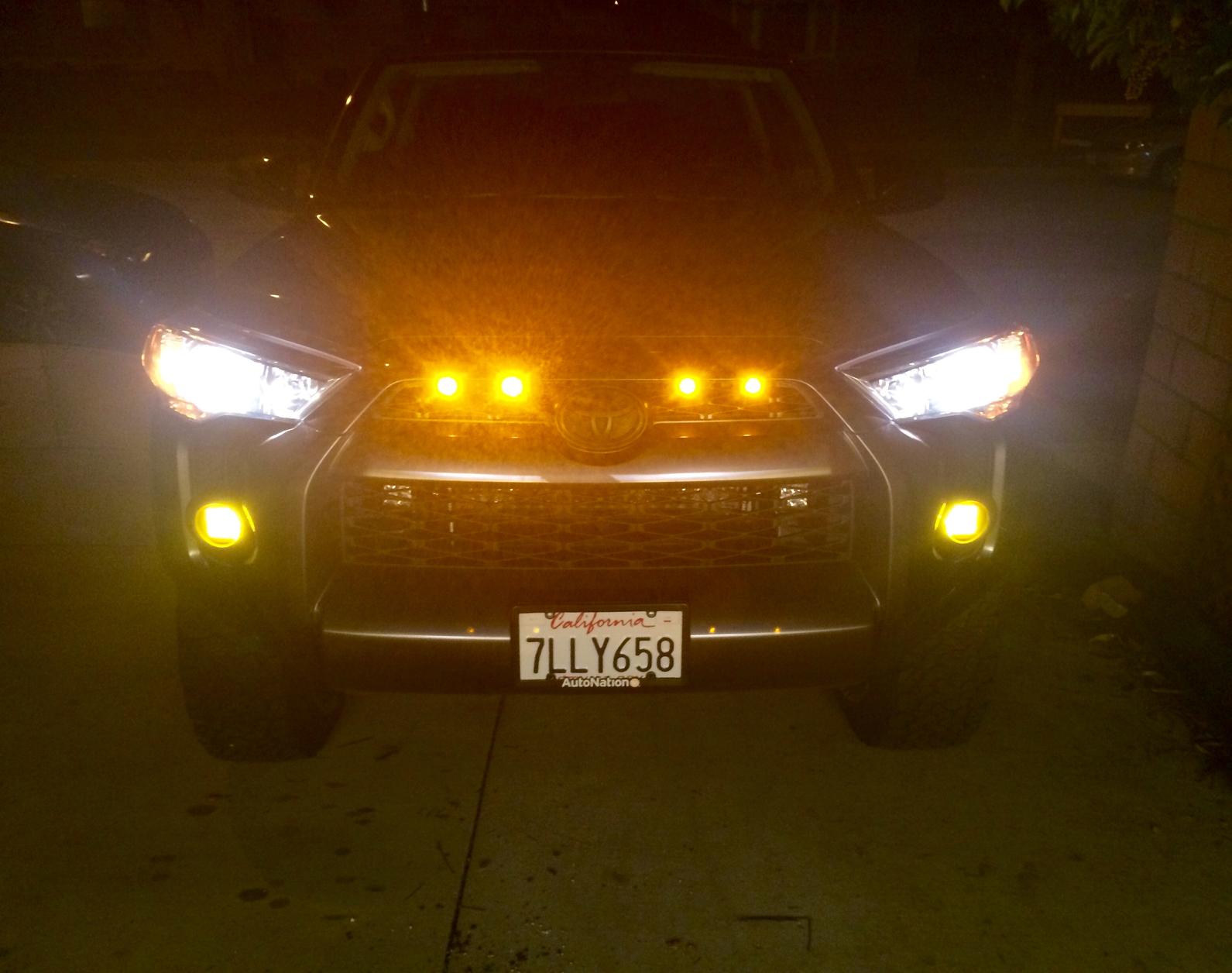

I'm running these and I love them! I added the amber covers, which do block a good amount of light, but they're still plenty bright.
I wasn't able to buy the adapter plugs from TAP, so I just cut the factory fog wires and added deutsh connectors so the Rigids can just plug right in. Works great with the Independent Fog-light mod!
Mind posting a pic with the amber covers on?
The only downside with using the covers is that you have to install the covers BEFORE you mount them to the adapter brackets. So you cant really remove them unless you want to unscrew everything.
Also, the inner edge of the factory fog plastic had to be shaved down a little to allow adjustment with the amber covers on. The covers add about 1/4" to the face of the lights, causing it to interfere with the plastic shroud. Pretty easy fix, just added another step to the install.
