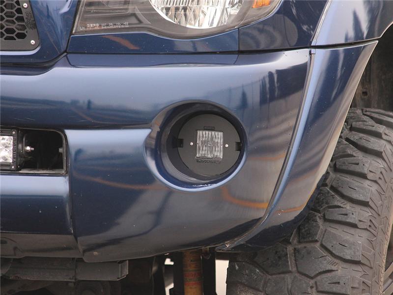

The Fog light mounts from Rigid replace your entire factory fog system. There is a face plate and a mounting bracket included. You remove the Rigid Dually bracket that comes standard and attach this to the two side bolts, and then bolt the face plate to the cover of the Rigid dually. Any light with the dimensions of the dually will work, but of all the 3x3 cubes out there Rigid is by far the best.
g-80579.aspx
You can see on this similar tacoma mount how the light attaches.
