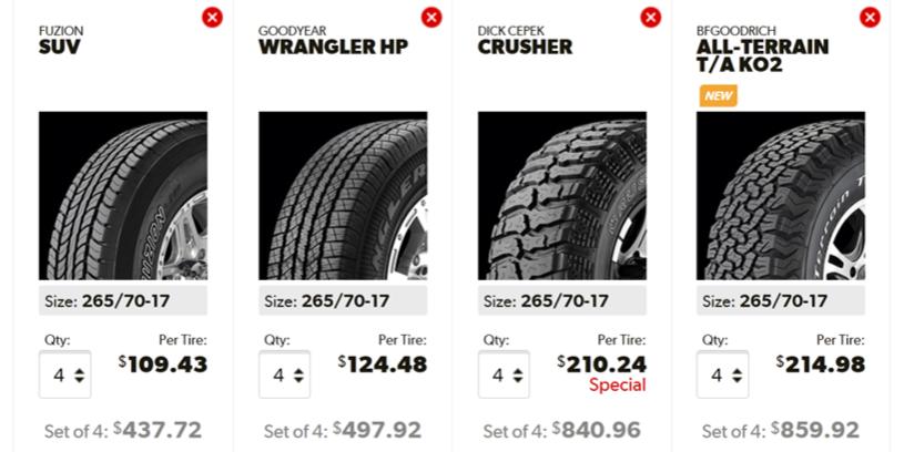

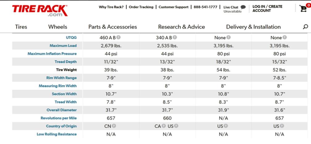

First, the guy said "all your questions" which is quite different than "all questions."
Even though your opinion of me is not the highest I don't want you going through life thinking something is true when it is not. So for your edification I spent 30 seconds and went to Tire Rack, picked out four random tires of differing treads in the stock 4Runner size and compared them. You will see that IT DOES NOT MATTER what type of tread the tire has in determining what the O.D. will be. There is no rhyme or reason! You can be rubbing with an All Season tire and put an aggressive tread tire on there and not rub. If you pick four different tires from four different manufacturers you will get different results! What really boggles the mind is a specific tire will be larger than the others in one size (265) and that same tire will be smaller than the others in a 285 size! That's why the guide is so general and people need to do their own research instead of reading posts like yours that will steer them in the wrong direction. Look at the pics below.
