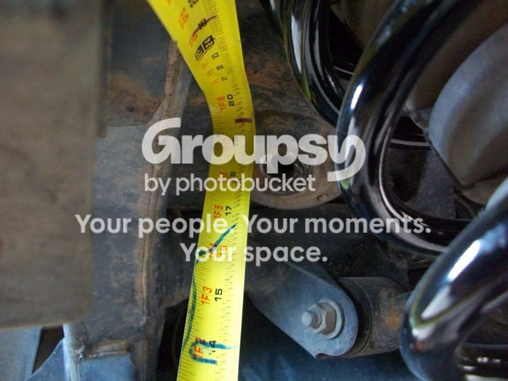

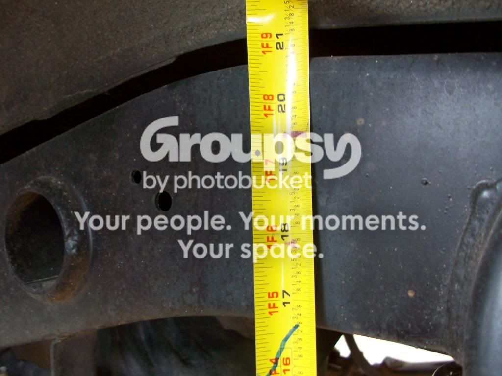

First, I had to measure how high I needed to mount the shock. Yes, these measurements were taken with the axle & suspension at ride height.

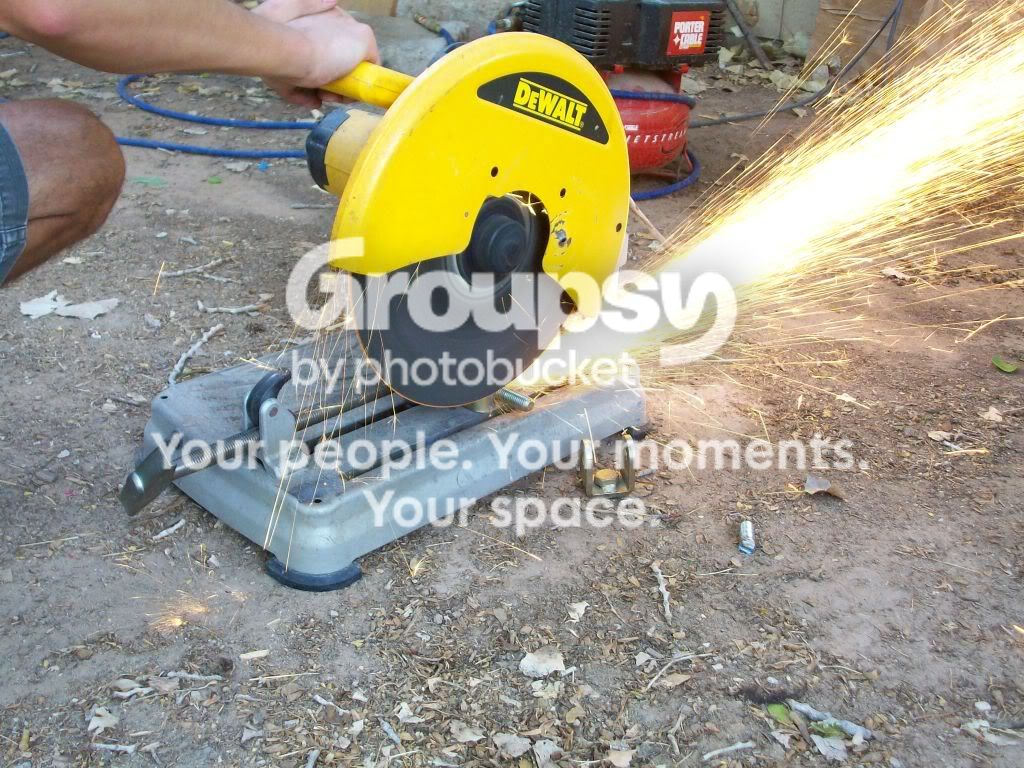

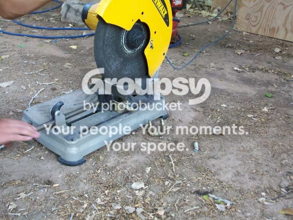

Then I cut the bolts off the old adapter:

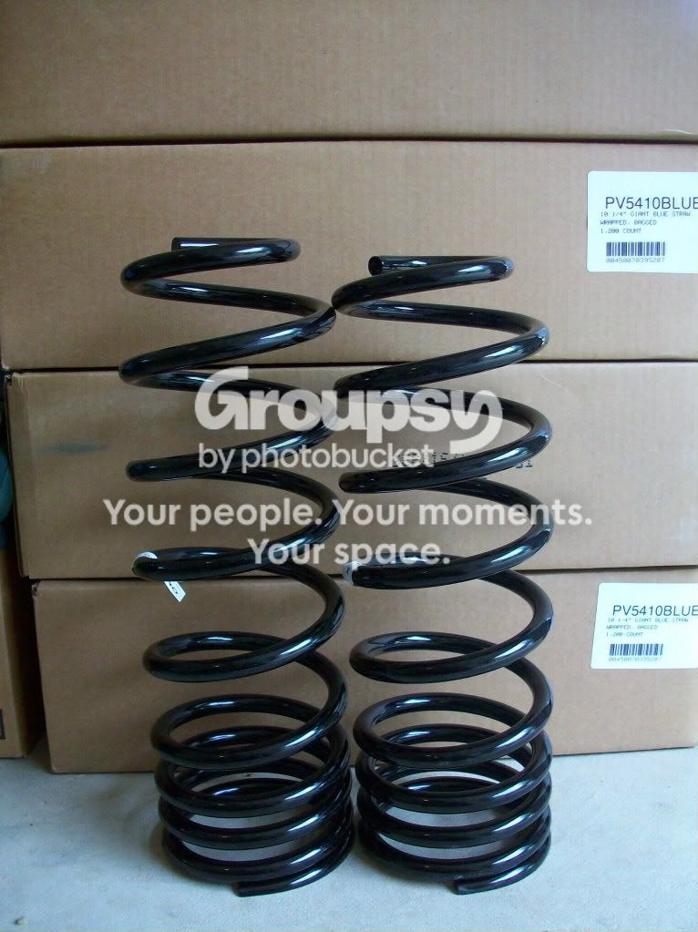

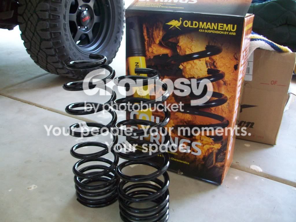

Also, while I was in Denver last weekend, I stopped by the Toytec customer day. They were having a big discount on parts so I picked up a set of 890 rear coils.
I know what you are thinking, ANOTHER SET OF REAR COILS??? Yup.
Here's why:
1) my first set, the OME 891's, were way too stiff. They are meant for extra loads, which I don't carry.
2) Moved up to LC80 8 wraps. While these rode great, I didn't like the 4-4.5" of lift I got from them.
3) I wanted to get right at 3" of lift with a firm but forgiving ride quality. Enter the OME 890.
110_1027.jpg~original

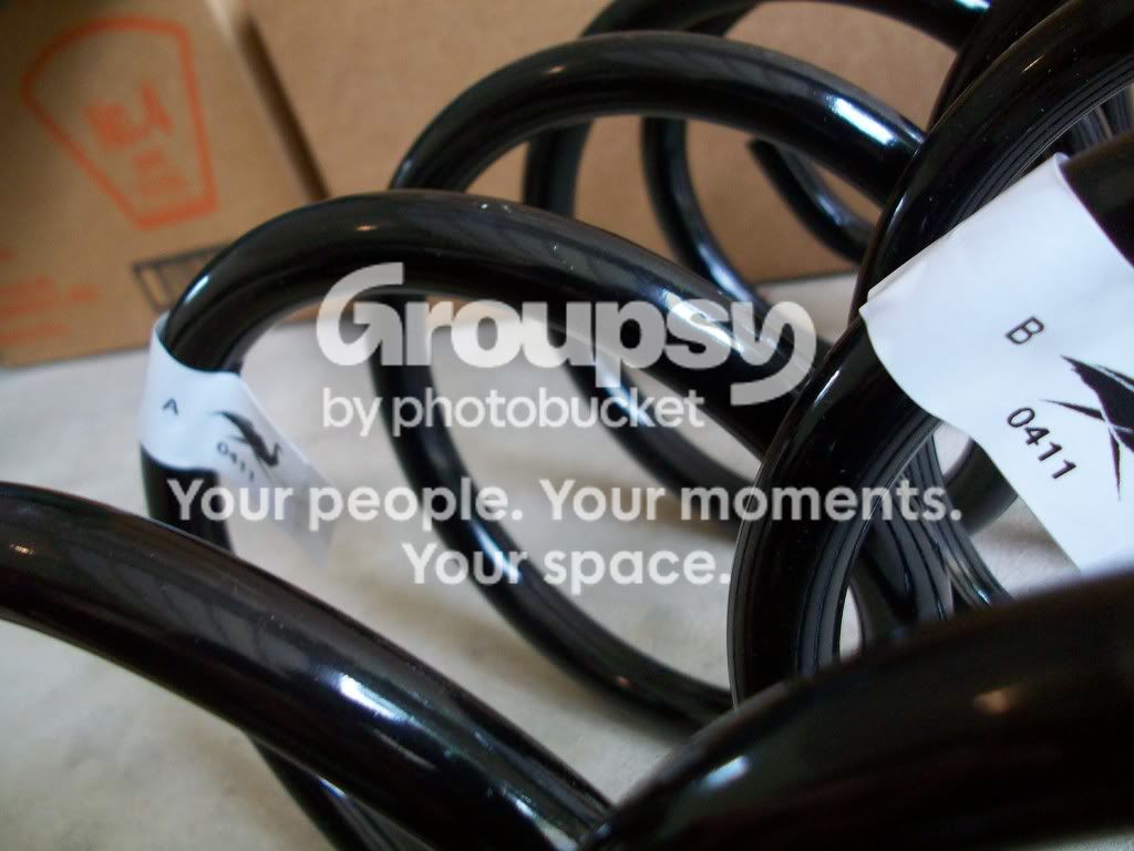

I noticed that one coil was marked with "A" while the other was "B". I bet one was meant for the driver's side.
110_1030.jpg~original
Putting them next to each other, you can see that the coil marked "A" is about 1/2" higher than the other:
That means that the "A" coil is for the driver's side as that side has much more weight. (fuel tank, battery, driver)

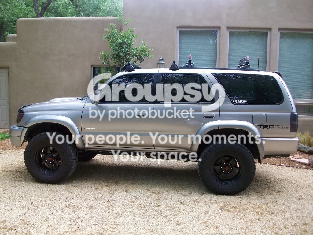

Side shot with OME 890:
110_1063.jpg~original
