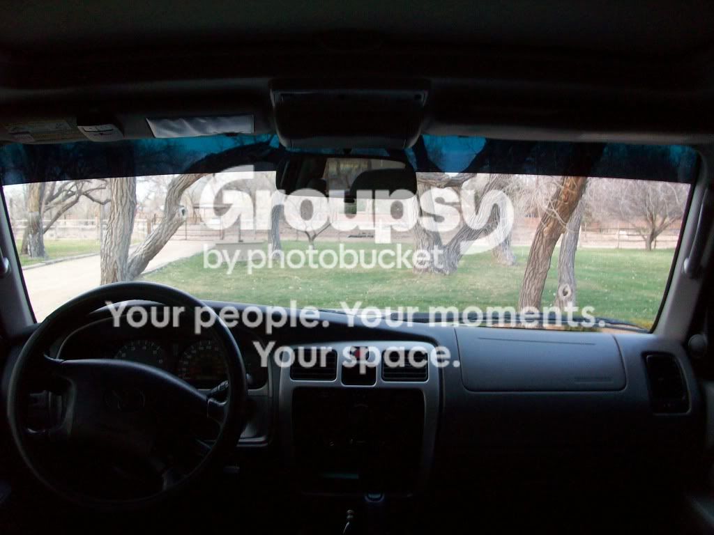

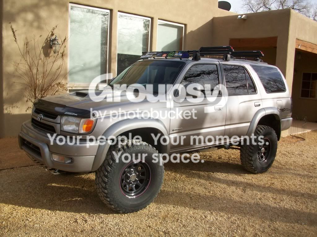

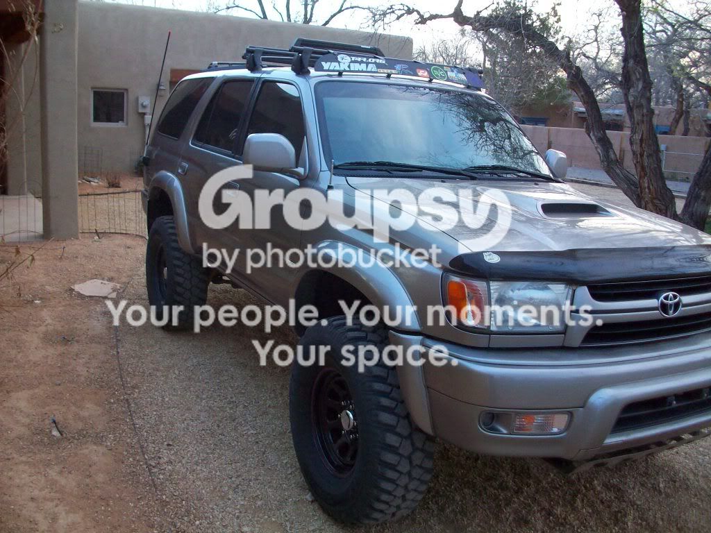

Tint
So far its just 20% on the fronts and a 4" 5% banner. Got it done at the same place that did my windshield replacement, so they gave me a discount.
$74
And in case you missed it earlier, I removed the decals. So much better.
Ignore the glare and reflections.

Matches up pretty nicely.
100_0755.jpg~original
Windshield banner from the inside, at about eye level.
100_0766.jpg~original
I'm VERY glad I asked for a 4" banner instead of a 6" banner. I don't think I could stand the banner being any lower than it is right now.
