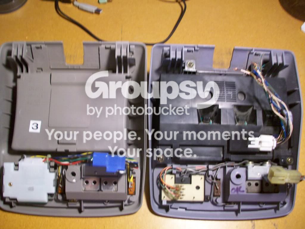

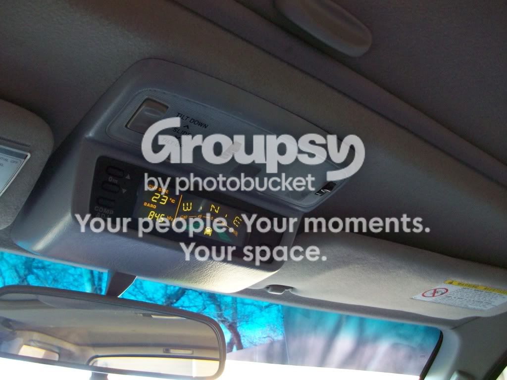

(Left) is the stock 99+ overhead unit w/sunglasses holder. Notice the blue 99+ plug.
(Right) is the field monitor, with the 96-98 style plug.
100_0836.jpg~original
Photo from the JDMNZ website:
LN-185-Compass-009.jpg~original

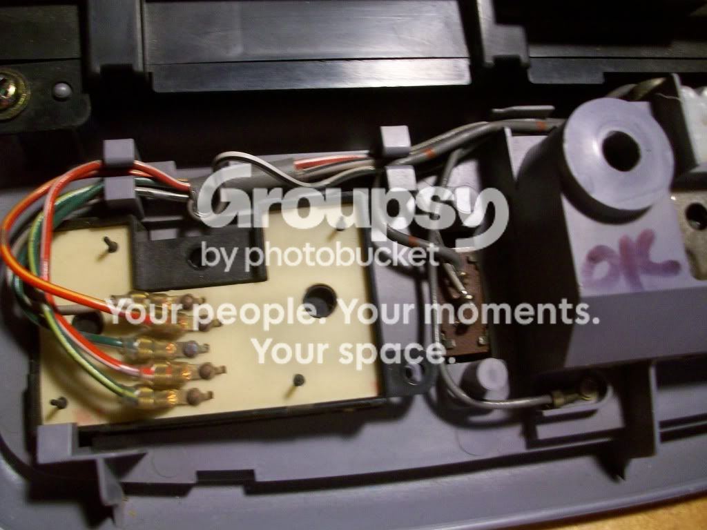

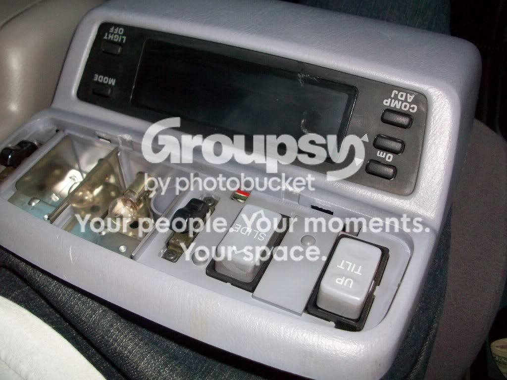

Close-ups of FMU controls:
100_0837.jpg~original
100_0839.jpg~original

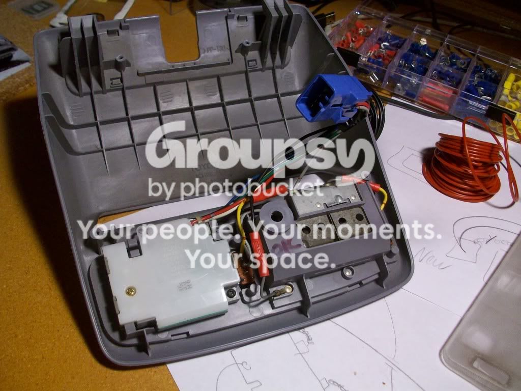

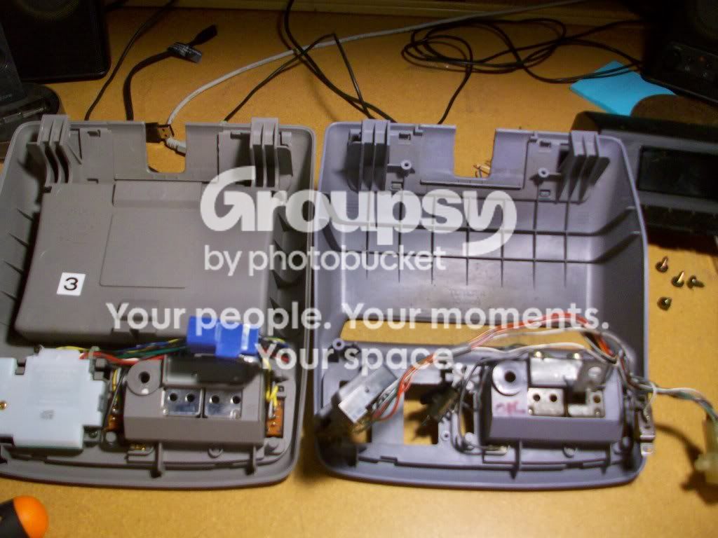

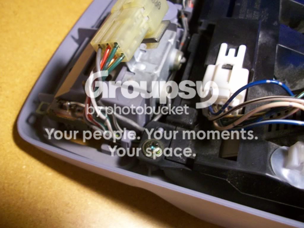

Removing old controls from FMU:
100_0840.jpg~original
Controls swapped over:
I swapped EVERYTHING over, sunroof controls, maplight buttons, plug, etc.. The the only thing I didn't swap was the lights themselves. See the wire connectors where I connected the ground and power for each individual light..
100_0841.jpg~original

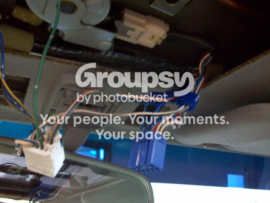

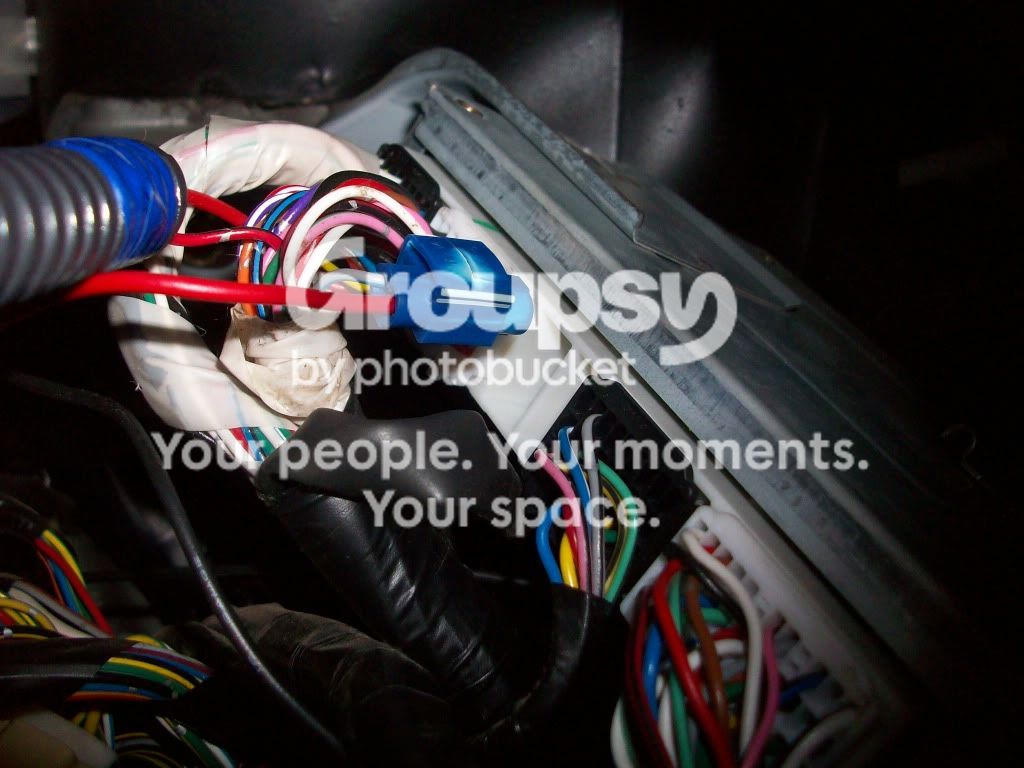

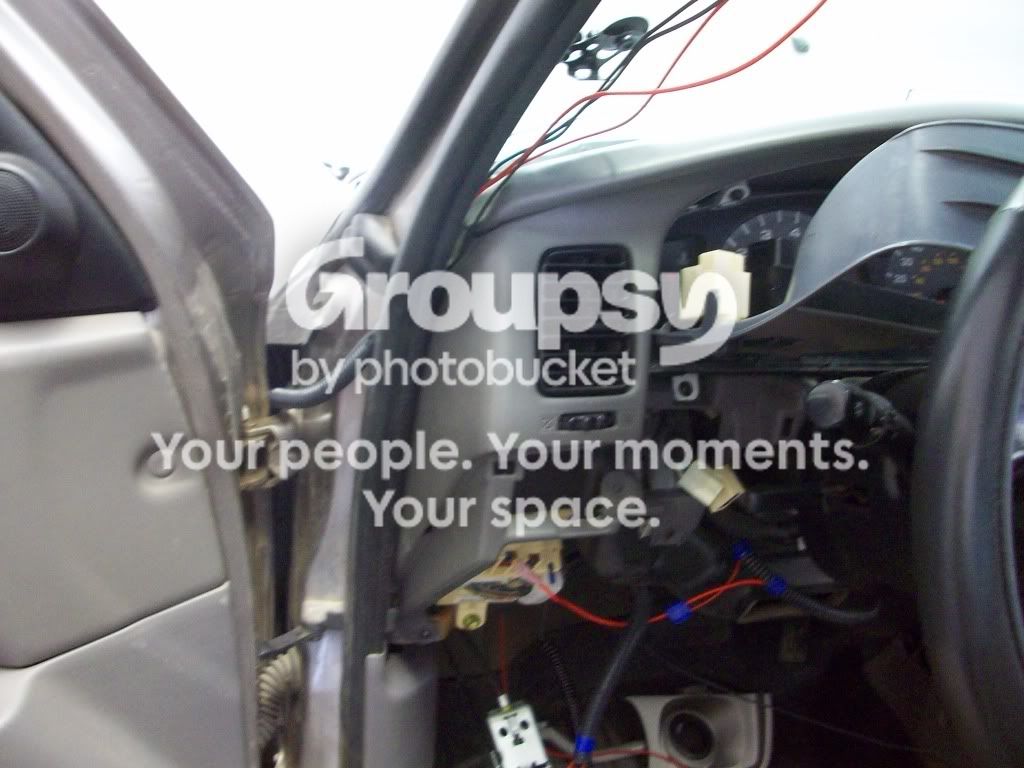

Full-time 12V, ignition 12V, and ground all tapped according to above directions:
100_0849.jpg~original

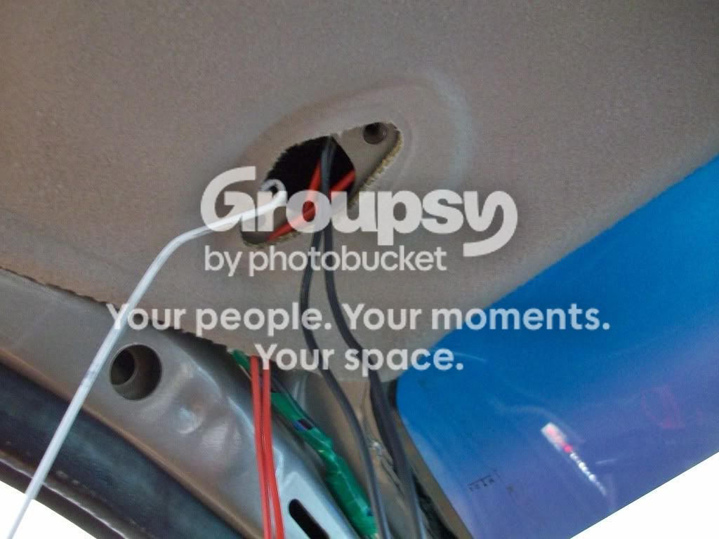

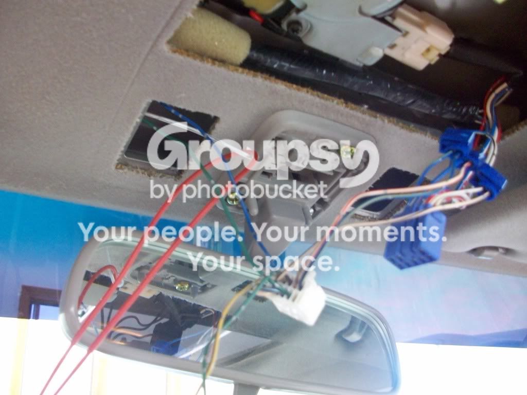

Remove sun visor and A-pillar, then use a wire hangar to fish the wire under the headliner. :fishing:
100_0854.jpg~original
100_0851.jpg~original

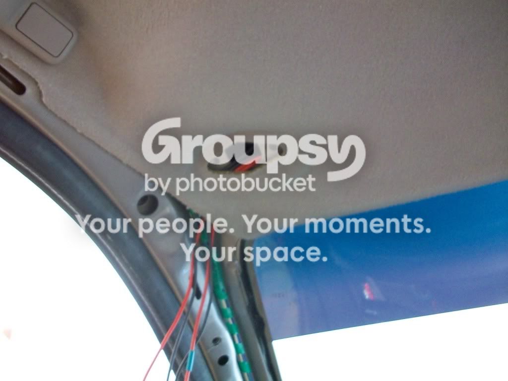

Then put the wire under the small section of headliner and run them down the A-pillar:
100_0855.jpg~original

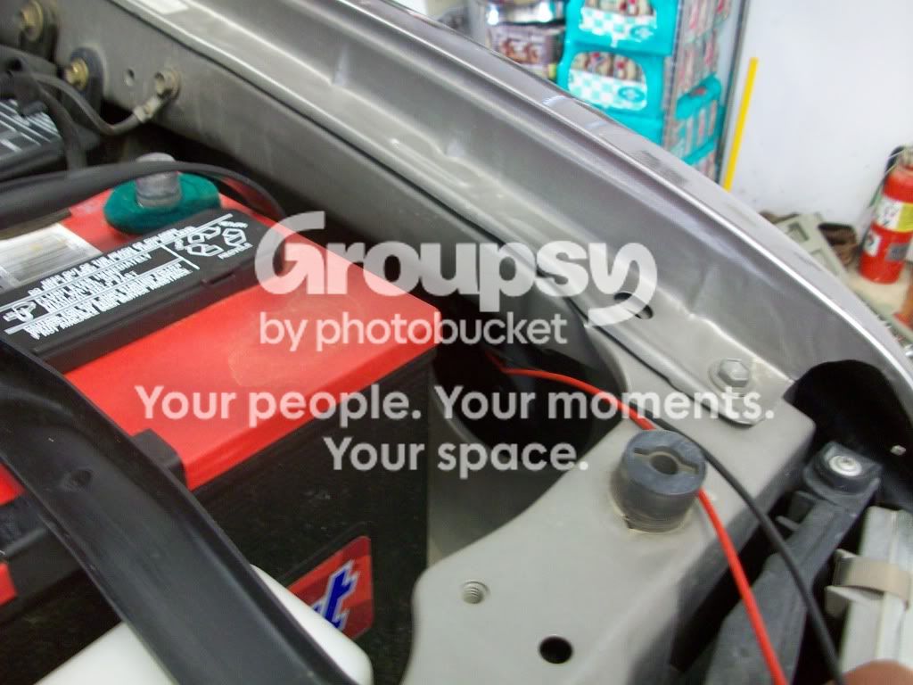

For the temp sensor wires, I ran them under the door weather-strip and behind the fender.
(for the light-dimmer wire I tapped into the solid green wire coming out of the dash light dimmer knob)
100_0860.jpg~original

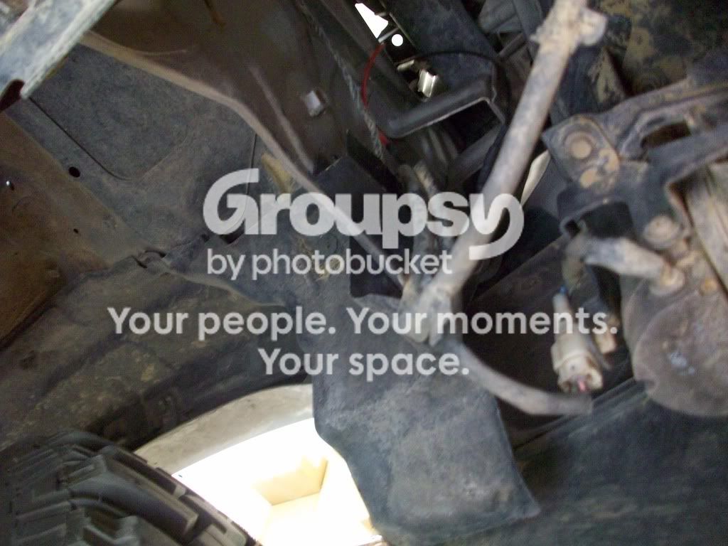

Then out from the fender through the big hole behind the headlights and down behind the bumper.
100_0858.jpg~original
I found a pre-made spot for the tab on the temp sensor to snap onto. It was right behind the driver's side fog light.
100_0862.jpg~original

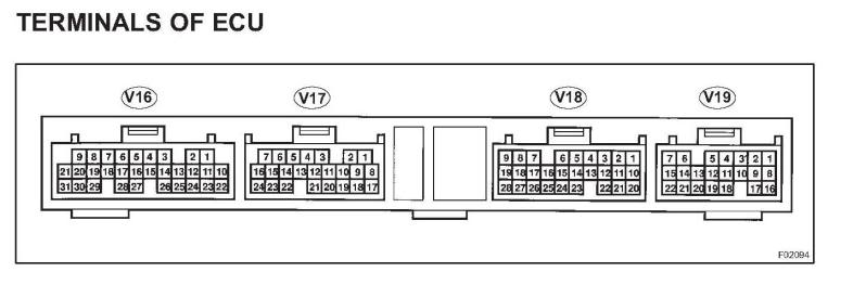

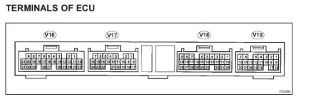

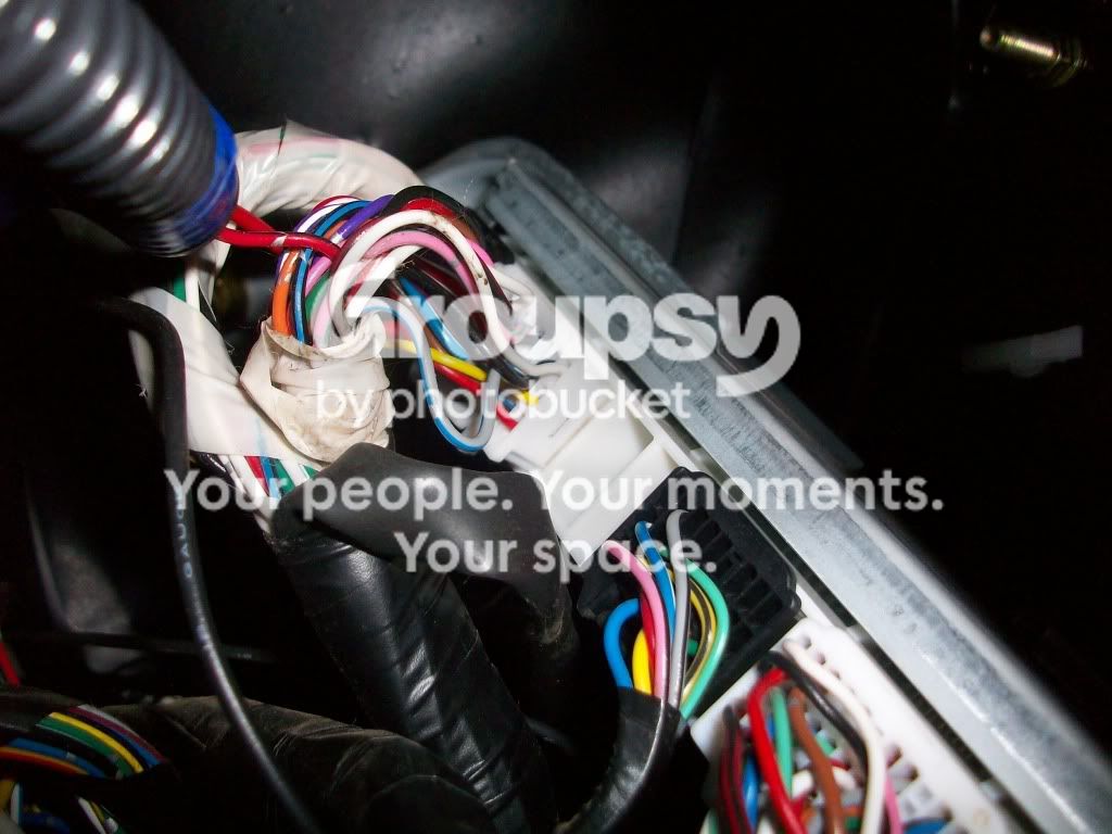

Abs/ speed sensor wiring
Here is a diagram of the back of the ABS unit. For 99+ 4runners it is located under the driver's dash. The Blue/Grey speed sensor wire is in the V18 plug, I'm pretty sure it was the slot number 17 on that plug.
Just remember that it is the only Blue/Grey wire on the entire ABS unit..
Diagram courtesy of Rock Slide.
Blue/Grey speed sensor wire located. (The other red wires are for the Andymod, ignore those)
100_0866.jpg~original

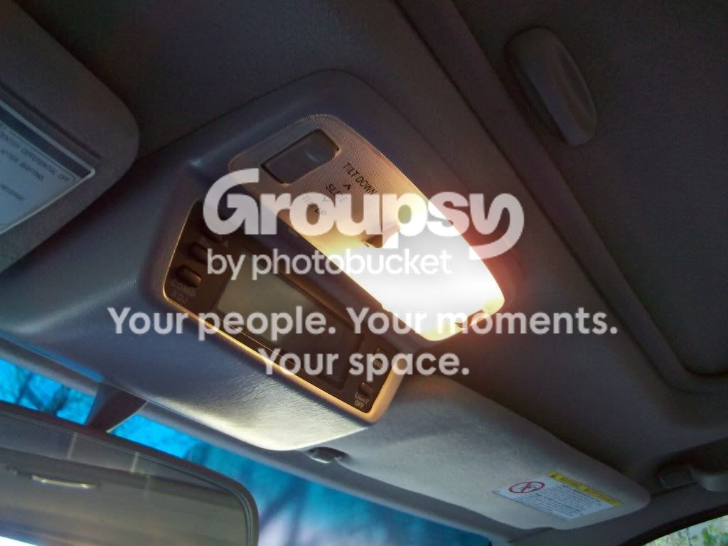

All done! :banana:
100_0871.jpg~original

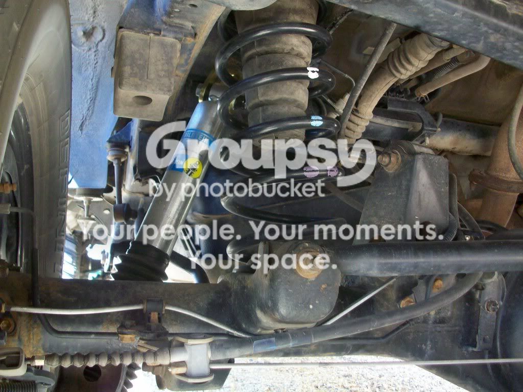

Oh and I got my shocks on..
Also reconnected my front&rear sway bars.
Cost analysis:
$200 New Bilstein 5125 w/ adapter
-90 - Sell old OME 60027
$110
100_0869.jpg~original
I LOVE the ride! so much smoother. Feels so 'Cadillac' now. :pimp:

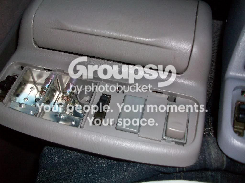

He asked if the larger (5x5) would fit in the 4runner dome lights. Well, here is a few shots to judge for yourself. The 5x5 will FOR SURE fit in the rear dome light, and it will FOR SURE fit in the passenger area light. Plenty of room on in both light housings.
For the map lights, I have not replaced those, but I don't even think the 4x4 board will fit in those..
Here are a few pictures.
Rear Cargo area light:
100_0874.jpg~original
100_0875.jpg~original
Passenger area light:
100_0877.jpg~original
100_0879.jpg~original
Hope that helps answer your question. :bigok:
